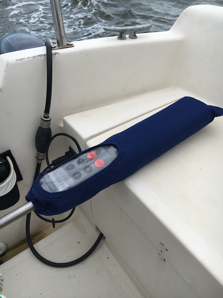

A thread a few months ago reminded me I could use a cover to protect my tiller auto pilot from spray and rain so I studied up a bit on home sewing machines suitable for sewing Sunbrella. Last month I picked up an early 60's Kenmore which reportedly met the requirements of all metal parts, Made in Japan and 1 amp motor needed to do the sewing.
I then made a mock up using some old denim and ordered some material from Sailrite.
I sewed up the finished cover using Sunbrella and 20 mil clear vinyl for the window.

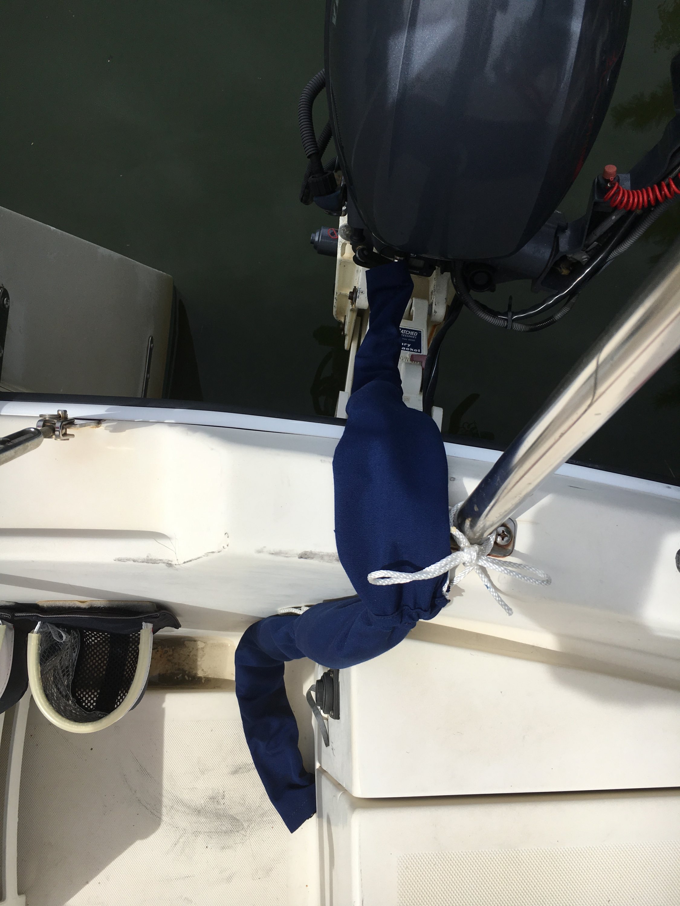

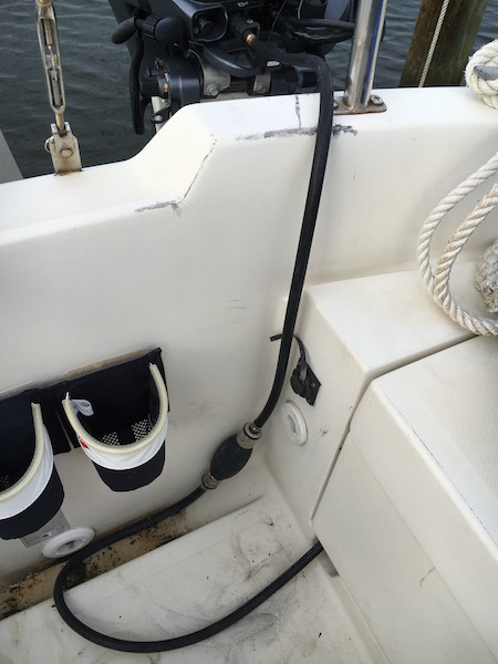

I noticed my OB fuel line was deteriorating and putting black crap on the boat and my hands when I touched it. Making a cover for it sounded like a good idea.
I came up with a Sunbrella snake skin, named because it looked like a snake had eaten a mouse. I put it on a new fuel line and installed.

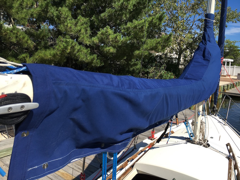

Last week I was at the boat everyday so it was a good opportunity to fix the mainsail cover. I split the spine seam, measured several spots of the properly flaked sail and added an 8" gusset to the cover. I also added to the aft end of the cover, then added a tie and moved/added twist locks.
No more crunching of that crisp new sail.

Very nice mainsail cover. Is that Velcro running the entire edge?

The next time you are on your boat would you take a photo of the mast and zipper on the cover. Love the look and practicality of the cover, thanks.
