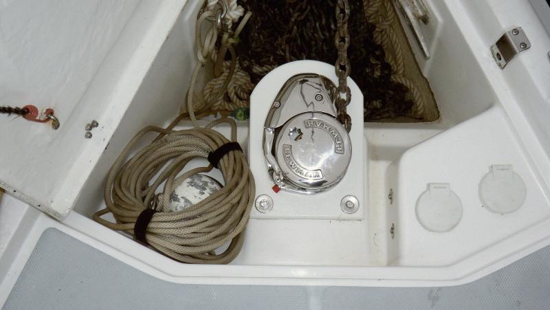

Interesting ................... I didn't know SL had come up with plate arrangement for mounting their windlass on the anchor locker pedestal. Rats, all that design work and here someone had already invented it. I installed a low profile Lewmar V1 to fit under the locker lid.
