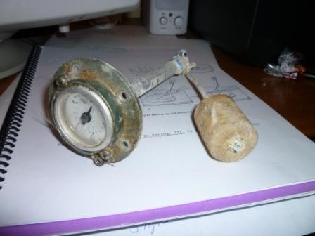

My 25 year old gauge/sending unit has failed, see pic. I am look for a replacement, just a manual ( non-electrical) float gauge. The old one was made by Rochester.
Any suggestions.

Clean it up and replace the float and the removable gauge on top and you should be good to go.

I can't just clean up the old one since the pivot gears have corroded off. I have emails in to Mary's source and Rodchester and I also see that moeller sells/makes swing arm sending units, so I have contacted them.
