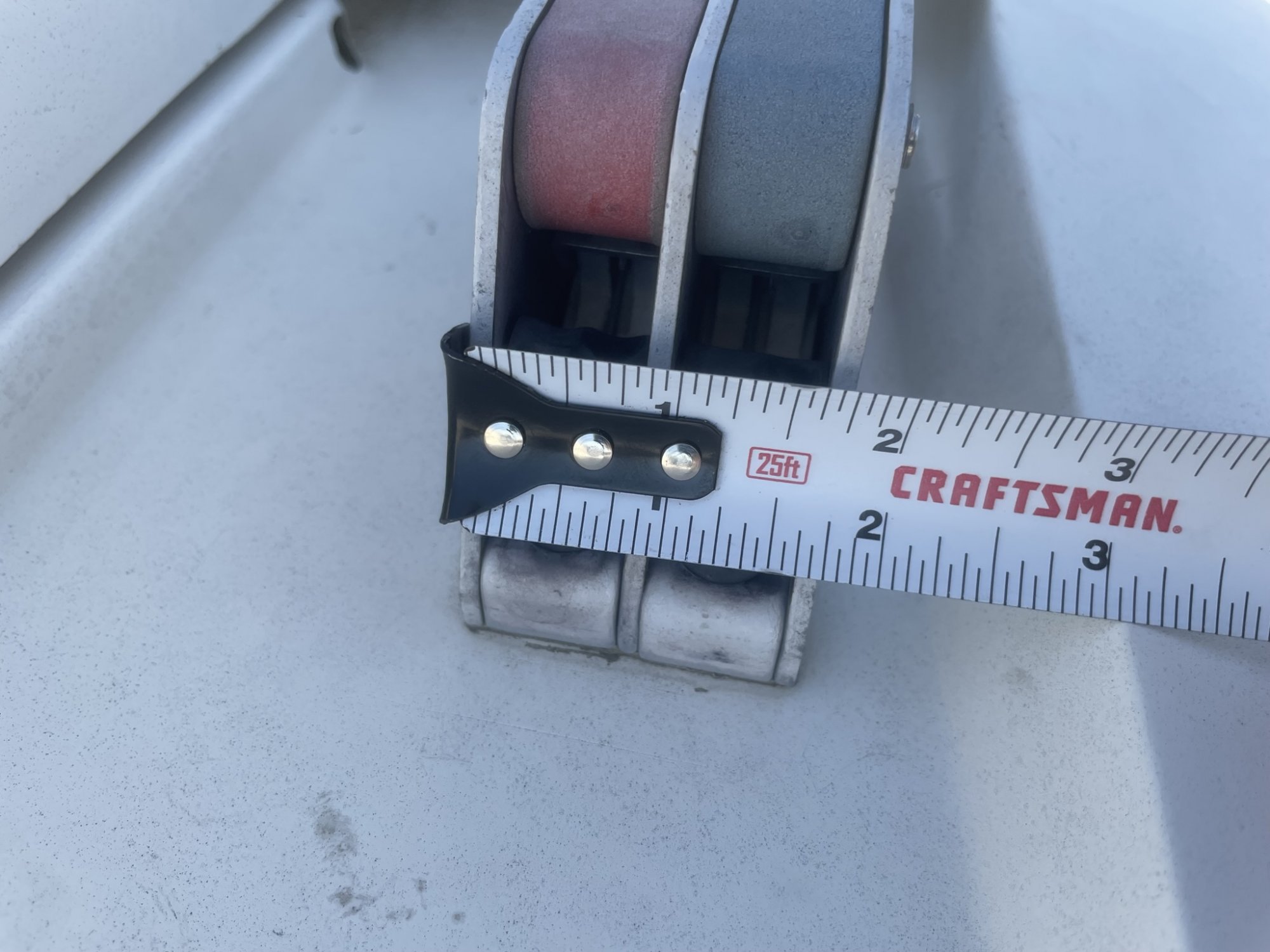

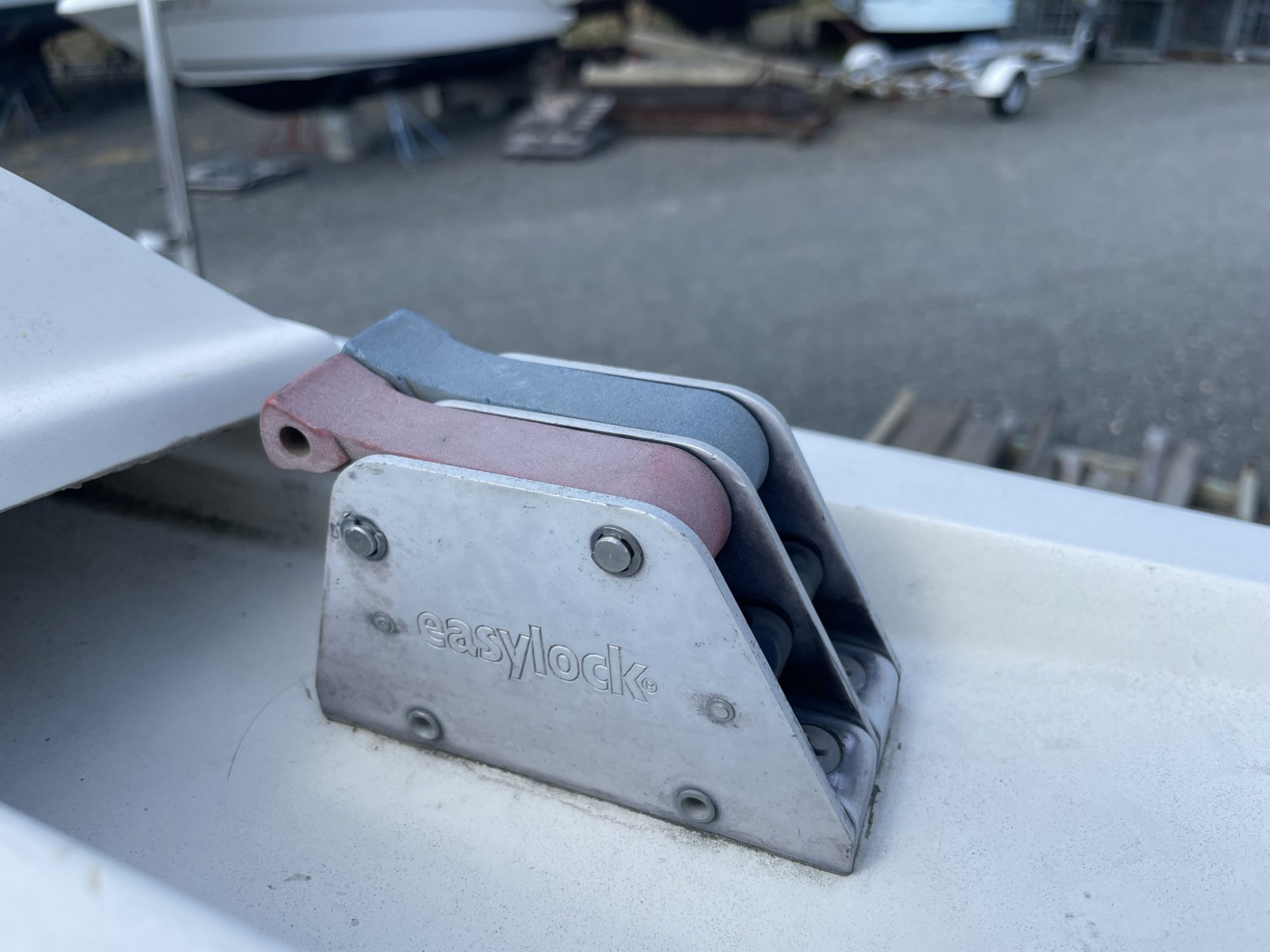

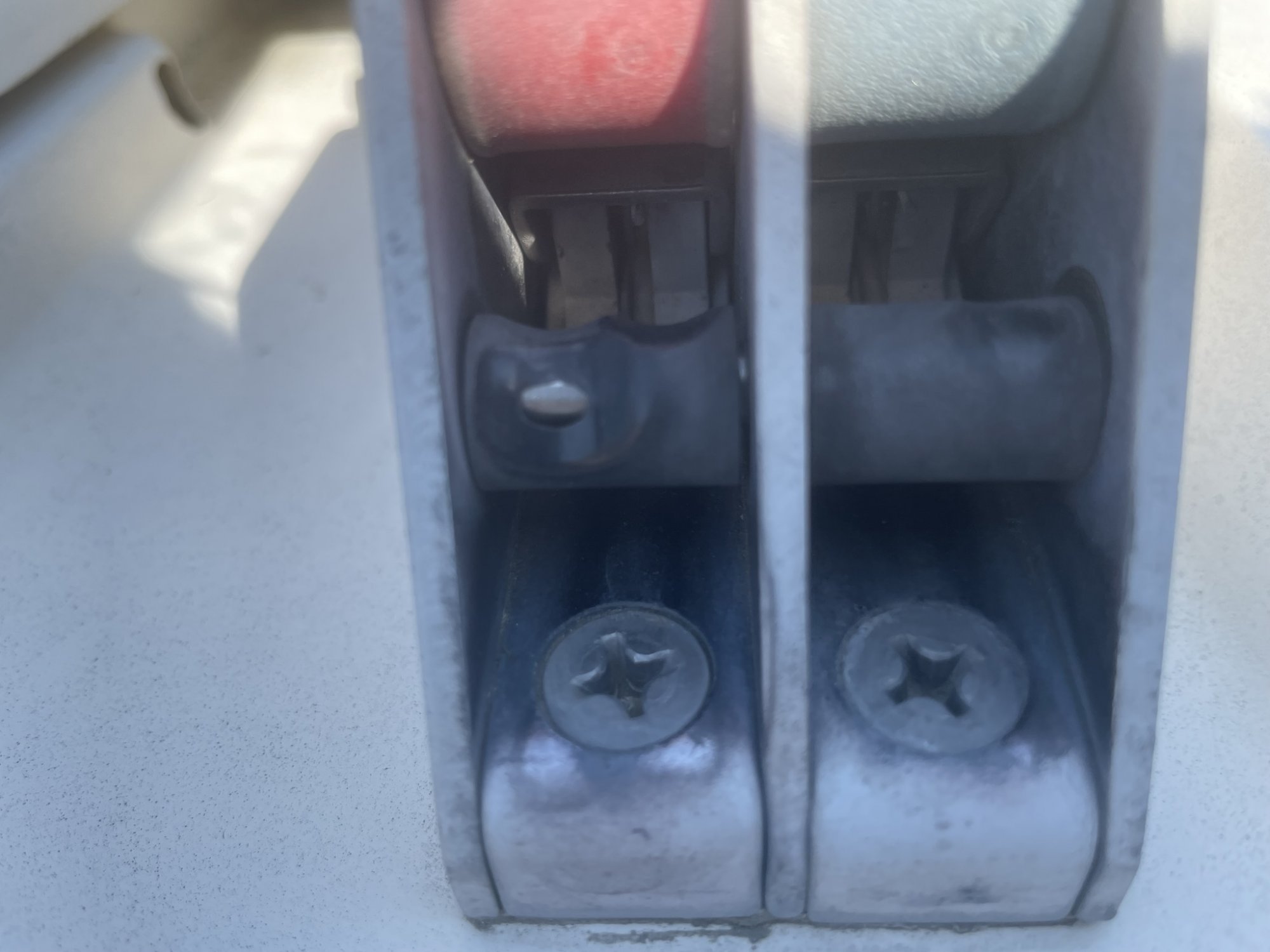

The rollers on my easylock rope clutch from a 1984 Hunter 25.5 are worn through. Can anyone confirm that this is the Easylock 1 - Double: NF 33420-2 from rigrite? Easylock Rope Clutches
If so, I would order 2 Easylock 1 Rollers: NF 33421R.https://www.rigrite.com/Hardware/Rope_Clutches/Easylock_Handles.php
Black Plastic Roller as used (2 per Clutch) in Easylock 1 Rope Clutches.
Has anyone replaced these? The handles have clips but these are fixed differently.

I have a 1984 H27, I had the exact same worn-out rope clutch. Replaced it with a new Spinlock clutch, never regrated it. Much better than the original.

I have the same Easylock clutches. I did replace the rollers but since I had access to a machine shop, I made them myself out of Delrin. Worked good.
