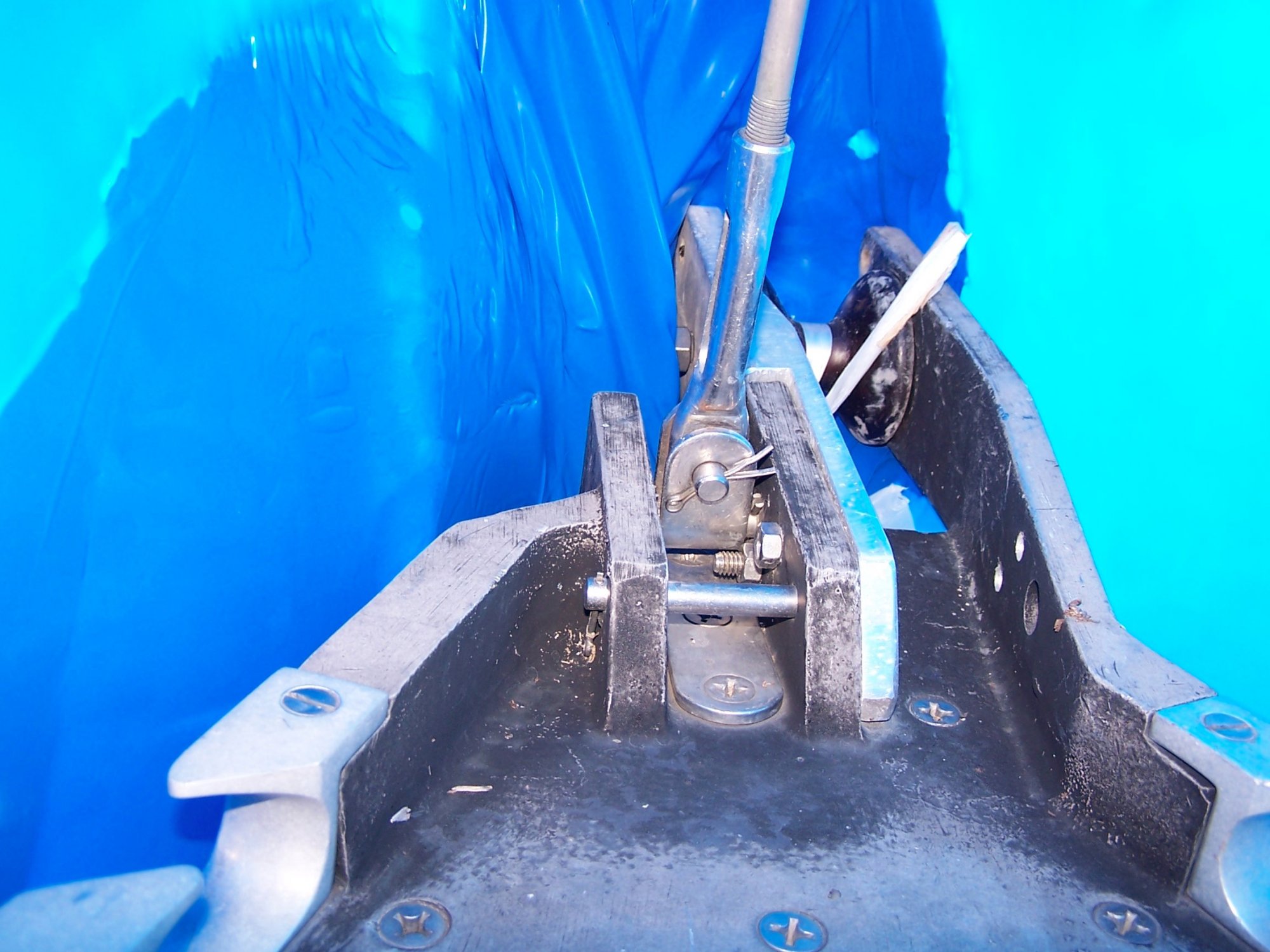

From my research so far. It looks like earlier years were made of cast aluminium. Later they were changed to stainless. I was able to talk with Rudy. (Yes, he is still around.) He has not had a request for the new stainless stem head bow roller shown above for 8 years and he sold the last one. He gave me the name of the company that might have had the blueprint but the company no longer has it. The company that originally made them is out of business.

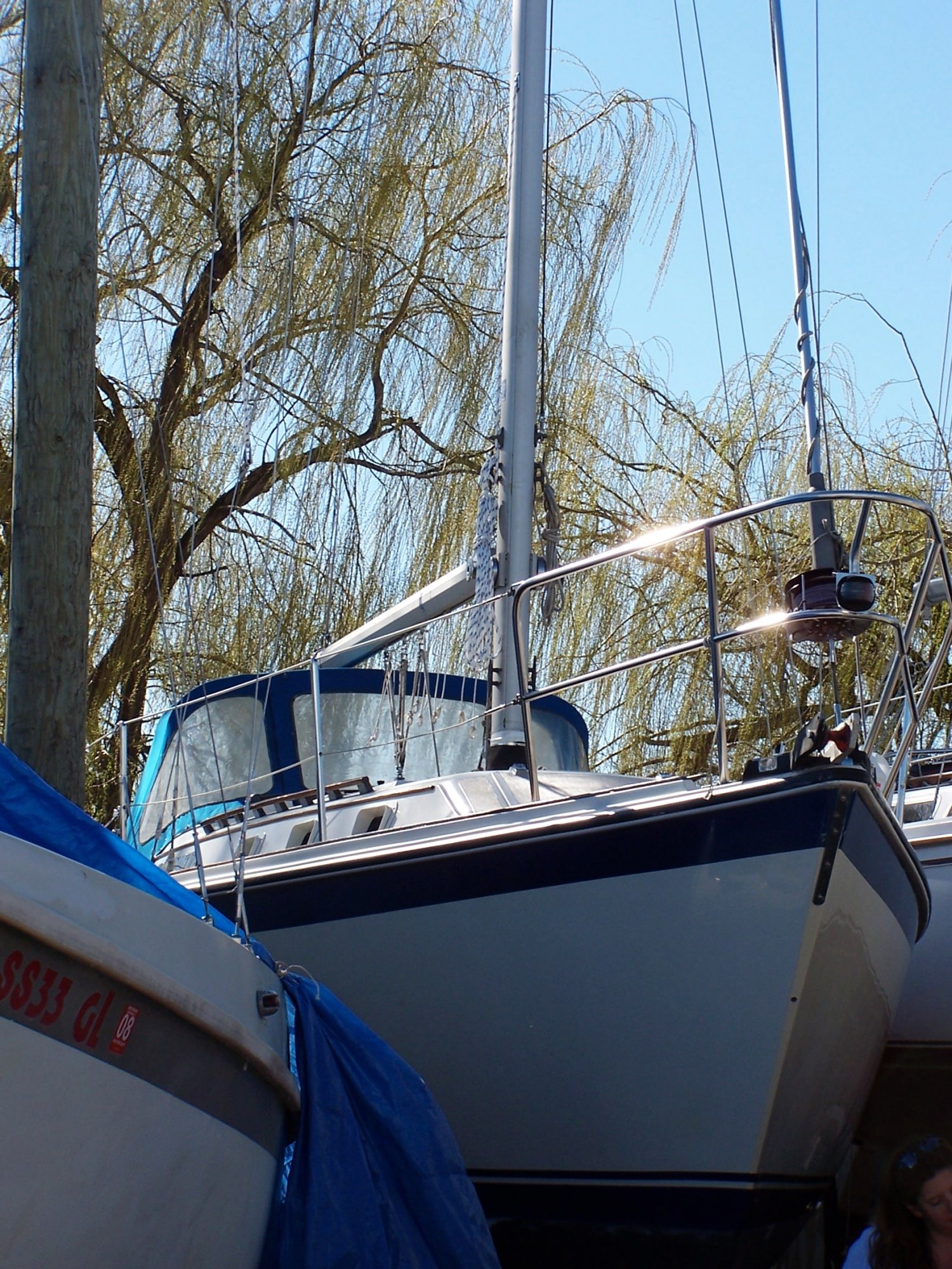

I went to a local marina today to see if I could find another example of the stem head that I need. Almost every sailboat new and old had a single stainless strap that connected to the forestay and roller furling drum. Even a smaller model O'day used a stainless steel strap. I wonder if any of the newer 86 to 89 34/35's used a stainless strap instead of the combination stem head plate and anchor roller? I have a call into Rudy but I have not heard back yet.
Can anyone think of why I wouldn't be able to convert mine over to a SS strap? Much larger Catalina's and Beneteau's have them. What load factors would need to be considered and what thickness of SS would be needed?
Any help on this would be very much appreciated. I'm running out of options.

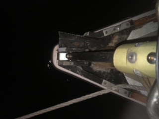

I’m attaching pictures of what I currently have and what I see on other boats.
13,203
From the last photo, it appears there is a SS strap that connects to the forestay and the original roller was cast aluminium. This makes sense because cast aluminum is not that strong and it would put the forestay at risk if the cast aluminum is used to anchor the forestay.
While many of us try to maintain our boats in "factory condition" using only OEM parts, sometimes there are better ways. If this was my boat, I'd consider taking the cast stem head fitting off, check to see that the forestay is attached to a SS strap and that the strap is still in good condition, and then install an aftermarket bow roller.

Yes that is what I am thinking. The cast may be original but I’m not sure. To convert to a ss strap I think I would need to know more about the load requirements it I don’t know how to go about this.

Measure the SS tangs on other similar boats. It will be close enough.

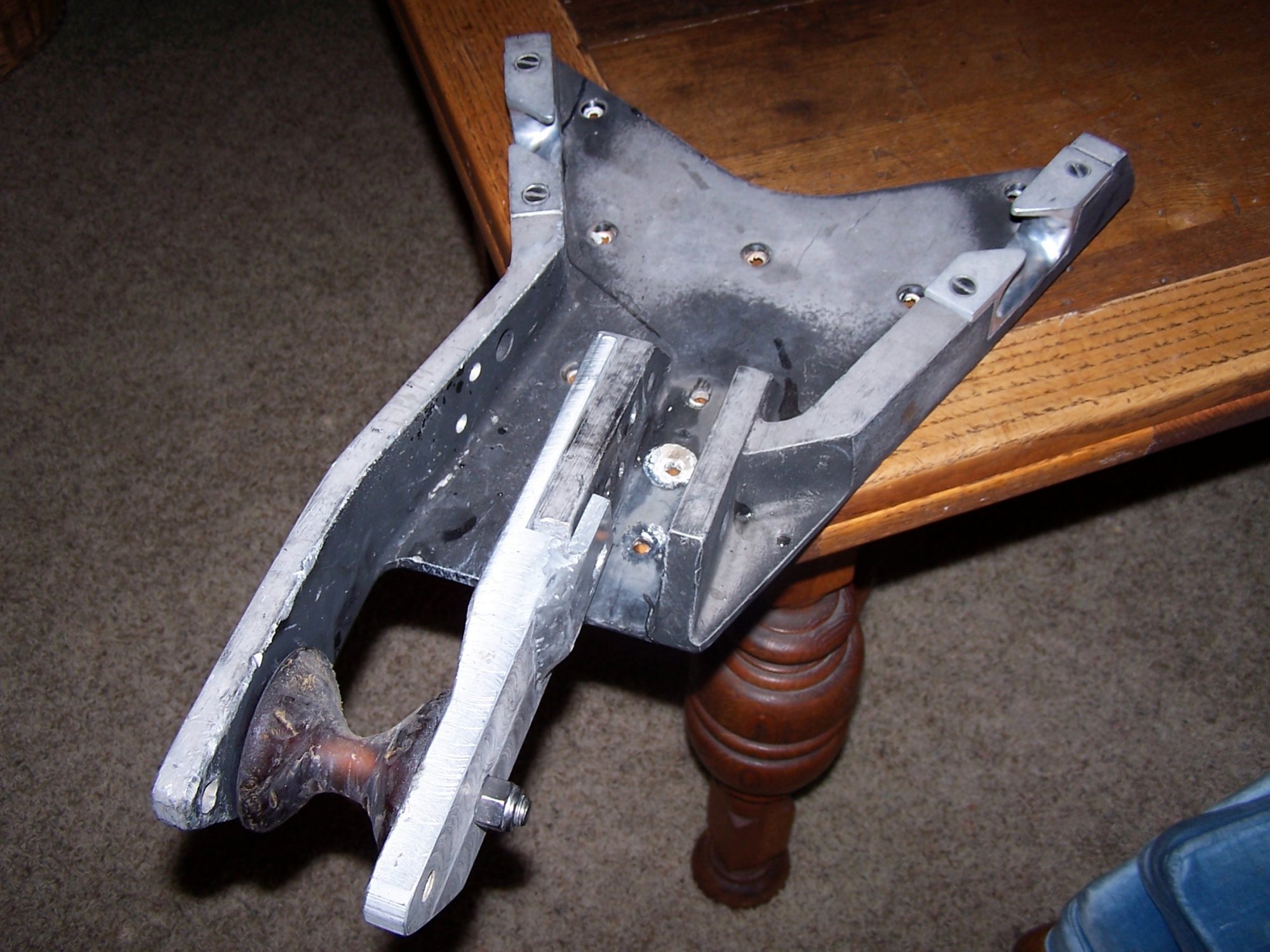

Here is a pic of our previously owned 84 O'Day 37 bow roller. It is cast aluminium and the forestay strap is ss. I'm sure that it is original and is probably the same that is on the 35.

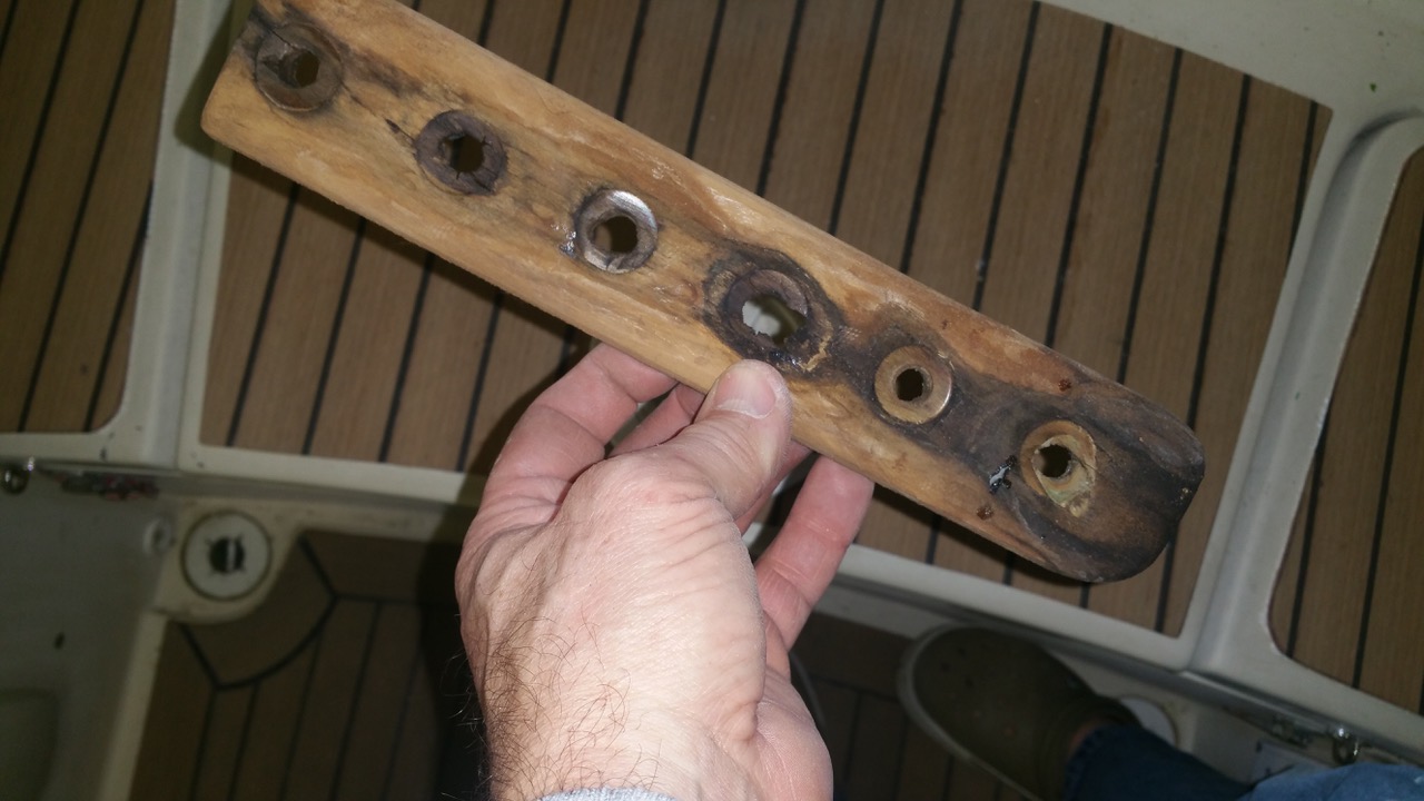

When we purchased our previous boat (1983 O'day 34), the anchor roller must have suffered an impact which necessitated a repair, replacing one leg of the anchor roller frame. I have a couple photos of the original bow plate which was cast aluminum. There was a stainless strap that bolted through the top of the bowplate and deck, and wrapped down the stem as shown in another photo. Both this stainless strap and the strap on the transom for the backstay had teak backing on the inside of the boat - and both were in poor condition. I replace the bowplate with a stainless one fabricated locally, and replaced both of the teak backers with 1/4" stainless plates. Probably overkill, but I figured might as well go big.

Replied to your private message, but looking at your photos, it looks like you may have the original bow plate, but the anchor roller has been broken or cut off. On mine, the stainless strap was bolted through the plate and deck, and the forestay was attached to a pin that went through the parallel castings. Do you seen any holes in the plate aft of the forestay attachment where it may have been bolted through? If I recall, it seems like my stainless strap extended down the bow stem further than yours. Do you see any evidence of holes that were filled or repaired?

My setup is the same as Sefullers. We both had a trailer roller vs a true anchor roller. The replace the old worn roller I was able to get an anchor roller at WM that I cut narrower on a band saw.
