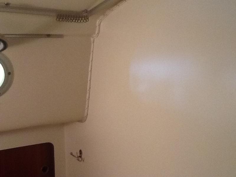

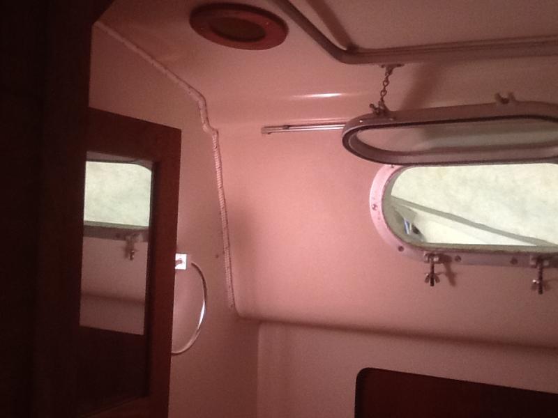

I scraped that old brown crap out ( it practically melted anyways) and glued some new double braid in the gaps. Used 1/4 for the tight gaps and 5/16 for the bigger ones. The nice thing about the double braid, is if the gap gets too big, you can "bunch" it up nice to fill that gap.

That looks really nice. Great idea that keeps things clean. Thanks for sharing. May try this. Will make the admiral very happy.

That does look good. What kind of glue did you use?
