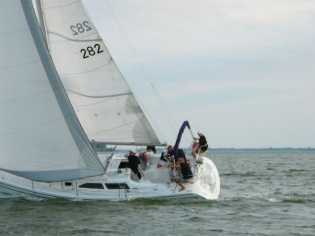

IMHO, and I know I'm about to get blasted, I am not a big fan of a 150 on the 310. I have no interest in racing or putting the lee rail under. Had a 155 on a Catalina 36 and even with a double reefed main, it was a handful over 15 kts. I don't like charging around with a partially furled headsail, trying to find the right place for the sheet leads, and I don't think it's good for the sail, but that's just me. I also feel that the single reef point on the C310's main doesn't reduce the heeling moment as much as I've experienced on other boats. With a single reef and a 150, I think you'll be partially furling the genoa in a breeze unless the attached picture is your idea of a good time.
I'm sure you'll get alternative opinions to justify your lust for a bigger is better, size matters, sail.
