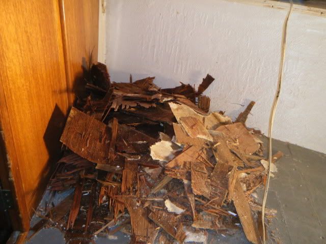

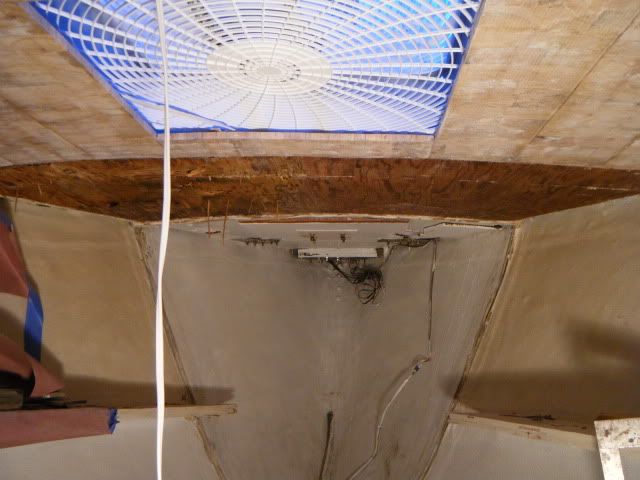

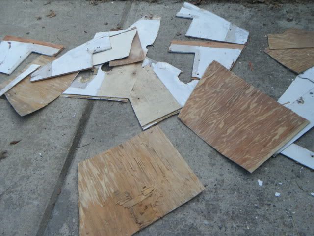

I can assure you even with the inner skin OFF the plywood is delaminated NO LONGER bonded to the outer skin and will NEVER dry
Even big pieces that were removed and stored in my DRY garage in HOT weather stayed wet for 3 months
