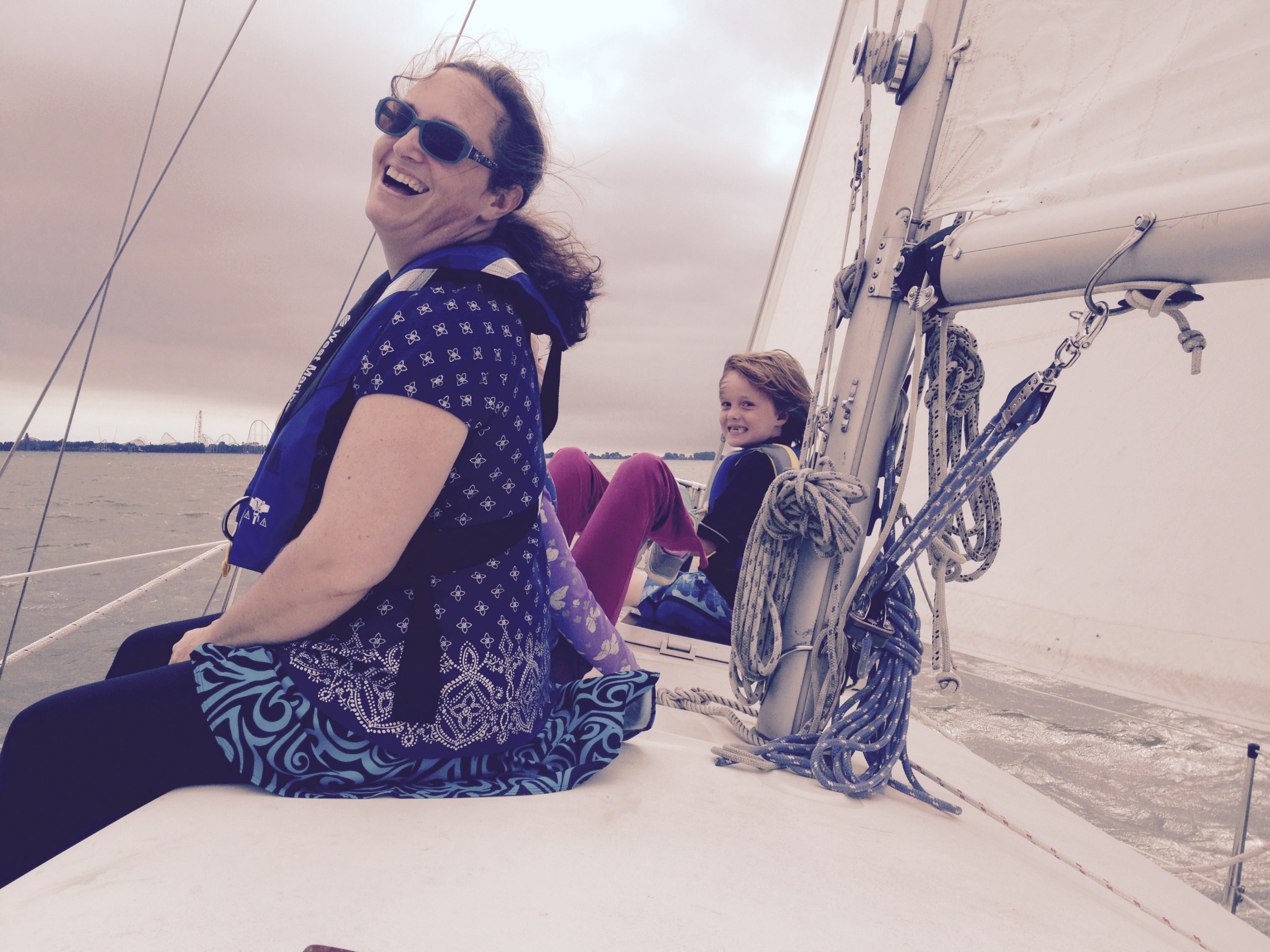

Our boom vang has opening shackles on both ends so we can use it as a preventer, or to hoist a rescued person into the boat. It is a three part fall, so the mechanical advantage is 3. Here is a picture of the vang (and my daughter, grandson, and granddaughters legs!)
I would transfer it to the end of the boom, hook the bosun's chair to it, and use the main sheet in the normal way to control it.
I'm sure you will find a solution!
