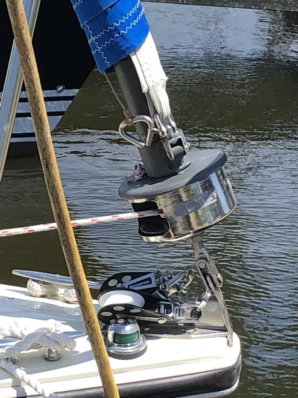

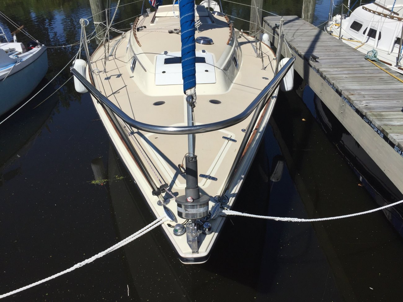

DENNISV, I have the same boat on the same lake in St Joseph. I have experienced the same problem as you, usually in the beginning of the season. I have also asked questions on this and other sites concerning this problem. I cant find any markings on the drum as to brand but am posting two photos in case it’s the same as yours. I’ve found that halyard tension plays a role. Too tight and it’s hard to furl/unfurl. Too loose can yield the same results so for the first couple of sails I have to play around with it. The furling line needs a small amount of tension when unfurling the sail so it winds onto the drum so that subsequent turns can’t be jammed under one of the previous ones. The furling line has to enter the drum at 90 degrees to the spool axis. Last, when unfurling the sail don’t let any kinks or twists in the line stop its movement causing the line in the drum to pull tight and bind. All in all, though, your problem sounds to me like a halyard tension issue.

That is a harken roller furler. I have the same unit on my 35. The line you are using looks large compared to what I’m using. Smaller line allows more extra wraps when furled so in strong winds you don’t end up without enough turns to wrap the sheets a few turns.
