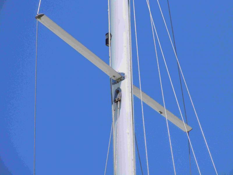

I can't say for certain that your mast/boom/spreader etc are Kenyon. But my 1980 36 is. And I've seen much reference to other Cherubini models having them as well.
Attached is a pic of the spreader on my Kenyon mast. From an invoice of a prior owner, the SS screws holding the spar/mast fastening piece had galvanic corrosion weakness in their threads to the mast. They were drilled out and heli-coils were inserted to make good again.
Just a thought -- with your photos and measurement of the spreader attach-to-mast part, maybe you could call Rigrite and then eMail them the pictures. I would think that someone there would be able to quickly identify which spreader size and shape is the right one. Also on the Rigrite.com, in case you hadn't noticed, are diagrams of mast cross section dimensions and shape which can help you identify.
