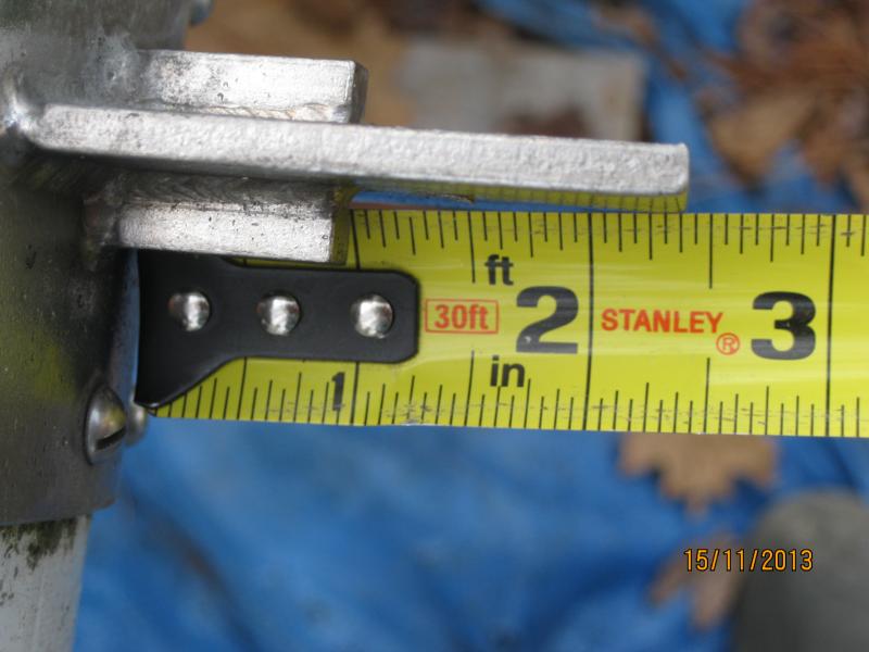

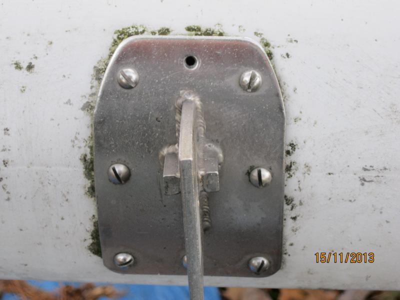

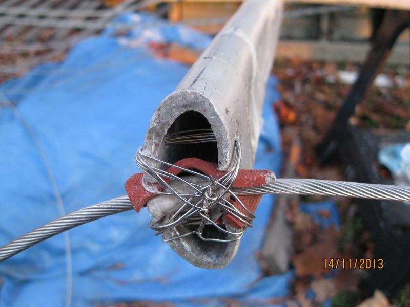

I just got a 1980 Hunter 27 - and while putting her up for the winter, I found that the last owner created his own spreaders by hammering aluminum tubes and using seizing wire to hold the shrouds in place. I am pretty sure the original rig was made by Kenyon, but I have no idea what the original size was. I have been to RigRite web site but without pictures I am not sure what I would order.

So that option is out. The hand made spreader are 40" in length, but appear to be a little long since he added a shackle to the base to reach the chain plate.

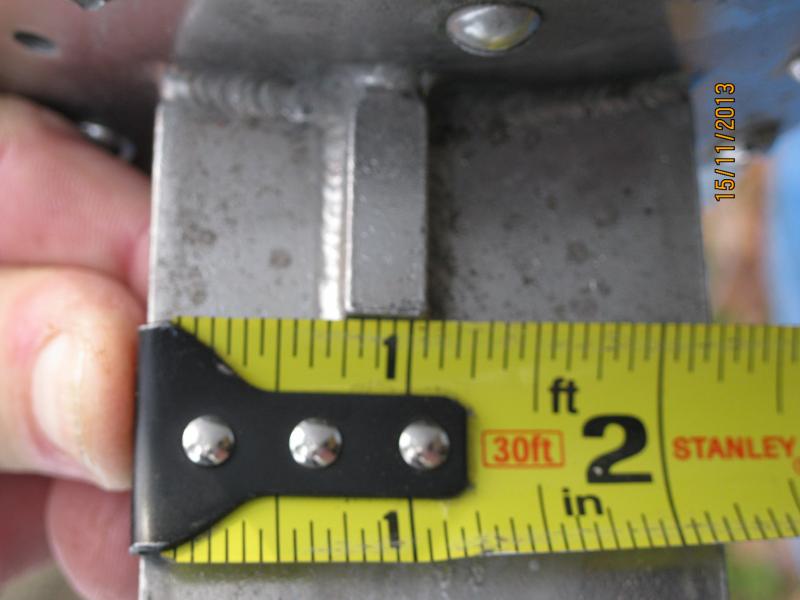

I sent Dwyers an email right after getting your post. The spreader mounting bracket I have on the mast are not compatible with there spars; they said I need SP3's; but I think I will request a quote including the new mounting brackets. I have tried doing business with Rig Rite before and to say I was not impressed is an understatement.

I investigated replacing my round tubular spreaders with neat airfoil ones and found they would not fit over the tubular spreader bracket on the mast. Then I had to take the spreader brackets off to repaint and recondition the spar. Amazingly, there was no evident corrosion. The brackets were installed with aluminum rivets, not stainless-- which I advise anyone to do. Never mind the 'fear' that aluminum rivets are not as strong as stainless. So long as the rivet fills up the mounting hole, where can it go?
Dwyer's have a nifty spreader bracket that would enable me to switch over. I still have not made up my mind about this and will decide when I have the spar painted in the spring. I really don't need them-- just thought it would look cool. In any case I'm glad you're considering them, as they're terrific.
