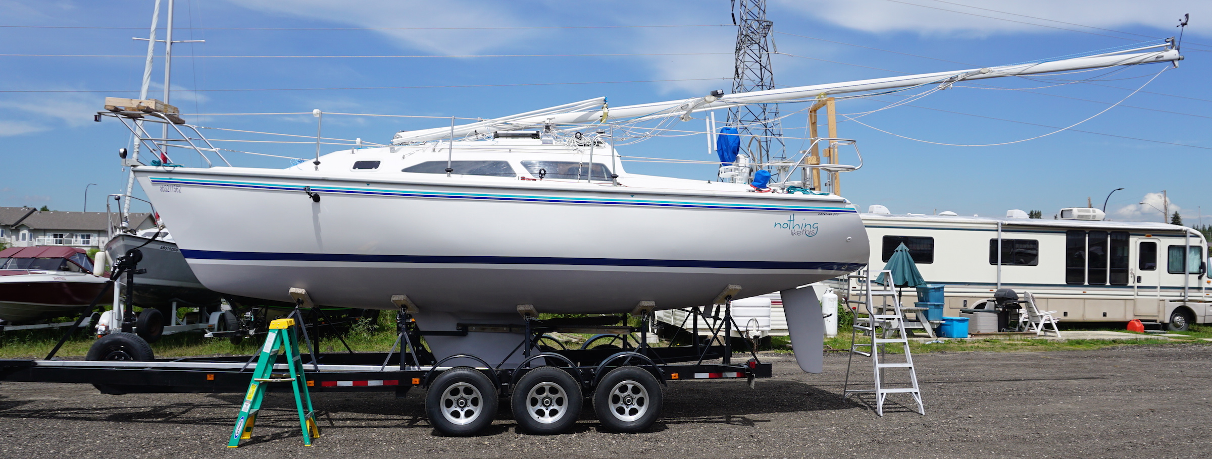

We're a big fan club of tie wraps. A bag of 1000, 12" ties may seem like a few bucks, but they're solid, ultimately adjustable and the only downside is that they are not reusable. We used to have the Mac ready to raise the mast or wrap it up for travel in 20 minutes or less. We do the same on the Catalina, and many times have hit the road well before others who were out of the water before us.
You can't really see the ties on the Catalina, but the process is the same.

Actually, all the little tricks that we learned from the Mac were ported over. Scares the livin beejeebers out of the gawkers when it happens, but it's a simple matter that doesn't take near as long as it does to get the stays tuned.
Guy stood there watching this launch, jaw on the ground, while two of us did it. His DS16, he claimed, took 4 guys over an hour. I wondered (without sounding caddy) how you could get 4 guys on the deck of a DS16. :)
Here's mast on crutch, with both A frames laying on mast. One holds the mast side to side, one is the rigging. 6:1 led back to the winch. The forward lower stays are attached, as is the backstay, loose, just in case. The forward lowers are enough to stop it from going past upright.
I have always wondered how far out the back of a trailed boat you could put a mast before the Law became bothered. I think you have answered my question for me, " A long ways". Have you ever poked a trucker in the eye with your mast :) ? I think you make a very good point. You develop a good system and you hone it until you can do what you and your buddy are doing that is "up and down in 20 minutes".

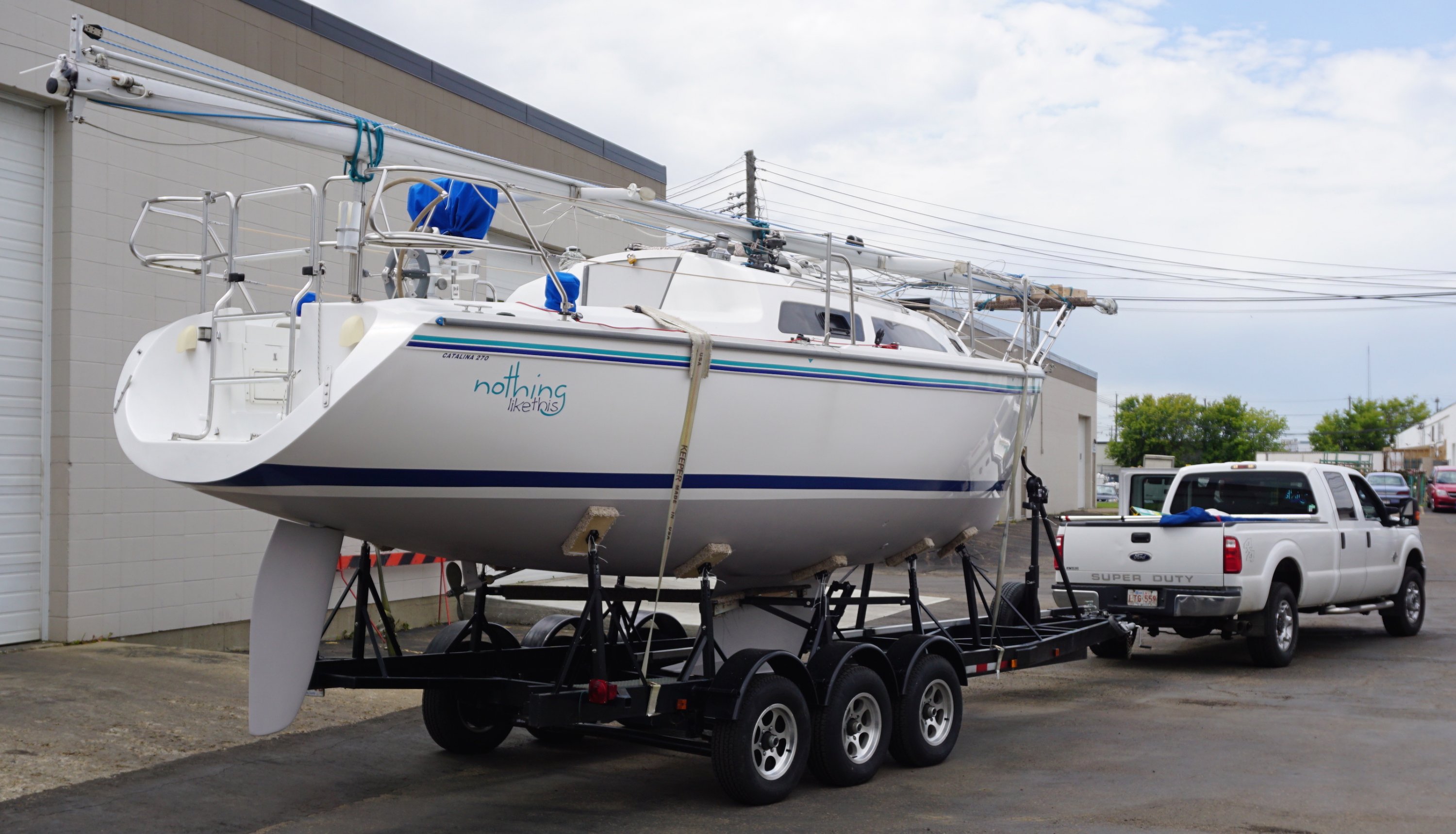

For shore! What beast have you yoked to the front of that sloop?
Just your regulation F350 SWD long wheelbase diesel. Out of almost all the trucks I've had, this one, hands down, rides, pulls, and even gets better mileage.
