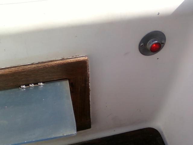

Last night I was spending the night on the boat and went out to the cockpit to do some fishing. I was tied up to the dock and running on shore power when I noticed a red light glowing down near the yanmar engine panel. It is right next to the panel but not part of it. I had not ever noticed it lit before. I quickly went below and checked if all was well. I saw nothing out of the ordinary. I turned off the battery banks and the light stayed lit. I flipped the shore power breaker on the boat to off and the light stayed lit. I disconnected the shore power cable from the boat and the light went out.
I had never noticed this light on before while on shore power although I have only had the boat for a short time and maybe I just had not ever noticed it (unlikely).
Does anyone have any idea what it is telling me? I went through my owners manual and saw no reference to it. I tried to trace the lines but it is located in an out of the way spot and would require some serious contortions for a big guy like me to try and get behind it and trace wires.

That might be a previous owner addition. Only two things I can think of would be 1) a simple way to know that the shorepower cable is attached( maybe he left the dock with it plugged in just the one time :) ); 2) a reverse polarity indicator. These are normally part of your inside electrical panel. Is there one on the panel? And is it also on?

You nailed it! It is a reverse polarity indicator. I remembered I had added a 30 amp to 15 amp adapter the other day that I borrowed from a friend. Apparently it was wired wrong. I put a different one on and the light went out and all is normal again. During the daytime it is barely visible in the sunlight and that was the first night I had been onboard since the new adapter was put on.
