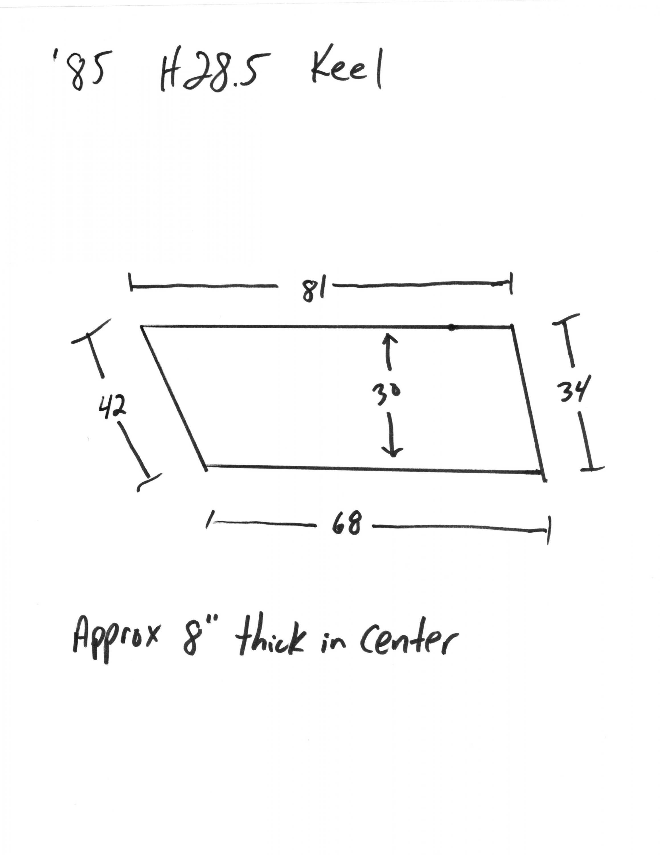

Looking for anyone who might be able to provide dimensions for a Hunter 28.5 shoal draft keel?
Jan 30, 2012
105
Catalina 36 Bayfield, WI
I went out this morning and braved the cold. It's not to scale but here are some rough measurements. If you p.m. me your e-mail address I can send you pictures. Let me know if you need any other specific measurements.
