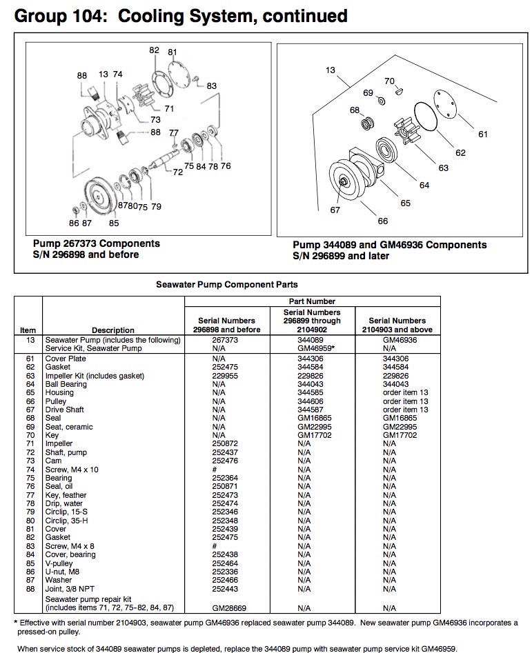

This is for you to check your Genset Serial numbers to make sure.
Best I can do to help you.
Jim...
PS: My Yanmar pump is the left image.
Jim:
Upon further review, I think you have hit the nail on the head. I am 99% certain that my replacement pump is the GM46936 and the impeller is 229826, which is a 12 blade impeller just like mine takes. I can't verify until Friday. The boat is 75 miles away. But I'm going down for the weekend and hopefully wrap this thing up. Thanks.

I have a 1997 Passage 42. It has a Kohler 9.5KW generator. Kohler Generator model # 3TNE78AC-KM . The seawater pump will not draw the water up after 26 years. Needs replacement. We cannot find one. No markings or numbers are on the pump.
Has anyone had to replace this part? How? What is it? Where can I find it?
If anyone has this generator, could you look at your water pump and take a picture of any markings or numbers?

This is the answer to the question of what is the raw water pump on the Kohler 9.5 kw generator:
My generator is the 1995 9EOZ. The current model number for the water pump installed on the 1997 Hunter P42 generator is GM46936. You can find it on the internet for about $200. I was going to install it myself but I've decided to have my shipyard do it because it's just too much for me. Thanks to all for your help.
