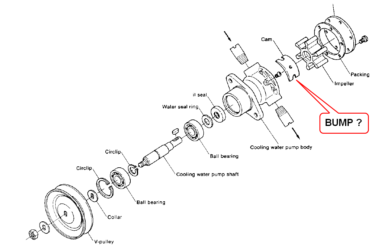

The seawater pump will not draw the water up after 26 years.
Did you ever think you may have an air ingress leak on the suction side ? I can't see the pump just "not" pumping if you replace the impellor every year. The "bump" doesn't need replacing.
  • Helpful
Likes: JamesG161
Sep 14, 2004
198
Hunter 42 Deltaville VA
Many thanks. What pump is this a diagram of? Yes, the "bump" is a cam. Forgot the term.
My pump is 26 years old with 3,300 hours. The impeller wears away the interior of the pump, the cam, the side wall and the cover plate. That causes the lack of suction. We have primed it and even installed a check valve a few years ago to keep the water nearer to the pump. Nothing worked this year after spring commissioning last weekend. We replaced the engine water pump last year.
