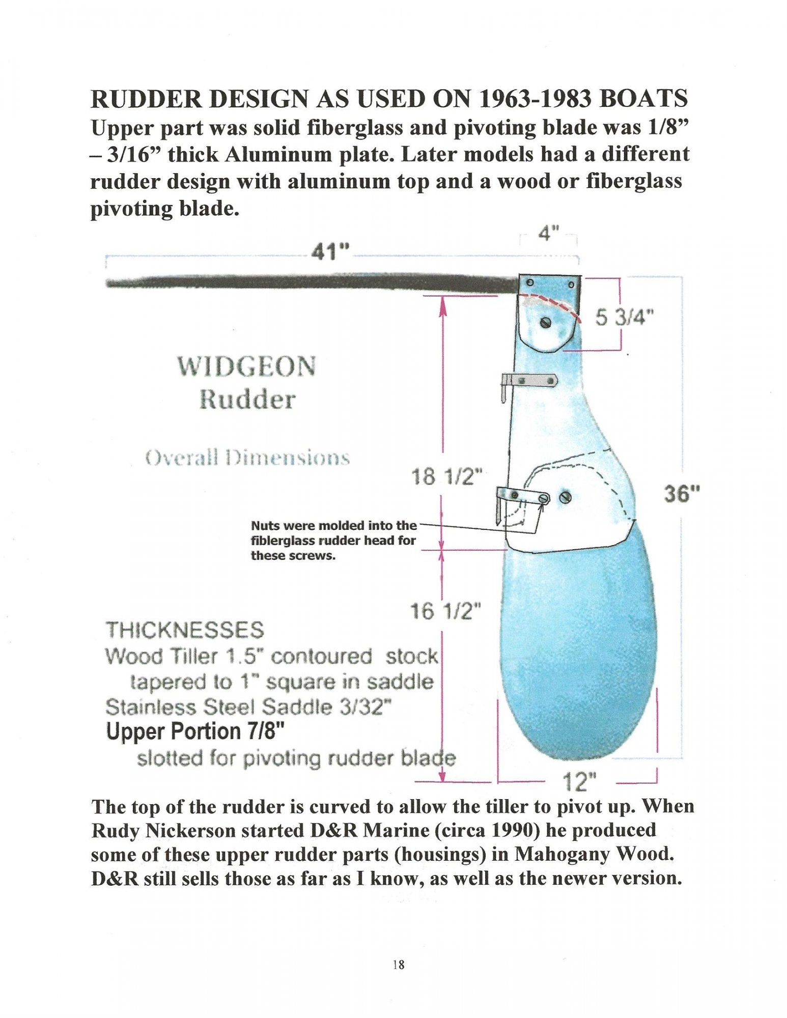

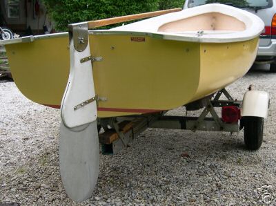

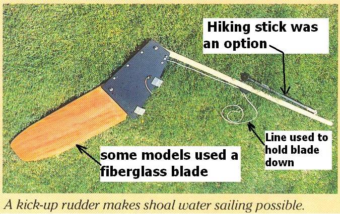

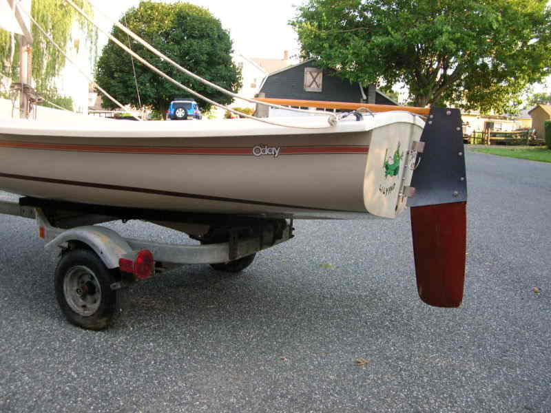

However, that option is a bit pricey! Here are pictures of 2 types of rudder used on the Widgeon, you may be able to find a rudder for another similar-size boat that will work without major modifications or make a new one yourself. The newer version below is labeled "Javelin rudder" but the basic design is same ,I think the Widgeon rudder has a slightly smaller lower part/blade.
