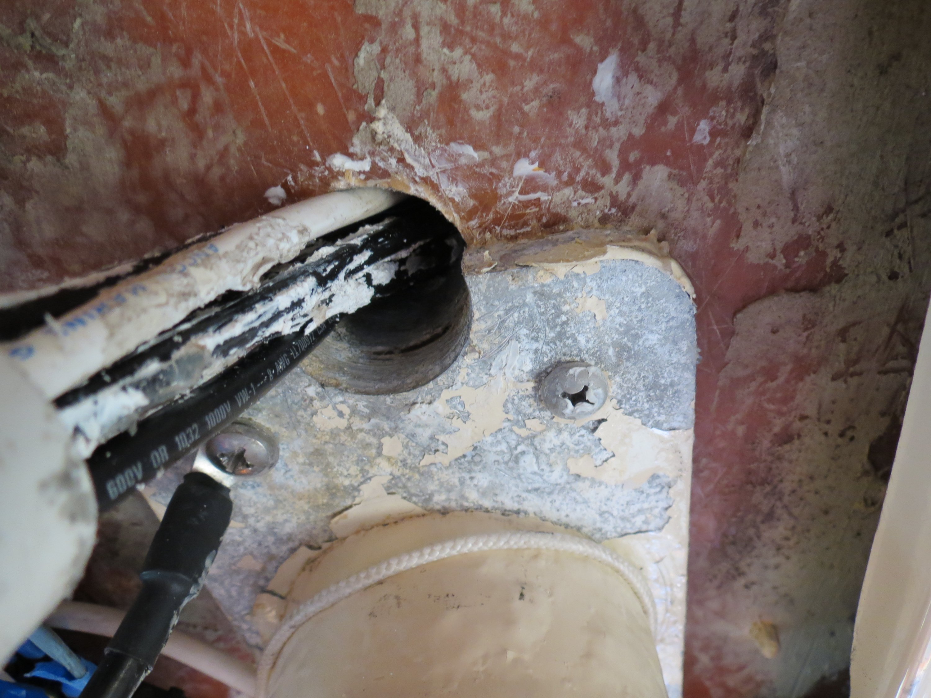

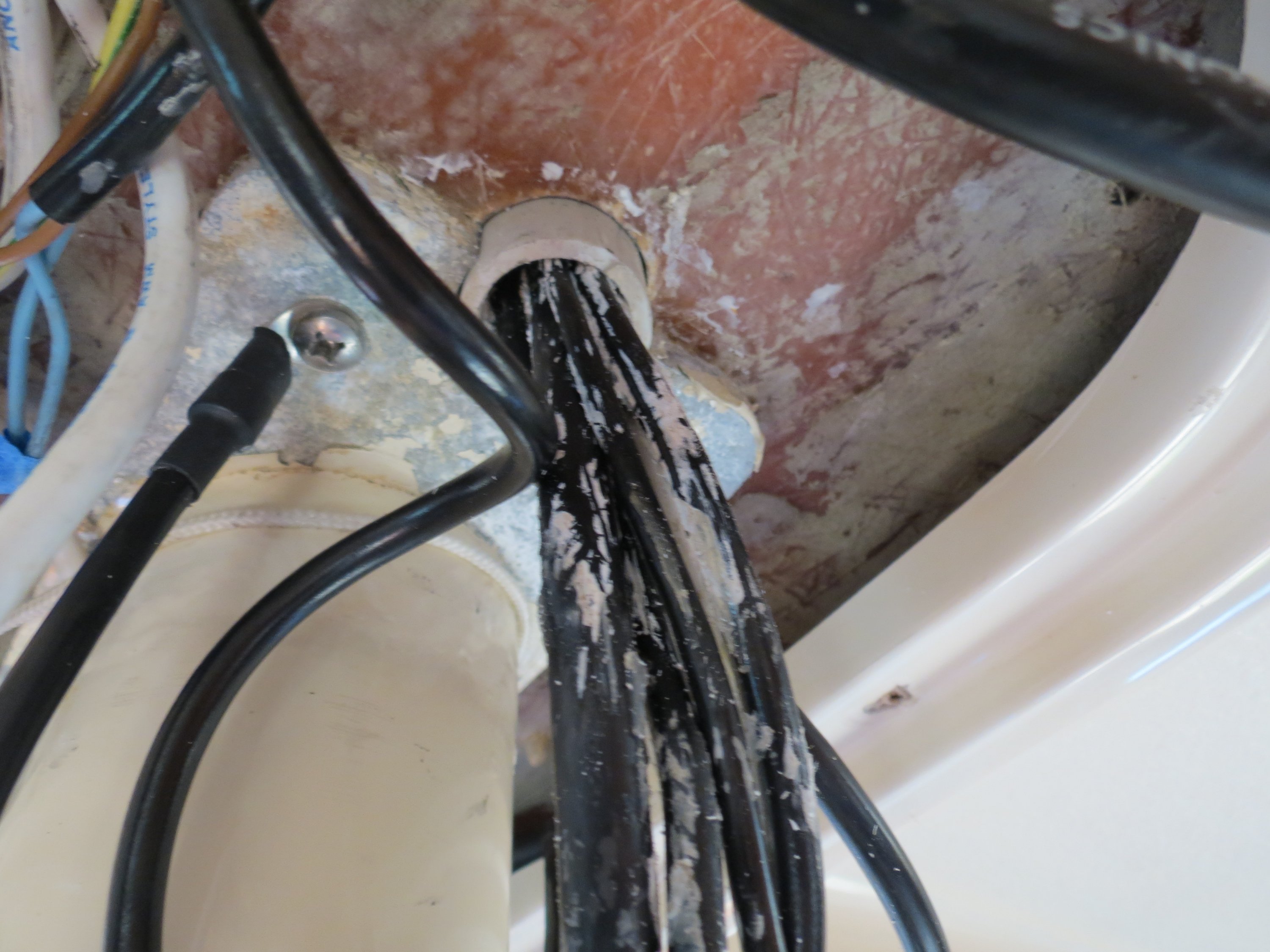

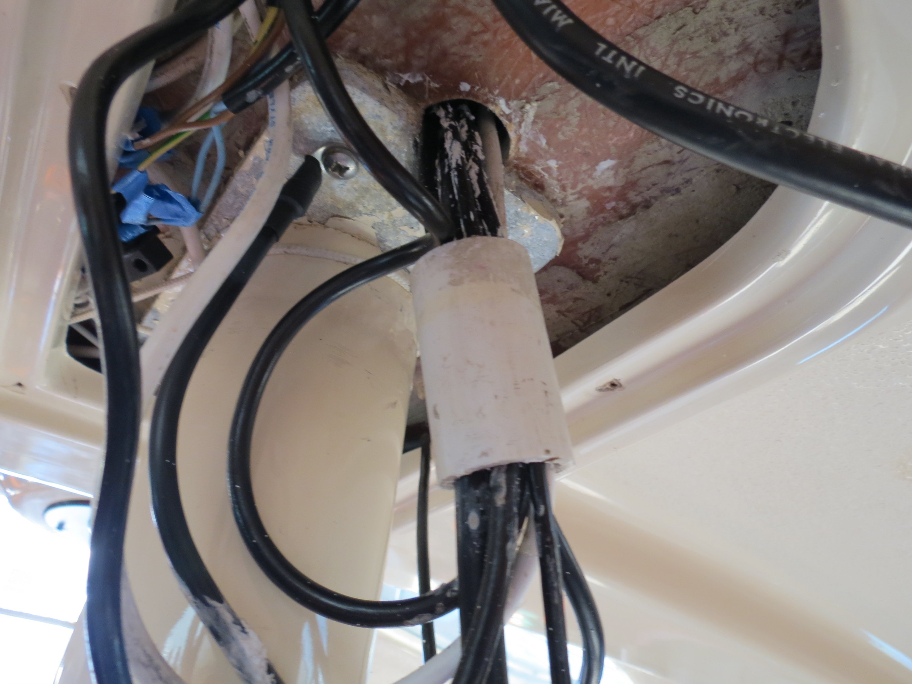

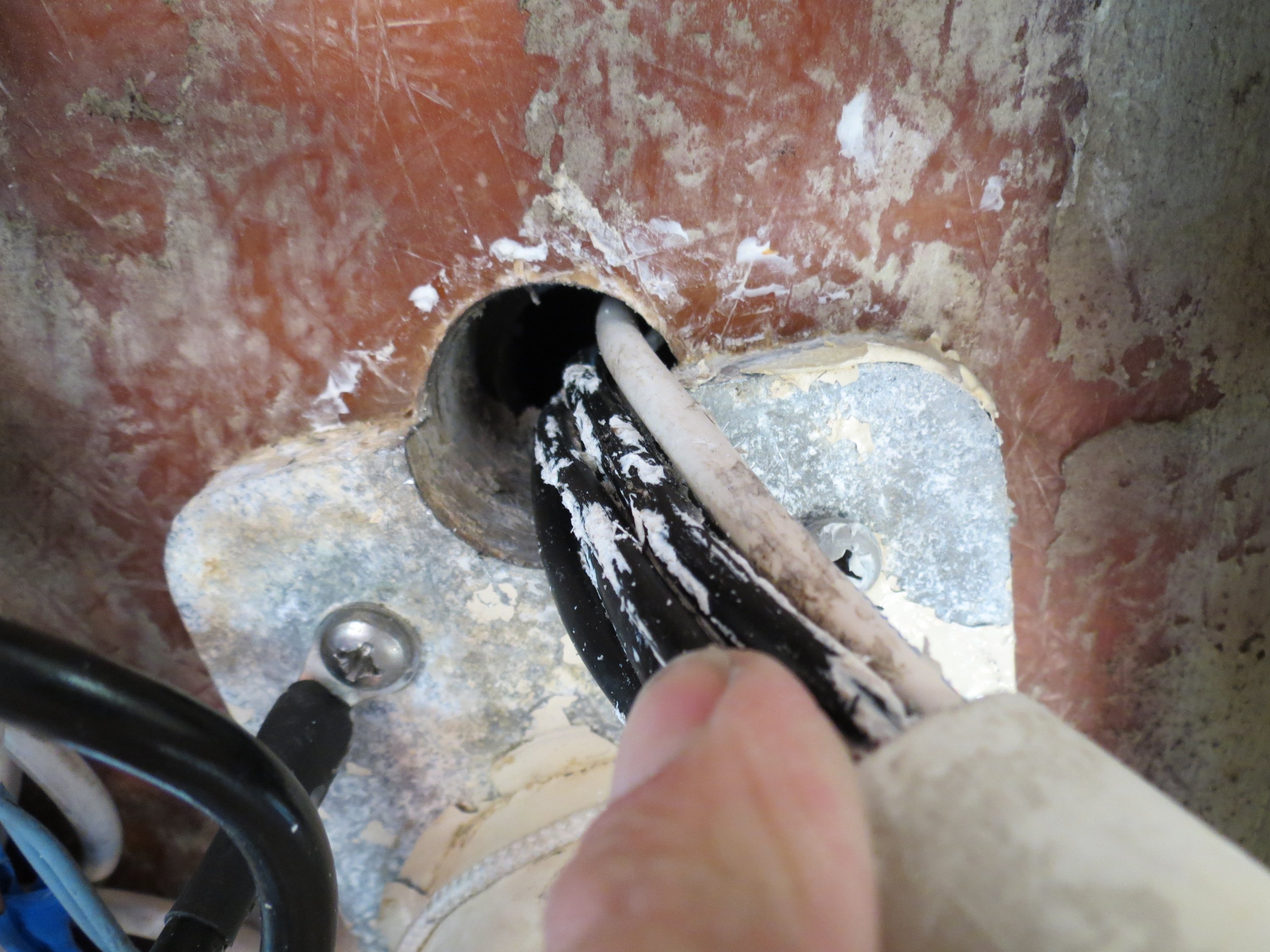

Ok, here is the answer to my leak. (I hope)
I believe that I have found the cause of the leak at my mast step. All of the wires pass thru a 1.5” PVC tube and are supposed to be caulked into that tube. The tube is then caulked into the hole under the step.
I was seeing water drip off of the wires but no water was observed around the outside of the tube. So the water was running down the wires inside of the PVC tube.
Last Spring I replaced the grounding wire that connects the mast step on the deck with the top of the compression post plate inside. I disturbed the wiring in the PVC tube and apparently my re-caulk job was not water-tight.
After removing the PVC tube from the bottom, I discovered that the tube was just 2 1/4 “ long. It was positioned 1” below the deck and the deck is 1 1/8” thick. So the PVC tube was just 1/8’ proud of the deck under the mast step. I had originally thought that the PVC tube was 4” long, but I mis-remembered.
I also discovered that there are some holes near the bottom of the mast through which I can see light from the main salon. That explains why when I sprayed the bottom of the mast with a hose some water got in and found its way to the top of the PVC tube and then down into the cabin.
So I have cleaned most of the old caulking out of the PVC tube, off all of the wires, and from around the hole for the tube. I am ready to re-caulk.
I purchased a 3 oz. tube of the BoatLife Liquid caulk. I plan to dam the bottom of the PVC tube with plumber’s putty and pour the Liquid caulk into the top and work the wires around until the liquid fills all of the spaces between the wires. The instructions claim it takes 3 days for a complete set. The final step was to re-install the PVC tube. In an effort to get some caulk around the top of the tube inside the mast step, I was going to try the following:
Push the PVC tube up entirely into the mast. Using a long stick, wipe some caulk around the outside of the PVC tube. Pull the PVC tube (by the wires) back down into the hole until the bottom of the tube is 1/4" beneath the underside of the deck. That should position the PVC tube about 7/8” proud of the deck inside the mast step and give me a grip on the tube should I ever need to remove it.
I have cleaned out one of the weep holes at the bottom of the step, and I was told that there are 3 more weep holes that I haven’t found. I will look closely to see if I have them and confirm that they are clean. They will allow any water that tries to accumulate inside the mast drain out.
Below are pictures of the underside.
