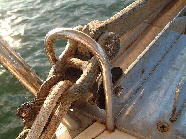

Here is a picture of the clevis seizing that I use
I went looking for a military description of how to seize the pin, and after finding a document that details the procedure, I realized that the "special" technique that I was remembering really applied to adjacent bolts that had holes drilled in the heads for wiring the head to each other. This is not exactly the same as wiring a shackle pin. I did say my experience was in a previous life.....
However, using a figure eight wrap will put tightening tension on the pin if it tries to move. Below is a picture of what my seizing looks like.

Rich, what kind of wire are you using?
Stainless locking wire is typically type 302-304 stainless and is commonly available in 0.041 and 0.032 diameters. I use the heavier 0.041 size. A one pound spool will last you a lifetime unless you are in the business of building moorings and ground tackle.

I've been using wire that is single strand, and yours looks twisted. I like the looks of it, and wondering if I've been using something inferior. The single seems it work hardens too quickly, and that has always been a concern of mine.

Lock wire is typically solid wire, the twisting is part of the installation process and special pliers are available to get you the right twists per inch. There are youtube videos showing proper installation of lock wire. Also there are aeronautical specifications for proper installation. I know this isn't an airplane forum but the practices apply equally well.
In recent years precut twisted wire lengths started being used to reduce assembly labor. These are custom part numbers and use crimp style ends to hold them in place.
AS 567 is the aeronautical specification but you may have to pay for it to get a copy.

back in my aircraft days in the 60's (military) it was standard to have 7 twist per inch in the wire when safetying fasteners from one to the other..and also you needed to serpentine the wire so if one was to go in the loose direction the other would pull in the tightening direction....

Chris-
The locking wire is solid. The twists that you see are at the end of the wire. There are two separate twisted loops on this clevis pin.
