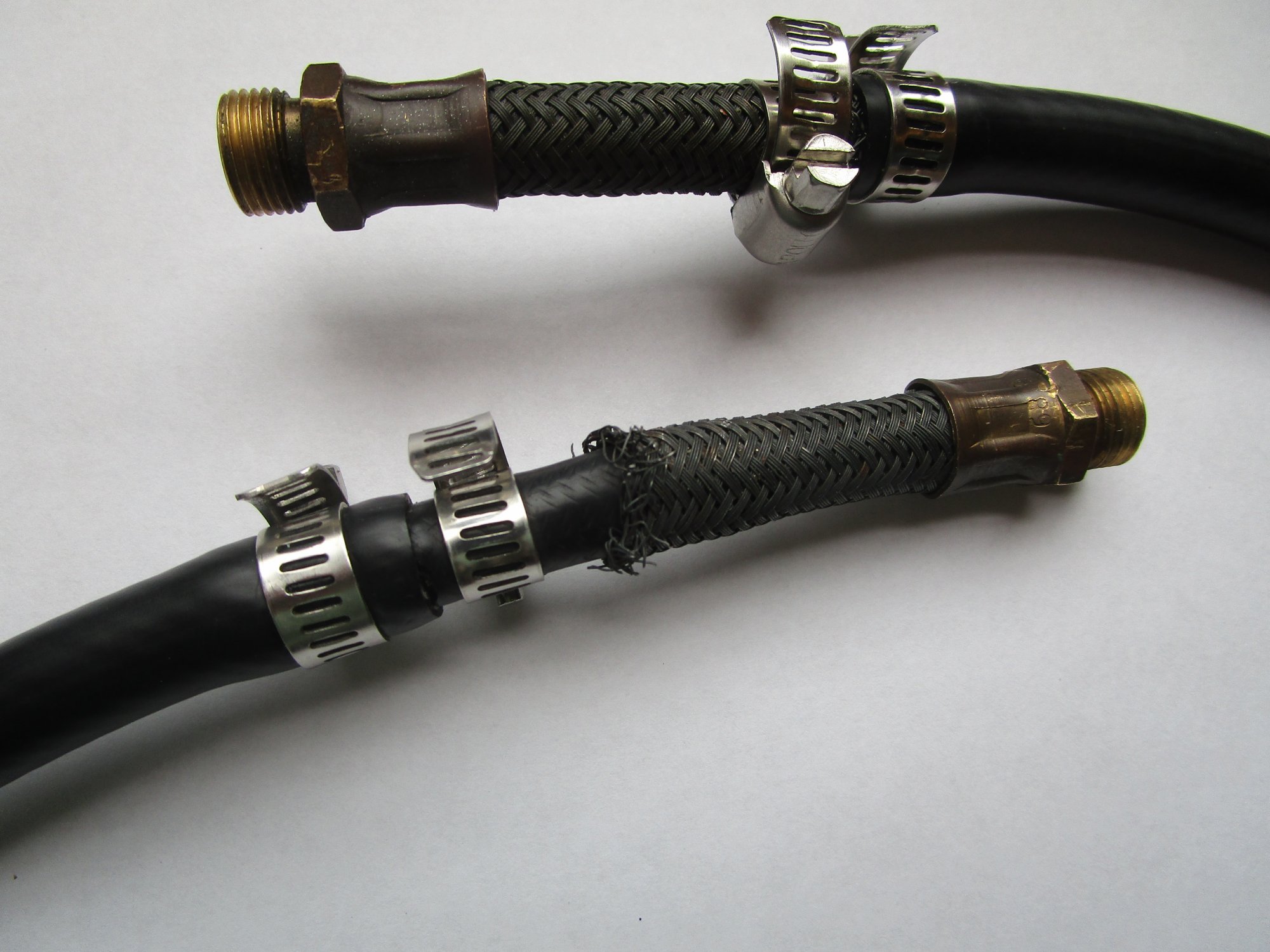

Have this engine in my Beneteau 1990 41S5. It connects with a flare nut to the top of the injector pump and runs down about 36" long where it connects to about 1/4 copper line which then runs to the fuel tank. Its not a engine part I dont think or I cant find it. It leaks and needs replaced.

You're going to have to post several, well laid out pictures because, as you have verbally described this, the arrangement makes no sense.

I have been informed by Perkins that it is not a part . All customers make their own "bleed off pipe. " as they call it.
Jul 13, 2009
84
Parker Skipjack 37 Clearwater
I have now been to 3 hydraulic hose shops, a goodyear/parker shop, and a Fuel injection shop. None have or can ID the brass hose fittings that screw into the nut attached to the fuel injector pump and the copper tubie line on the other end. One Perkins parts supplier said it might be perkins Part No. k441af01 but it hasnt been made for 27 years. Its now leaking at the crimp space on the lower end fitting. Connection at the fuel injector pump is not current leaking.

If I understand this, based on the image you choose to provide, the part mentioned is the fitting (Part No. k441af01) is on the end of the fuel hose. That is consistent with the Perkins parts listing on line. The image looks like someone took the original fuel line, cut it into two short pieces preserving the ends that fit into parts on the engine, and plumbed a hose in between. Is that hose leaking? Are the stubs decaying and leaking?
Where exactly to you believe the leak is coming from? I would suspect your modified hose is at fault.
It is also possible that the fuel is leaking up the threads of the fitting as suggested by Dave.
Firstly I would identify the leak location. If it is on the pump body, that is a more difficult issue. If it is the hose fitting, have you tried to swap the threaded ends to see if the leak moves away from the pump? It is rare that the leak is on the threaded portion. If it is then some plumbers sealant could resolve that issue.
An image of the pump where the hose fits the pump would be remarkable.

Dear John ,Thanks for the response. Your first paragraph is correct. Its a new hose fastened to the old fittings using 4inches of old hose connected to new hose with ss clamps and a brass barbed 1/4 hose mender. Now the old hose part leaks at the swaged old fitting! at the lower end. Probably because all the on and off handling disturbed the 30 + Year Old connection. Now Im considering 'harvesting' the old fitting --- then trying to clamp the inner brass sleve to the new hose. Cutting the swaged part off with a lil hacksaw
