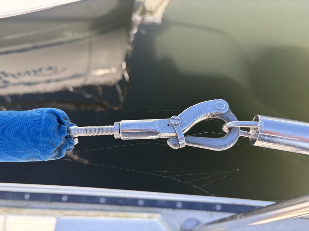

I had 2 of these pelican hooks on my 1985 Catalina 25. They are right threaded. I ordered a replacement from Catalina Direct, and it wouldn't screw onto the lifeline. Does anyone recognize this pelican hook and can you recommend a replacement? The previous one is on the bottom of the lake. Thank you.

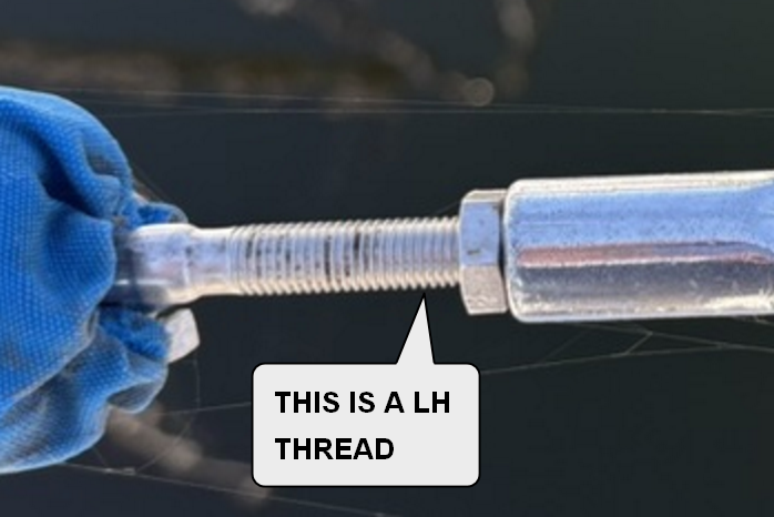

I don't follow your write up. The studs on your life lines are LH threaded or counter-clockwise (CC) threaded as shown in your photo :
Do I understand correctly that you ordered a new hook from Cat Direct with a "right threaded" female thread ?
If I've got this right, then there's your problem. You need a new pelican hook with a LH thread.

That would certainly be a simple solution. I must have misunderstood so I'll try a left handed hook.
Ask them to swap your RH piece for a LH one... perhaps include a self addressed pre paid parcel envelope for their convenience.
