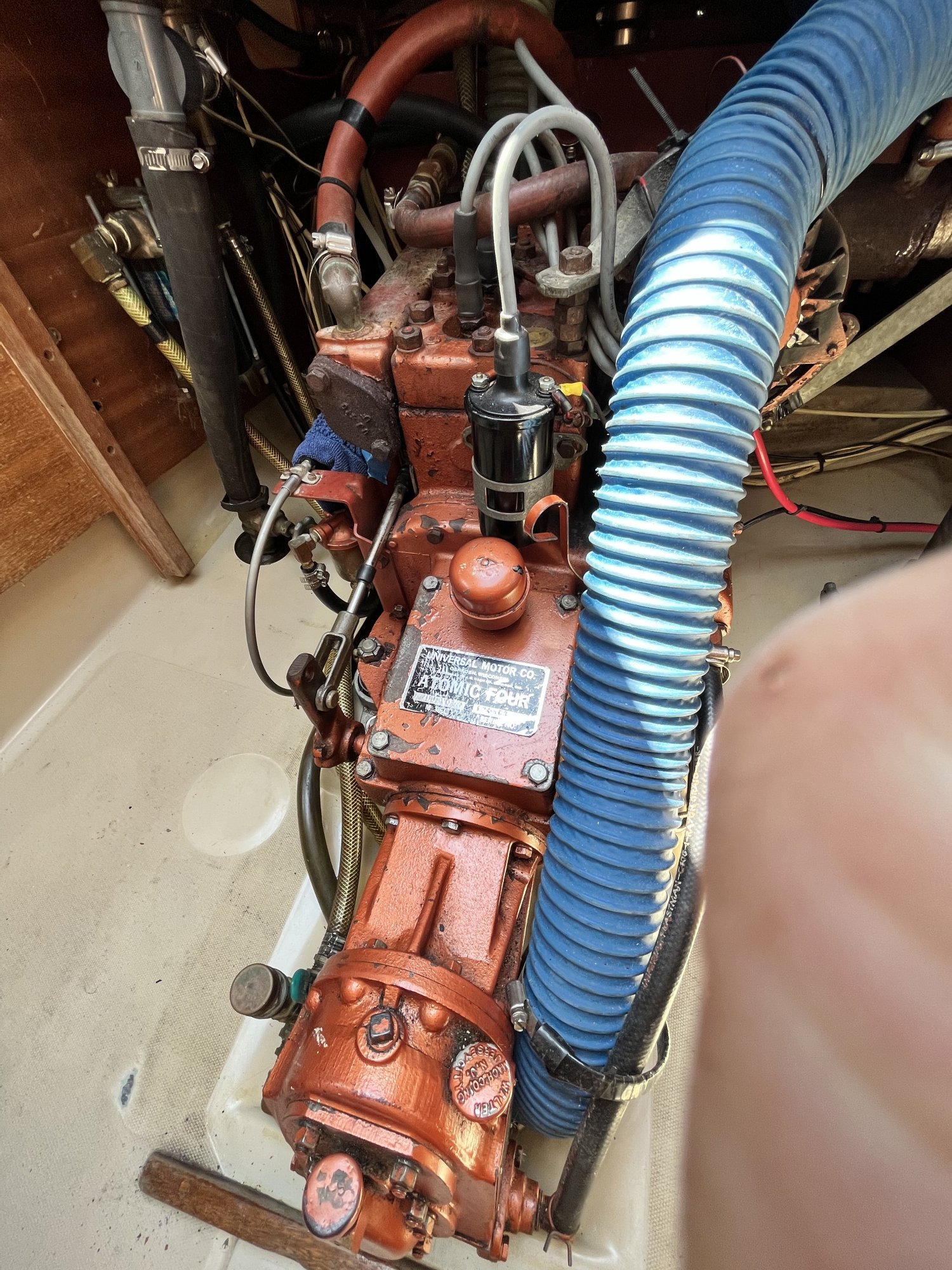

I am looking at the possible purchase of a 1968 Jensen Cal 34. The boat is in great shape. The owner is selling it at a low price because of the purchase of a larger boat. I visited the boat and there were no apparent soft spots. The bottom looks good. Here are some pictures and also a YouTube video that I took. Please offer any opinions that you may have.
The boat deck and Hall seem to be solid fiberglass. It has the original universal atomic motor which had a valve job about 20 years ago.

assessing any boat based on pictures is a dubious task. Any boat that old will have issues a new boat owner likely won’t be able to discern. Get a surveyor and be aware that gas engine boats are generally cheaper than are diesel powered ones.

The port side forward chainplate appears to have a good bit of water damage to the fasteners and the bulkhead.. Not a huge job to access/repair, but all the others should be looked at carefully.. The gasoline engine (as Don says) is a bit of a downer but when maintained correctly, it is extremely reliable. They were used successfully in many boats in the early years.

Cal boats are good solid coastal cruisers. A 68 Cal 34 has a similar hull to my 35. Looks like the deck toe rail has be assed. The deck in that age is plywood core. Your video shows that the boat is cleaned to let the potential buyer see her at her best. The Atomic 4 gas engines were work horses, used in boats to reduce the cost and reach a price market. The diesels were preferred by boat owners willing to pay the extra.

Having spent far too many hours bent over an Atomic 4, I am envious of that engine access. Mine was neatly tucked under the cockpit and required a lot of boat yoga to access the transmission and water pump. The alternator would be challenging to access however.
