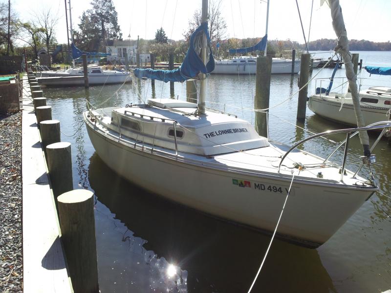

I am getting an O'Day 23 this weekend, no trailer. Want to bring it home for working on this winter. I would like to know what I'll need to do that. Would be great to get pictures of an O'Day 23' on a trailer with the measurements. I've seen a couple of trailers on Craigslist. I'm thinking I'll have to modify a trailer to fit.

Thanks! Took possession of my '23 yesterday. Wow, lots of work to be done. Need that trailer to bring her home. :)

That's a pop top! What's the class number. (It's on the brass plaque at the rear of the cockpit.)

Yep, it's a '72 pop top. I'm expecting to get back to the marina Sunday. I'll see if I can get it then. Any pictures of the bottom of your boat would be appreciated.

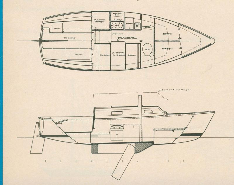

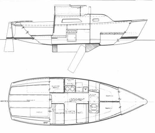

Jun 2, 2004
1,946
Oday Day Sailer Wareham, MA
Gunkh-o-lin, had to say it a couple of times to catch the meaning!
Anyway, what year is your 23? If she is a 1971-74 model with the cast-iron keel and fiberglass centerboard the dimensions will be different from the newer (1977-85) version with the keel molded as part of the hull. The newer version also has a fiberglass centerboard and the lead ballast is inside the keel.
I've added 3 drawings here, to show the 1977-85 model, the 1973-74 pop-top model, and the 1971-72 pop-top. The 1971-72 also came as a fixed-top and that model would look virtually the same as the 1973-74 but without the pop-top. the 1971-72 models also had a notch in the transom to mount the outboard, later models all had a full-height transom and a bracket for the outboard. 1971-72 pop-top models have a keel-stepped mast, all others have a deck-stepped mast.

Sunbird, My 23 is a 1980. It matches your line-drawing on the left (two berths aft). I've tried putting a line-drawing into google sketchup to approximate dimensions, but I sure don't want to make a 3000lb mistake when pulling her out! My guess at the three dimensions are
#1: COG - 13' to 14' (from bow)
#2: Bunks at 2' from center and 2'3" height (front and rear, 3" less on center support)
#3: 5' distance bow to ball would be sufficient.
