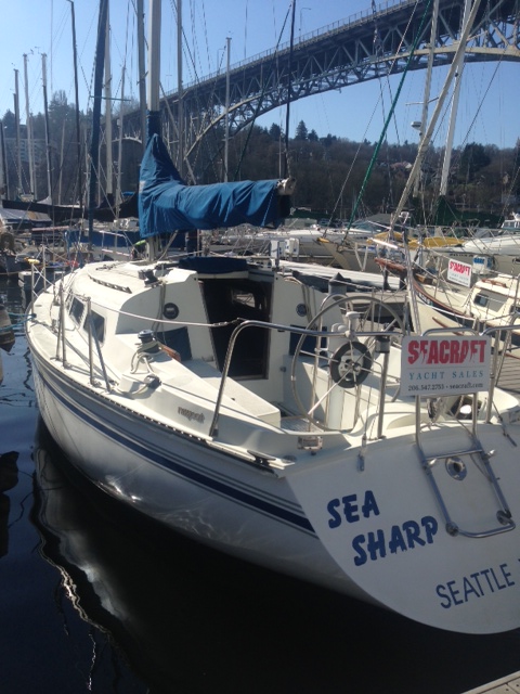

Does yours have that nice walk over steps on the stern? If you are not already a member here is a link for the Facebook Newport owners. I have a 1987 Newport 30
https://www.facebook.com/groups/860390570690157/
Dreaming of those stern steps , but nope, just a swing down ladder. Mine is the aft cabin version though with the Nav Station on a long drawer to position when needed. I don't use Facebook, so hope to link with other Sailors here.
Cheers!
Jun 5, 2014
209
Capital Yacths Newport MKIII 30 Punta Gorda, Fl
My nav table is the same way. I would love to have those swim ladder steps myself. Nice boat.
