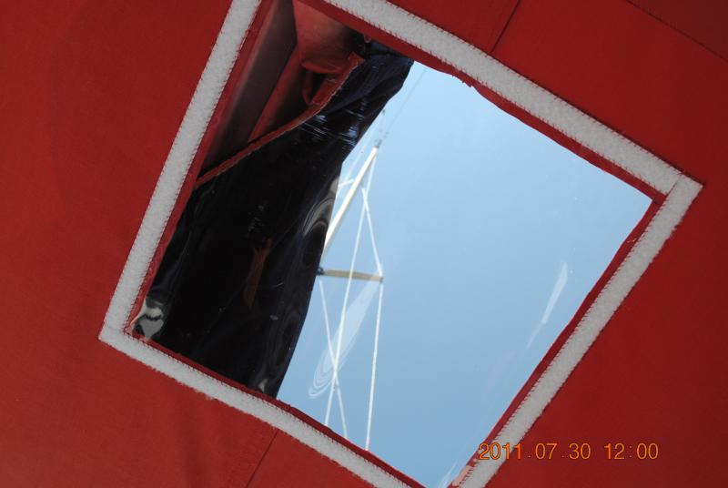

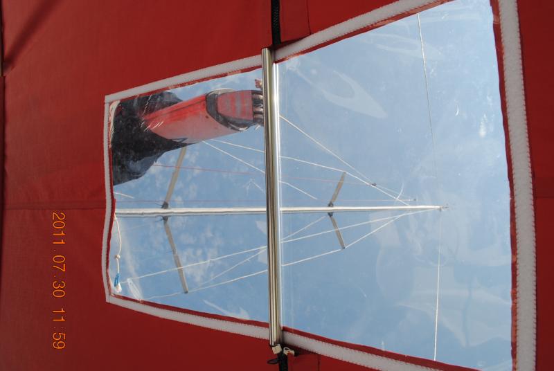

you can install custom sailing windows, use the waterPROOF sunbrell fabric, install pockets for stuff, make a cover for it that fits while on the bails, etc. I found that the 5' nothing First Mate could only see the the top 6 feet of the mast and sail leach. made the window longer fore-&-aft so she could see town to the clew and she (go figure) started sailing the boat faster and asking for more sail trimming.
First picture is the hoisting window so the trimmer at the electric winch can see the mainsail as it is raised or lowered

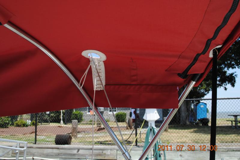

Second is the backstay lacing. Zippers stink for this application
the third is the view from the helm. We made covers for both windows so you can keep the sun out when needed.
