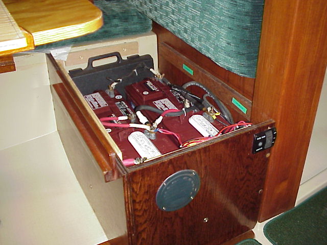

More Batteries?
I changed the "L" shape to a "U" shape settee. This gave me room for a new house bank. The weight is in the center of the boat and also down low where you want it. It also provides easy access for checking the battery water levels. This is on a '82 Cat 30. I enjoy having the extra AMPS for the TOYS.
