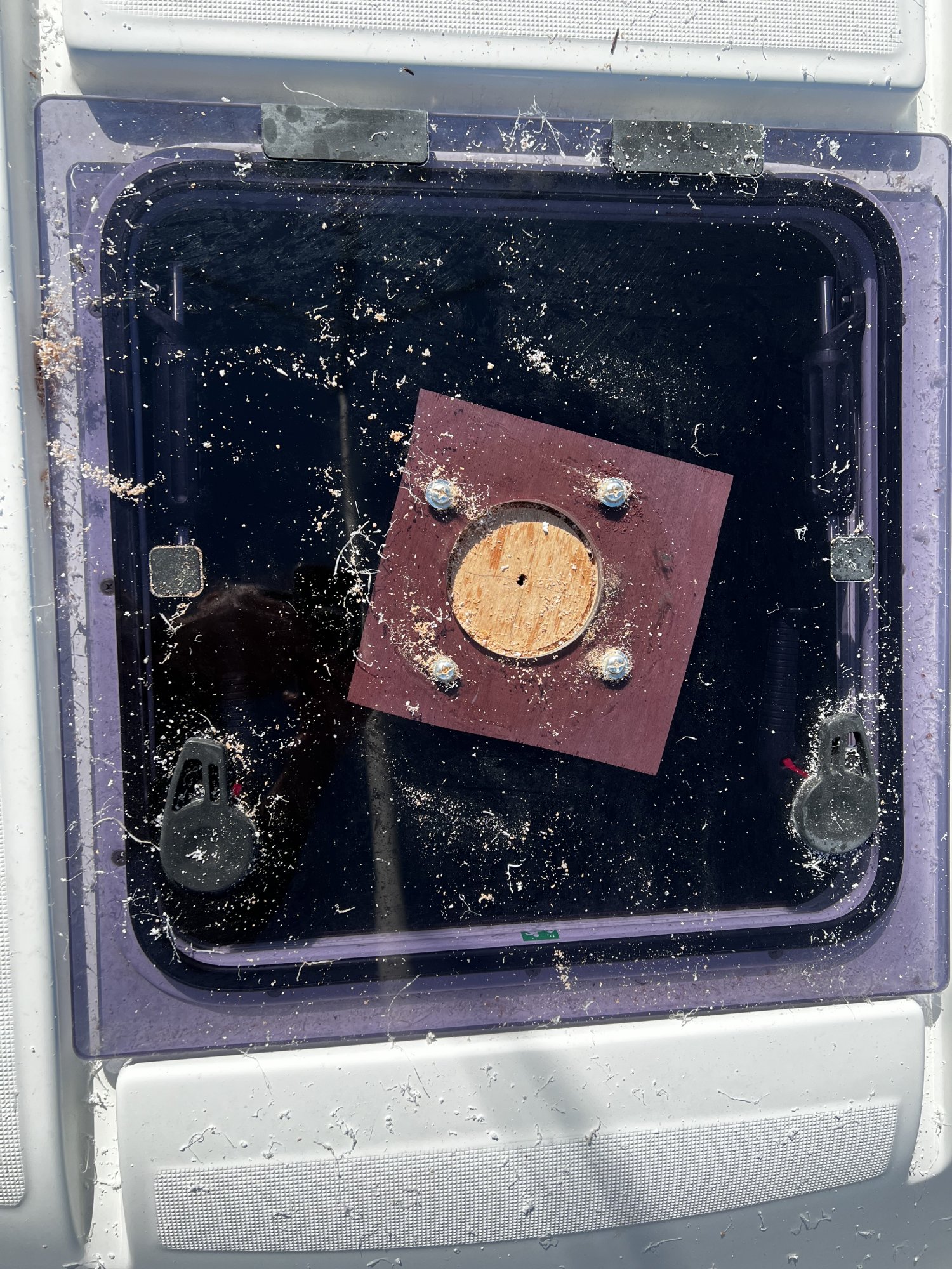

The forward hatch on my boat has a passive ventilator. I want to replace it with a solar/battery active ventilator.
The existing hole for the passive ventilator is about 2.5" in diameter. The active ventilator needs a 3.5" hole. (No, I couldn't find a smaller active ventilator.) What is the best way to drill through the hatch? It must be some variety of acrylic which, from sites on the font of all knowledge, shouldn't be too difficult. Use a wood backing, use an acrylic hole drill, let the drill do the work.
Anyone done this and have any tips to pass along?

Tape the surfaces where the cut will be. That helps to avoid cracking. After the hole is cut, sand the edges of the hole to blunt the sharp corners and prevent cracking.. Good luck.

Acrylic hole drill doesn't exist. Use a 3.5" quality hole saw (DEWALT, Klein, Milwaukee) which will be razor sharp. Remove the hatch. Ensure the the 3/4" plywood base is firmly attached to the acrylic hatch for a pilot hole. Use minimum pressure and maximum speed. Pause frequently if sticking occurs.

The challenge is that you don’t have a way to use a pilot bit….
When I needed to drill out a few thru-hull holes a bit bigger, I drove a wooden plug into the existing hole, then used that to center the pilot bit on my hole saw. Worked fine. So you need to use some plywood to fill the exiting hole. Maybe screw larger pieces top and bottom to hold the piece in place. Sort of sandwich the circle in place.
As others have said, tape the area to be cut, and cut without a lot of pressure. If you cut too fast, it might melt the plastic too, so watch for that.

To make a larger hole, use a 2.5" hole cutter on the drill bit and on the same bit fasten a 3.5" hole saw. The 2.5" will naturally be longer since it is in front of the 3.5" and it will hold the 3.5" centered.

When I drill or cut acrylic, I find it best to sandwich it between two pieces of plywood and drill/cut through the whole sandwich. This eliminates chatter and other problems, especially with thin acrylics.

Greg, as mentioned in post #3, use 3/4" construction (cheap) plywood as the material for a new pilot hole. The hatch frame is sitting on the work bench. Extend the pilot drill so it has a good grab before the 3-1/2" hole cutter contacts the acrylic. Attach a large piece of 3/4" ply to the underside with a few pieces of double sided tape and clamp the whole mess down on the bench. I say to use 3/4" ply so the pilot drill doesn't get sloppy towards the end of the cut. Hell, if I'm really in a hurry, I've clamped acrylic to the bench itself and drilled into the bench top for a pilot. Not very workmanlike at all :redface:.

Thanks for all the input. It went fine. Until I went to put the collar in the 3.5" hole. Reread the instructions and saw that the hole needed to be 3.75". An hour routing out the hole with a big drill bit. Note to self: Read instructions more than once fast.....
