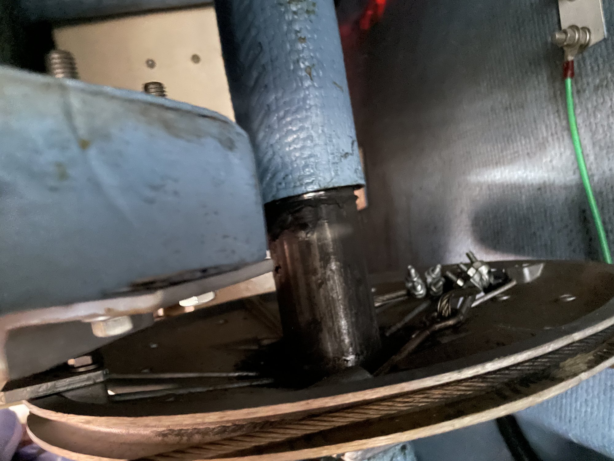

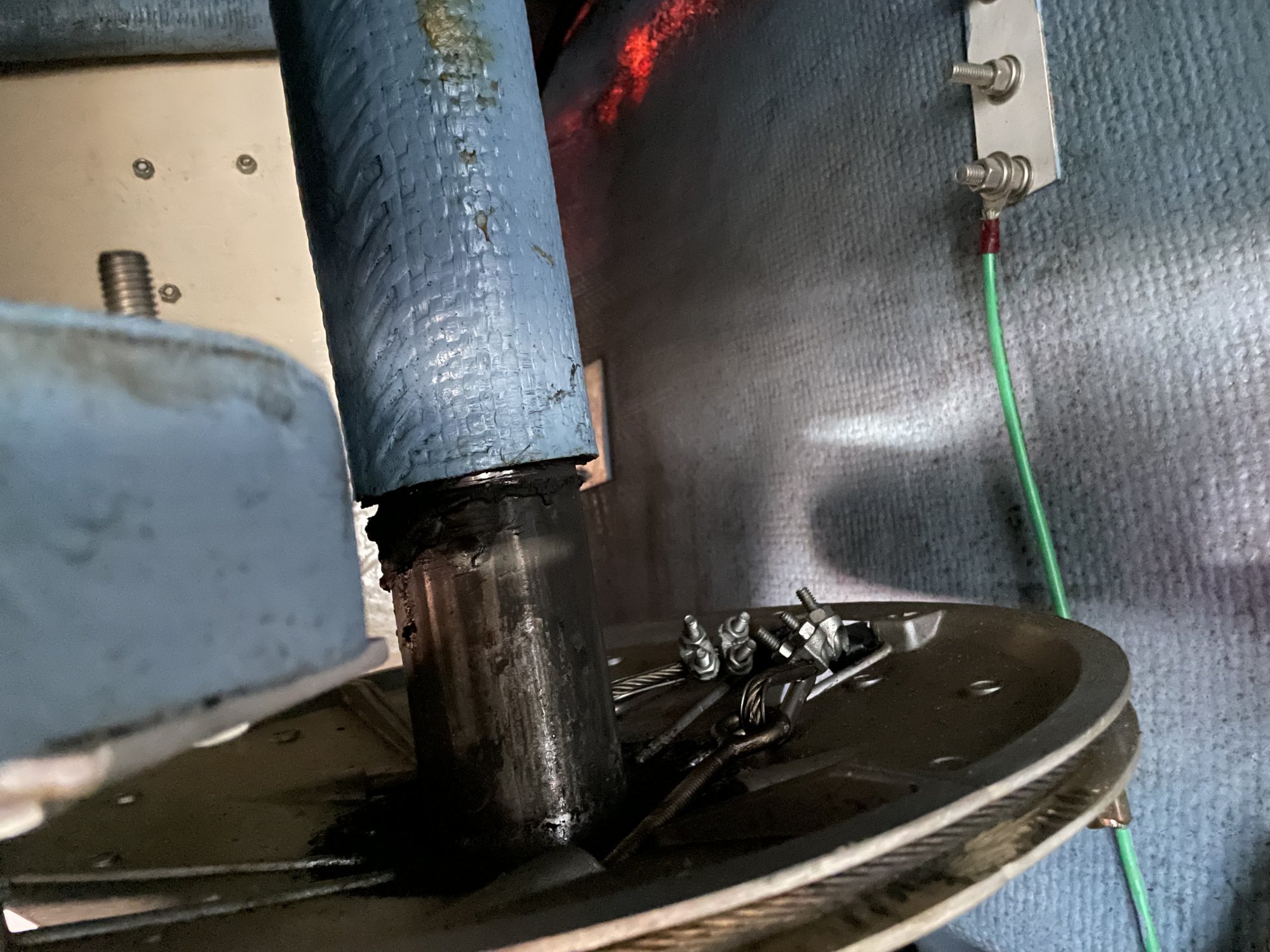

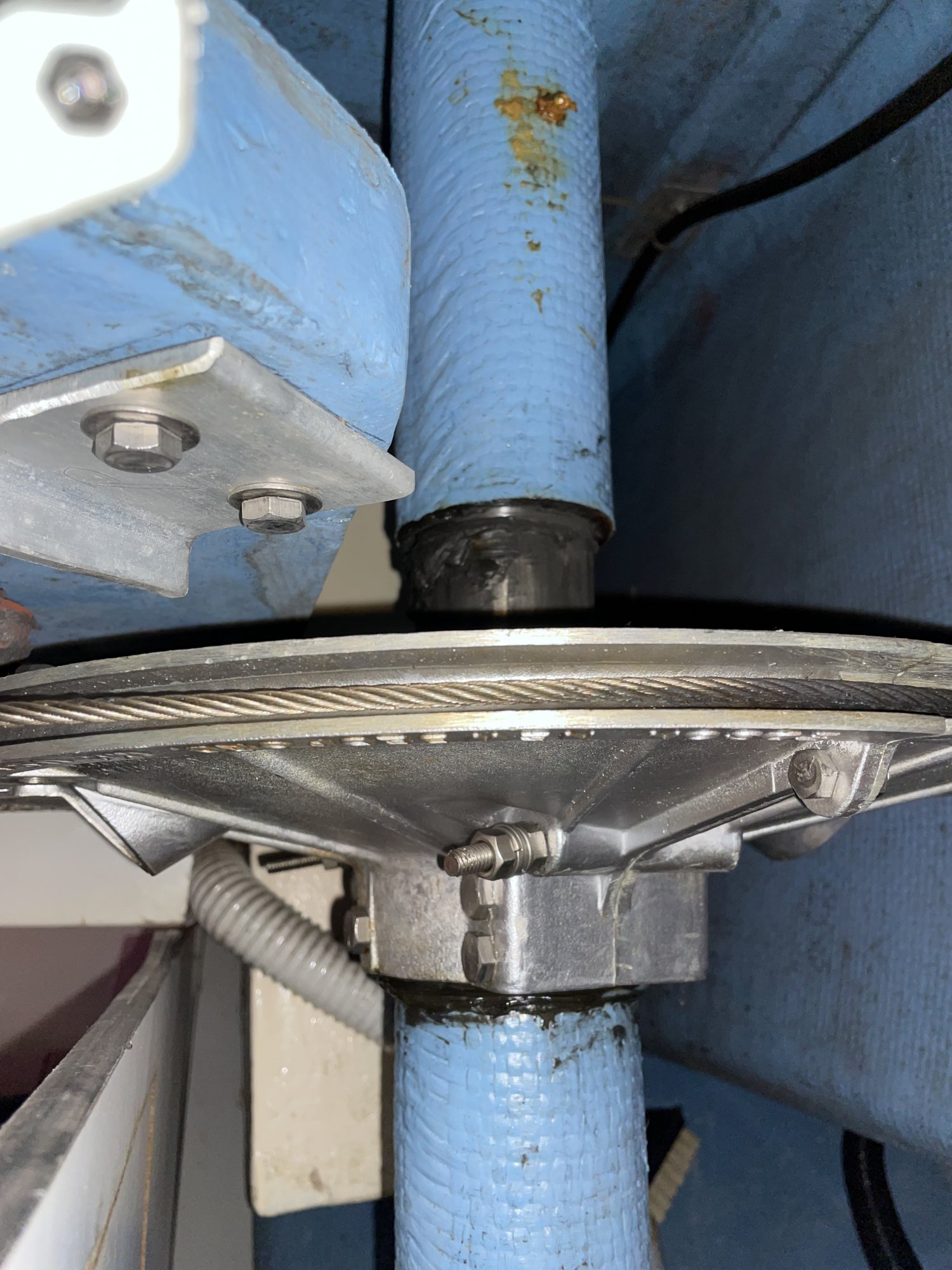

Jan 7, 2011
6,017
Oday 322 East Chicago, IN

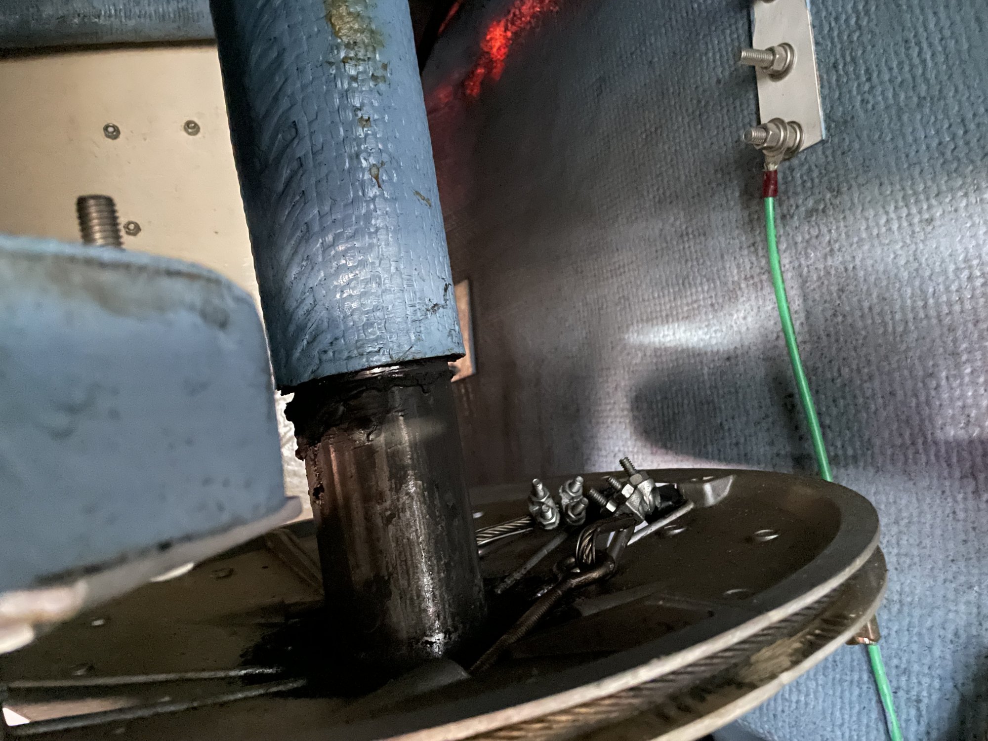

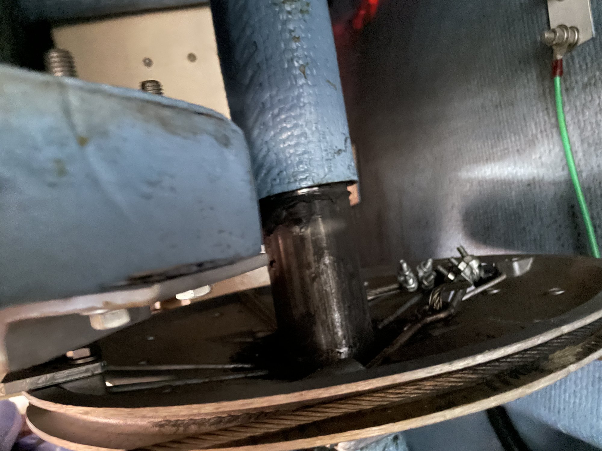

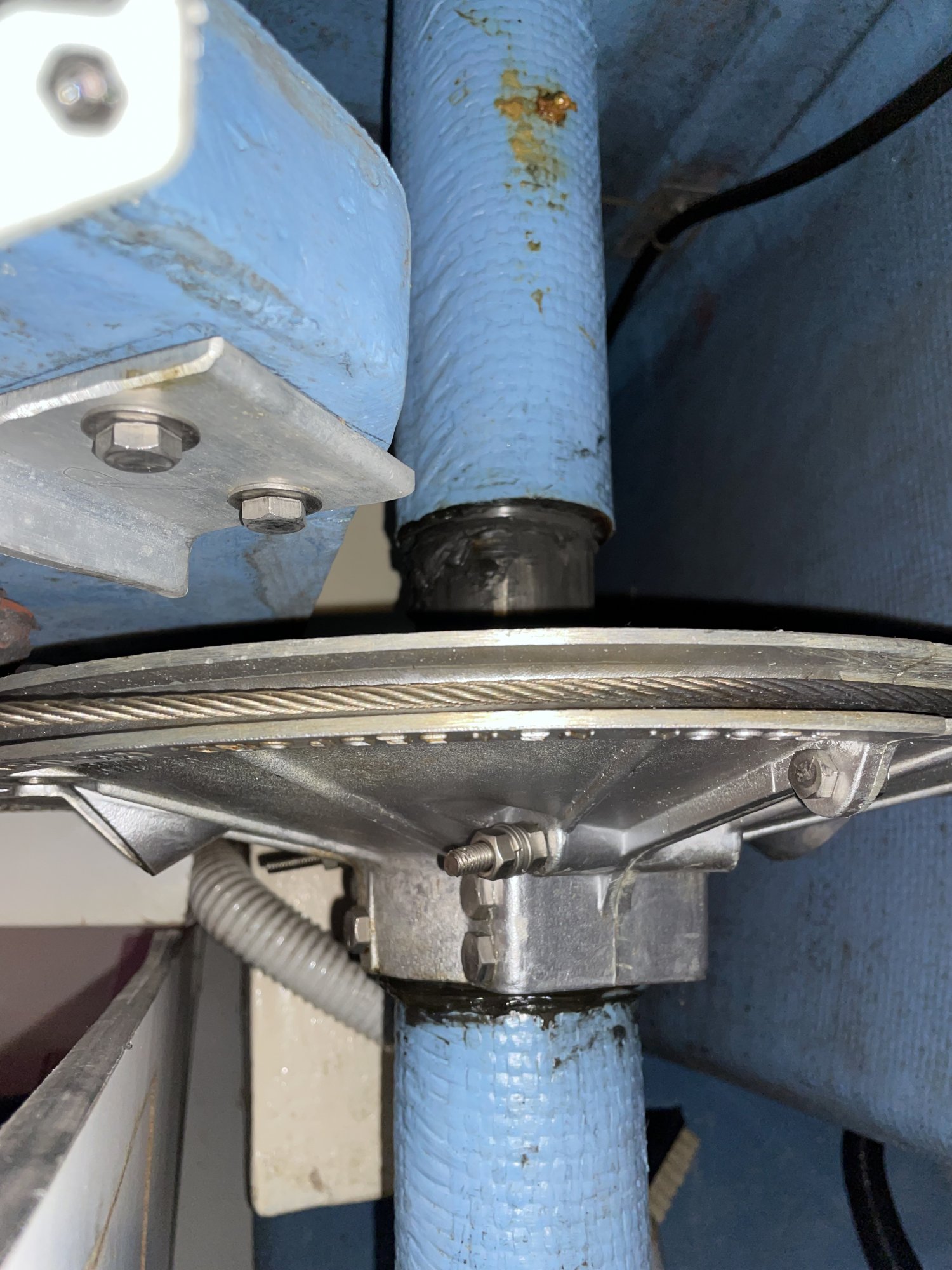

Here is what the rudder tube looks like on my O’Day 322. Not sure how similar it is to the O34…
F4E09F8F-895F-4B9A-ADE6-7F9666471A6A.jpeg 87FB579C-603D-4F8E-9FC2-ECB909AA0A2E.jpeg 7DB0AD00-545C-401D-BCEE-37124741BFAC.jpeg
I added a rudder sensor that is attached to the steering quadrant (no significant force ).
I do have some room above the quadrant to attach a tiller arm if I ever want to go with a below-deck AP.
Greg
Likes: Stargazer79

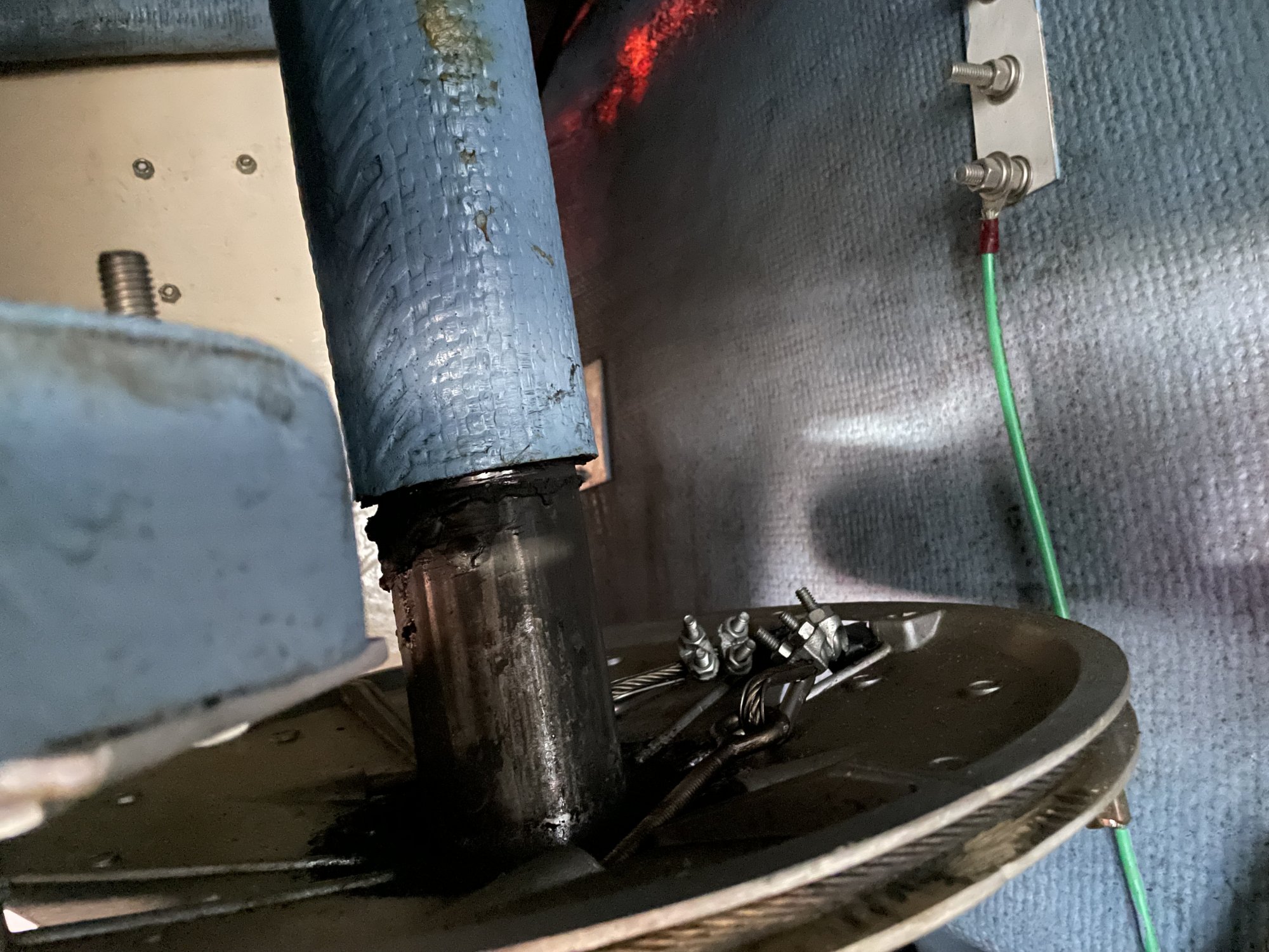

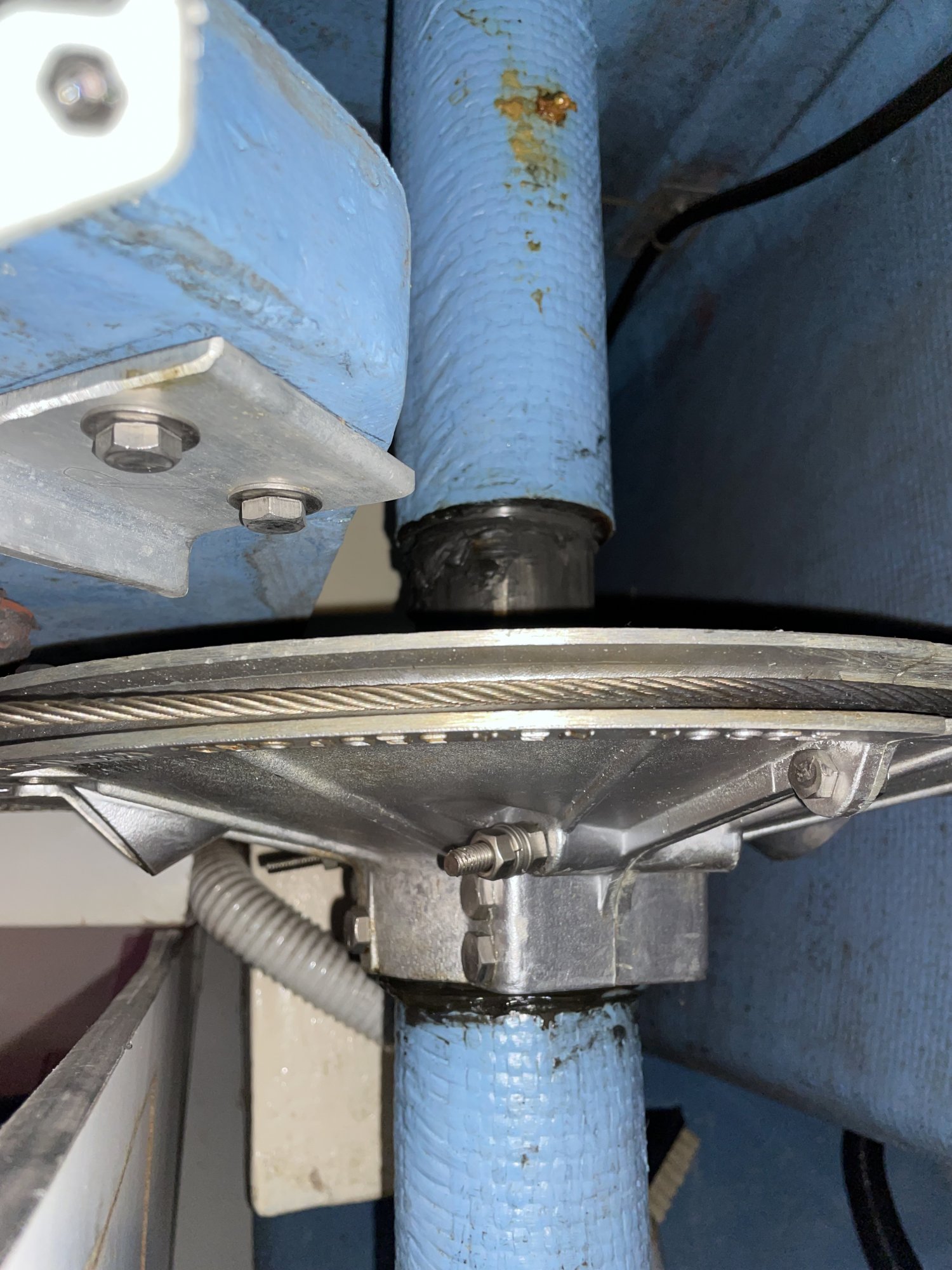

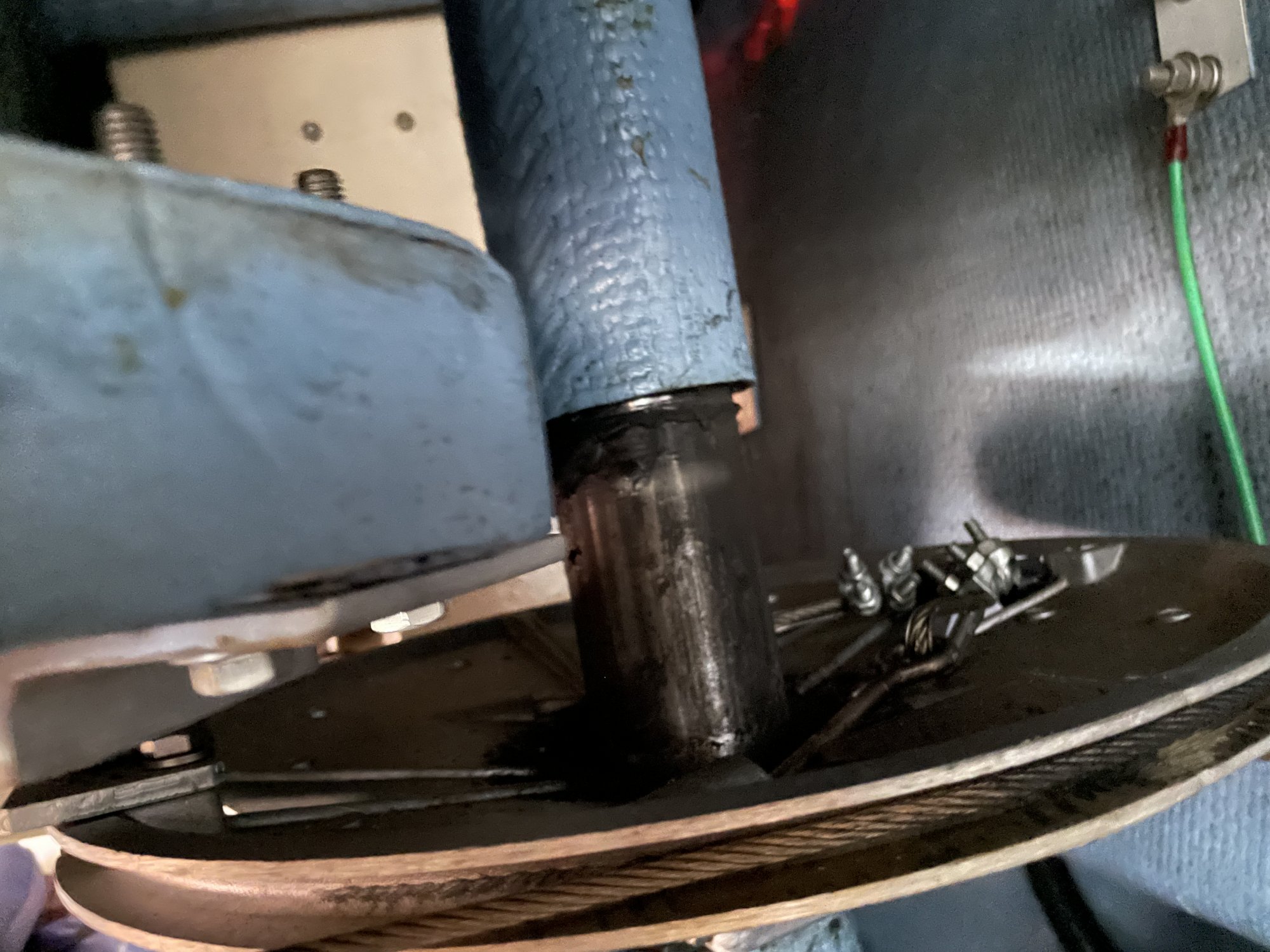

Apr 25, 2022
7
O'Day 34' 1984 Joe Wheeler State Park Marina
View attachment 213721 View attachment 213722 View attachment 213723
Greg
Very similar, it looks like the auto pilot arm is going to need about 2 to 3 inches of visible shaft, and I want to cut the fiberglass sheath away right above my quadrant. Just want to know if there is anything behind the fiberglass until I get to the shaft.
Jan 7, 2011
6,017
I guess you can’t see any section of bare shaft, to see if the tube tight on the shaft? I can see mine is tight, and no room for anything but the glass tube…
