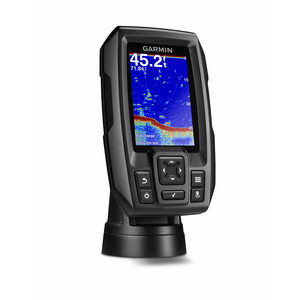

This Garmin
GARMIN STRIKER™ 4 Fishfinder/GPS Combo with Dual Beam Transducer | West Marine

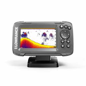

or this Hook
will do just fine. You can see on the Garmin that the most important information (the depth) is represented as small figures tucked away in the top corner. The Hook will be the same.

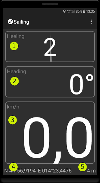

As for speed, I use the Boat Speed app on my phone.
Free, only needs a GPS connection and has BIG figures. Heeling (not necessary ) can be canceled and you end up with what you need. Also has a audio setting and a little lady in your phone will tell you your speed.
