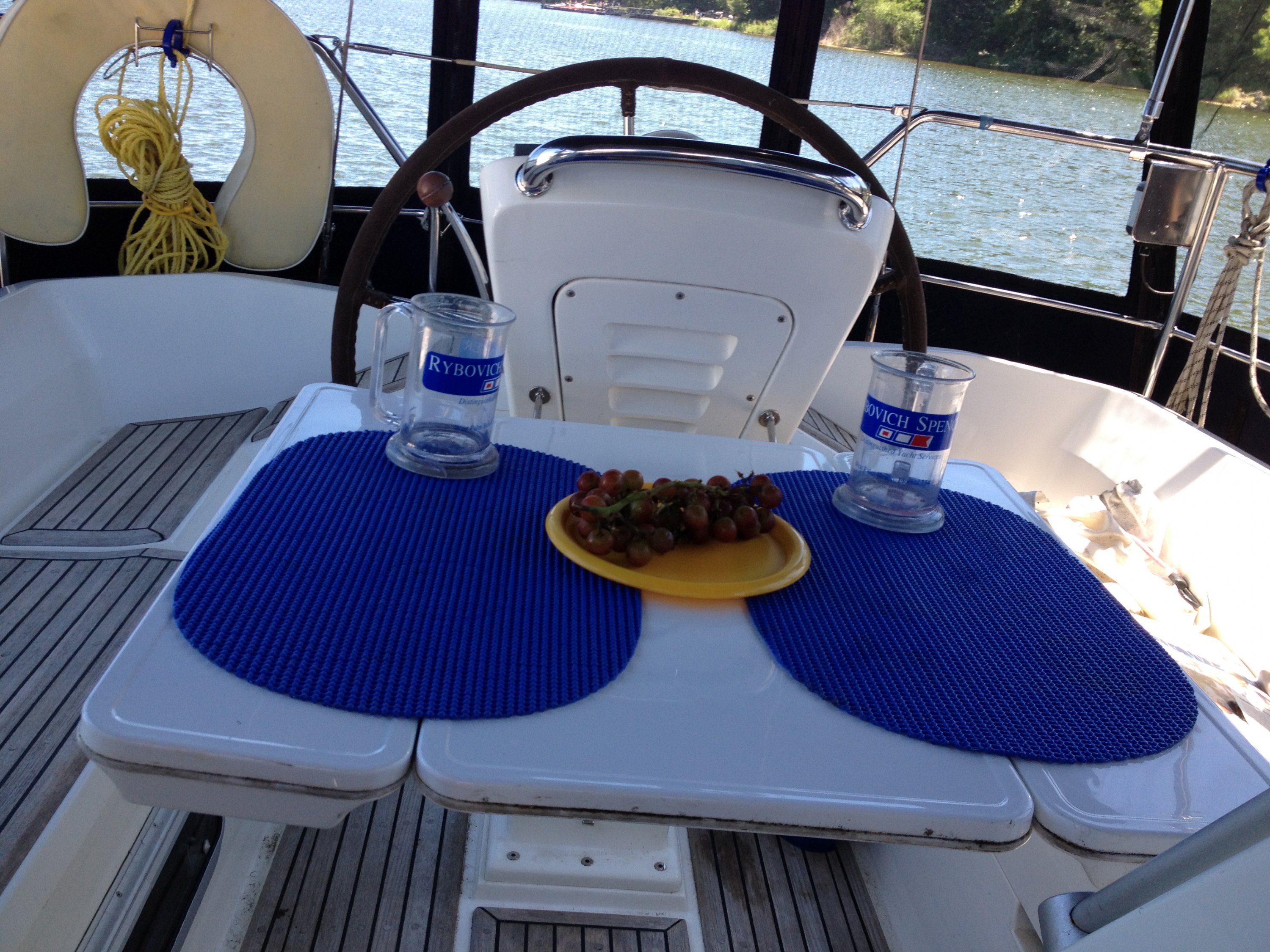

We went another way.
Screen sections for our cockpit enclosure - zip in to replace the side (2), aft center and fwd center dodger panel. Also great combo for our trip down the ICW. Chilly mornings = "hot house ", us in tshirts, others in sweatshirts. Also comfortable cocktails or sleep in cockpit
