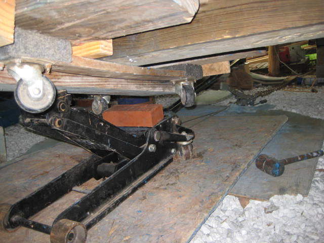

keel ordeal almost over
Keel back in, just touch up skid marks and bottom edge and finish.
I haven’t been this excited since my forth divorce… yippee!
Notice the washers made from sherbet lids, (I don’t drink milk). Starboard is double port is single. I hope that still gets me a Neill Award.
I followed Stingy’s torque specs of 12lbs. that seems lite to me but he has it well backed up from the “Engineers Handbook”.
I am still concerned about where / how to attach a keel zinc. I would try the remote connect if cloud and or stingy would share the details.
I could mount a fresh water one for the summer then I can change it if I make it to the Gulf next fall.
