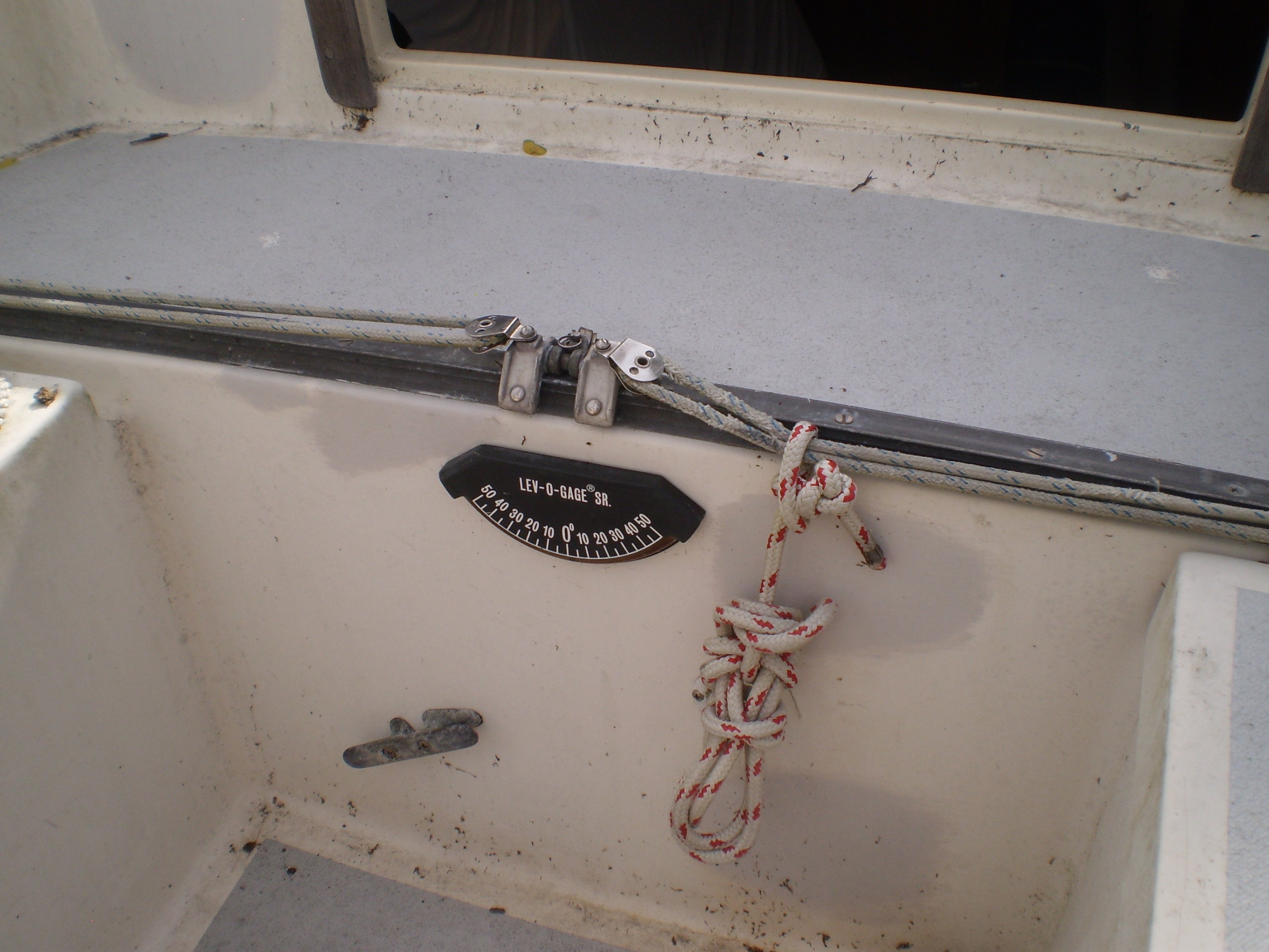

Here is a photo showing the mainsheet attachment to the deck mounted traveler on my 25. My traveler car has screw in pin stops. Really a PIA so rarely did I move the traveler. I ended up with a Harken setup. Much nicer if your going to regularly use the traveler.
