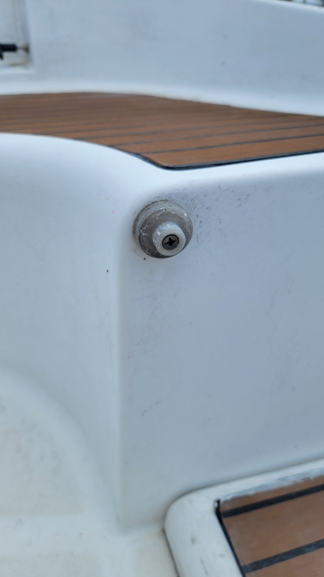

Hello,
I am looking for a part that is missing from my Beneteau 331 2004. It's a plastic thing that allows the seat to stay up or to slide it down to the floor, to allow walking out to the sugar scoop. Maybe through the attached photo somebody can help me identify what it is. This picture is from the port side. The left side one is missing. I am trying to find a spare part but I do not even know what that piece is called.
Thank you very much!
Gerardo.

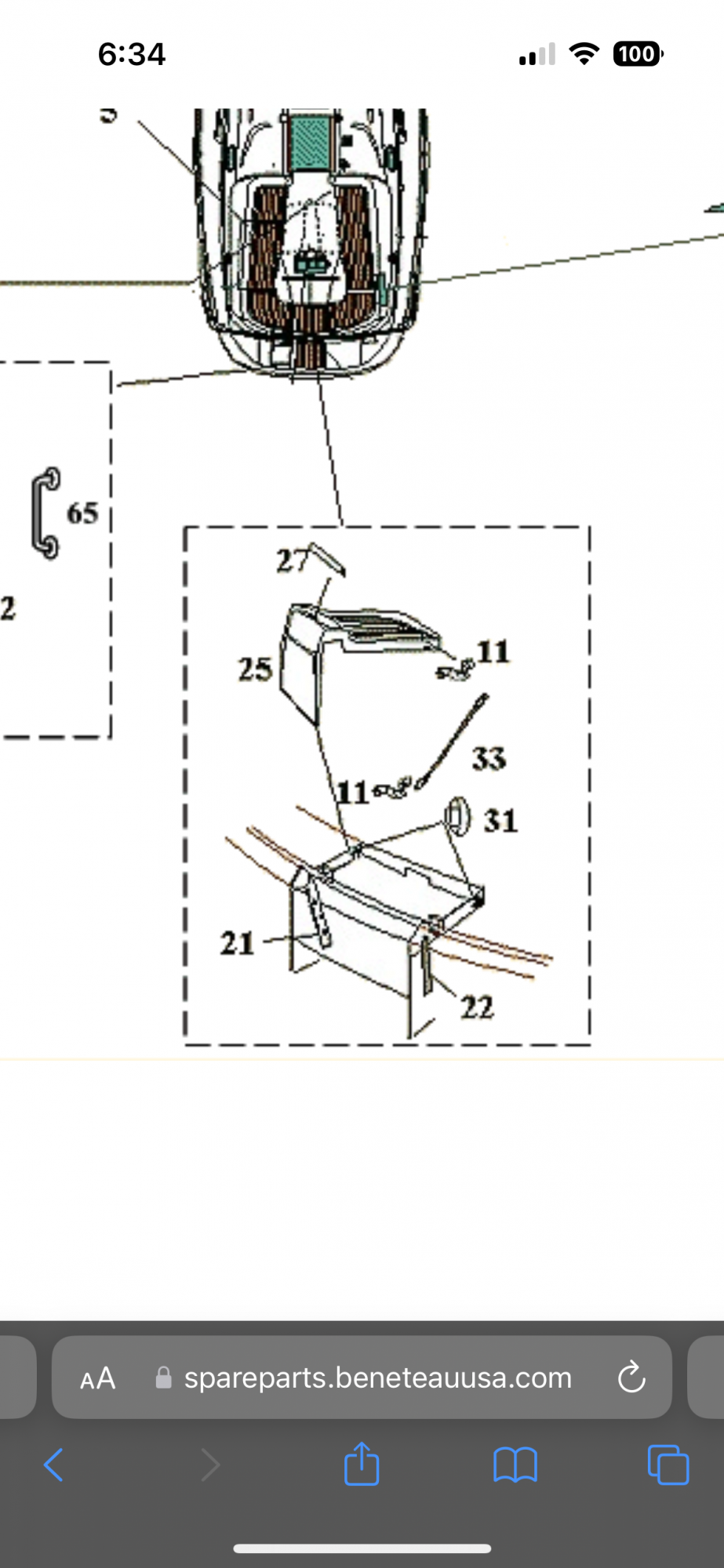

Is it part 31 from this picture?
If so it’s the “SUPPORT NYLON HELMAN SEAT”, part 041942 available for $9.56 from https://spareparts.beneteauusa.com/. You’ll need to reach out to a dealer to get credentials for the site, and that dealer will fulfill the order once you place it.
