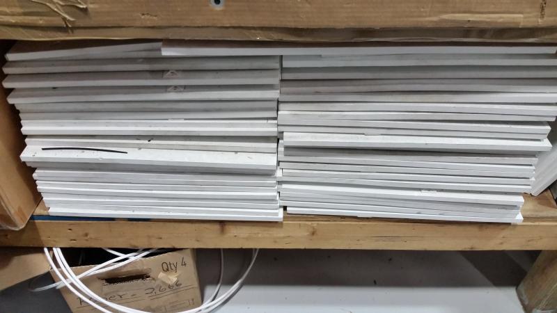

I have access to 1/2" expanded PVC board scraps through my work.
I was wondering if I used this with epoxy, and routed it smooth with the port opening, if that would work?
What do you think?

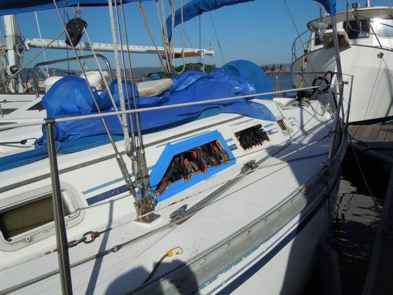

1,715
Hunter 34 Alameda CA
What do you think?
That's good stuff. Bonding pieces in then routing to the correct opening size should be a really good repair. From the picture, I hope you have enough. :D
Make sure to mask plastic down everywhere inside and out as you will find the drippage factor to be quite significant.
You can see in my picture I clamped all the way around the perimeter of the opening when I replaced my fixed portlights to bond the skins to the core. I did not have nearly the rot you have found, but so far that's only on the port side and I still have to address the opening ports.

So as suggested I was going to fill the gaps in the port openings with the 1/2" expanded PVC board from work, but I tried a test piece, and it was bowing the fiberglass. It is slightly too thick.
Looks like it is going to be chopped fiberglass mat and epoxy resin. I picked up some of the mat below this evening.
