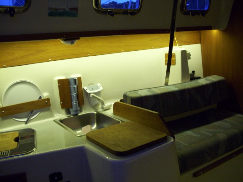

Also, some LEDs are dimmable. When I have them all blazing at full throttle, the cabin lights draw 2 amps. But if I'm nursing the batteries for some reason, I can turn them down to about 0.25 amps and still see well enough to get around. I also put a couple of red ones on a parallel circuit for night running. Turning both the white and the red ones on at the same time makes a rather warm color.

You know it's rarely mentioned but my limited experience with LED bulbs has led me to the conclusion that not only do LED bulbs use less power and last longer but for whatever reason, light sensitive bugs are not attracted to it. My neighbor installed one on his back porch and it dawned on us that we weren't bombarded by bugs like before when we hung out in the evenings. I put cheap LED lights in my boat and it does seem to help. I agree the ultra white color is hard on the eyes tho. Maybe there's a lens filter available
