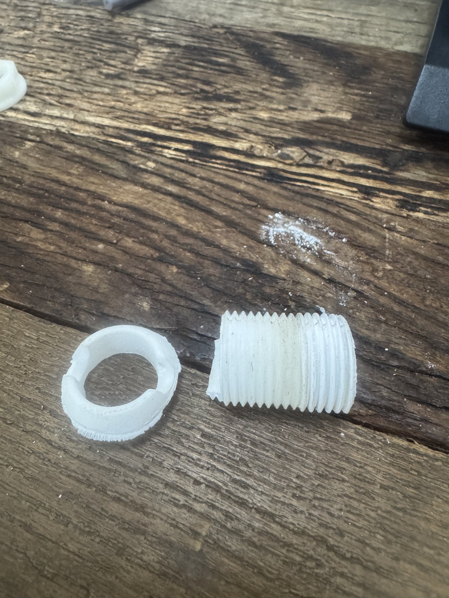

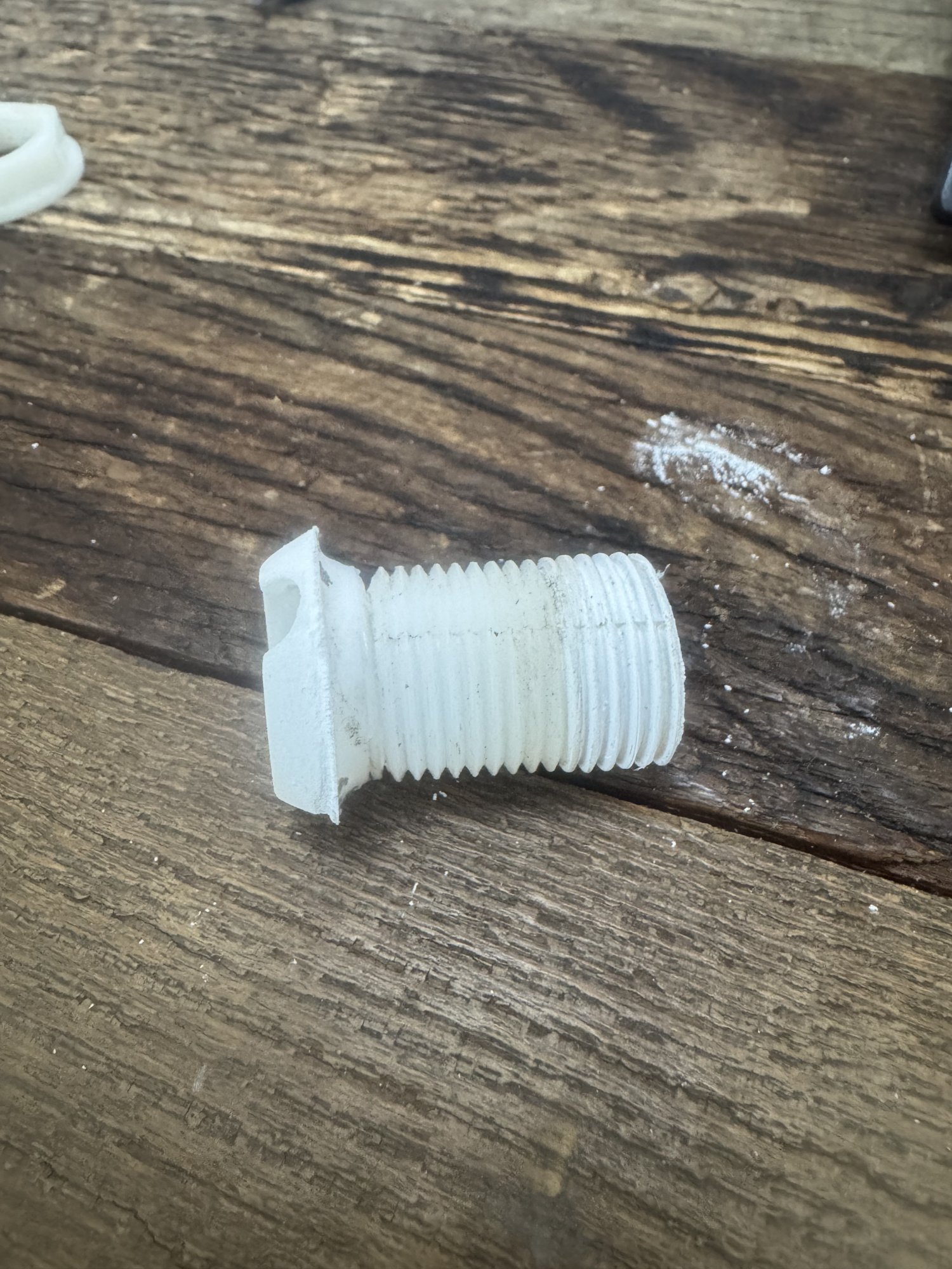

Hi All,
I am looking for a thru-hull
1 inch diameter
1/2 inch pipe
2 inch length
NPT
I can't handle anything bigger than 1" diameter.
It is to vent my waste sack.
If you have seen one, let me know.
If you know the terminology to find one online that would help too.

Hello Peggie,
Hope your day is going well.
Loved your book, helped me re-do my plumbing and for my boat to no longer stink.
I have a new IMTRA Nauta 35.5.
It has a vent for the holding tank.
The vent is 5/8"s
The vent goes up the hose to a Barb to NPT 1/2"
the barb2NPT goes into a 1/2" knee
The knee attaches to the thruhull.
The thru-hull is what broke.
It is plastic and sun degraded it.
The "Diameter" of the mushroom on the outside of the boat is 1"
The pipe itself is 1/2" inch
the length is 2" inches.
I don't seem able to find any mushroom thru-hull that is 1" in diameter.
They all seem to be 1.5 inch or more.
So that is my issue, finding a thru-hull.
In the meantime I have ordered a regular one I could find which is 1.5" and will dremel it to make it fit
but obv won't be pretty.
Unrelated, any recommendation between the plastic and the metal ones ?

Hi Peggie,
Hope all is going well.
I put
Forespar Thru- Hull Connector 1/2",Series 251
The outer circle on the outside was 1.5 inch and it fit.
The item was .8 inch width which fit my hole on the side of the boat.
and the inside is 1/2 inch.
This all went to a 5/8 hose
then to the FTPE300 vent which is on my Imtra Nauta flexible tank.
What you are saying is that 5/8 is not so great and I might as well replace it with a 1" vent line or more so I can vent the tank better ?
The hose nozzle backflush I already do that as it was in the book.
Thanks
