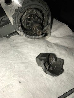

I have a 1990 Yanmar 2GM20F. I've owned the boat for two years. The old starter was an ARCO. The nose housing broke off so I need to replace it. I'm looking for a well made unit that won't give me the same problem. There are so many options on-line that it's confusing to a novice like myself to know a good brand from a not so good. I'm looking for suggestions on the better manufactures I should be considering.
Thank you.
Jun 3, 2004
418
Island Packet Island Packet 29 West River, MD
The cone side has broken off so I don't think that can be re-built. It cracked into three pieces.

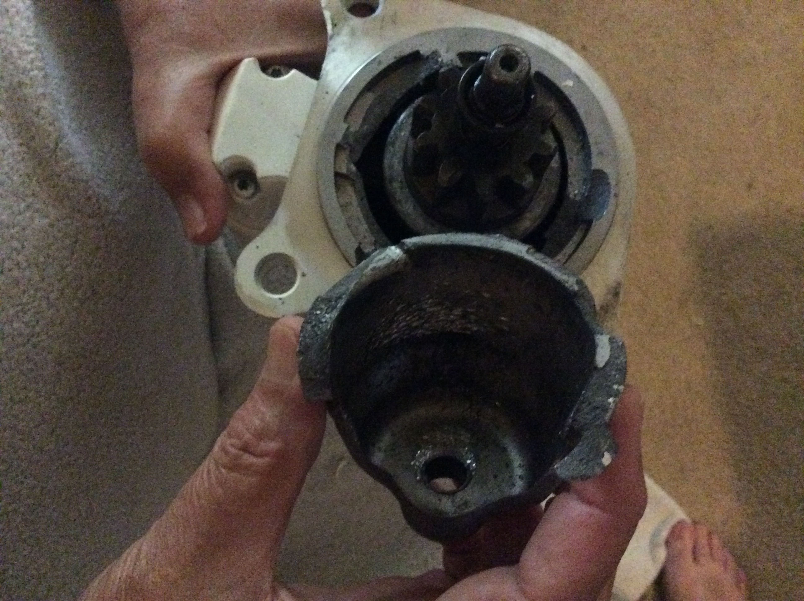

I just found my starter nose picture of the failure.

@Joe Mullee you picture looks like my failure mode.
@seadaddler et al...
The fracture is in a CAST house and very tough to weld.
Agreed that the motor and bendix is still functional, but the Housings much match.
Jim...

When I see the nose busted off of a starter like that, the first thing I want to check is the ring gear. If it is not concentric when it spins or if it is not spaced correctly, you may have a serious bearing problem deep inside the motor block.
Jan 25, 2011
2,439
S2 11.0A Anacortes, WA
I would think that would be a “really serious” issue with a bearing. You would know it when running. I don’ think the gear lash between the starter and ring gear is nearly as critical as a bearing clearance. The ring gear itself could be an issue though..just my $.02 worth..
May 20, 2016
3,015
I’ll go with the backfire diagnosis. Wouldn’t hurt to have mechanic check valves and compression.
JamesG161
Feb 14, 2014
8,105
Hunter 430 Waveland, MS
From other SBO posts, I have heard more of Carbon Deposits in the riser, restricting a start.
Although that was NOT my problem.
A partially restricted exhaust, basically puts more back pressure on the starter.
Large strain on the starter, SNAP, breaking the weakest part, the nose casting.:yikes:
Jim...
May 24, 2004
7,228
CC 30 South Florida
Chances are the bearing on the starter was worn causing wobbling on the shaft and the longer than normal starts. It looks like the after market starter worked well for the two years you have had the boat and for an unknown period of time for the PO. Before I would start looking for causes on the engine side I would take my chances and replace the starter with another after market unit. It could be a starter manufacturing flaw. I would not incur in the expense of an OEM unit just in case there is a catastrophic engine problem. It could very well be there is a problem with the engine that will cause it to wear the starter bearing down over a period of time but then if you get a few years out of the replacement it might not be worth it to enter into an engine repair. I know I'm advocating for probabilities instead of sound diagnostics but the thing is that without further evidence of a problem you could be looking for something that is minor or not there at all. The presence of a catastrophic problem would become evident sooner than later and would damage an OEM starter the same as an aftermarket.
