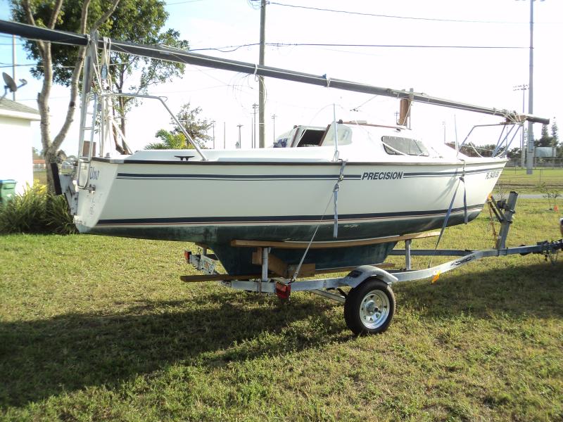

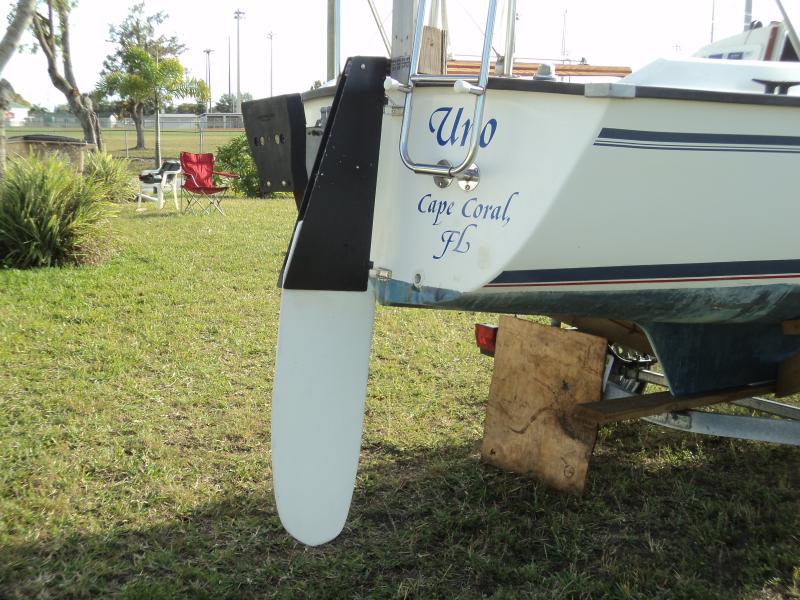

That Precision has a lovely stub keel that will respond very nicely to a "V" shaped attachment between the bunks and the keel support. The front of the keel will slide into the "V" shape and (believe it or not) the rest of the boat will center itself on the trailer like magic. I'll try to post a picture of the contraption I put on the trailer for our P-18. I used a pressure treated 1 X 6, two strap hinges (so getting the angle correct was a no-brainer), and two "U" bolts that attached each 1 X 6 to the aft support for each bunk.
If you need more pictures or want a more complete explanation just email me.
Phil
OOPS, I did not add that there are white starboard pieces added to the keel board and to the bunks. Those made pulling the boat onto the trailer or sliding it off a simpler job too. I did need to use care when launching because I believe the boat could have slid off the trailer if the winch cable and the safety chain had been loosened too soon.
RE: the boards shown a few posts down from the Precision site.......I only used one board on each side of the trailer and that worked fine. I think the boards in the Precision site picture are added at several places along the bunks. That would only be better in situations where your trailer was submerged quite deeply at a steep ramp. I always submerged the wheels and fenders, but tried to limit how deeply the trailer went under. The starboard slides allowed the boat to be pulled onto the trailer with the winch. That would be more difficult with the weight of the 23. Do I see a power winch under the Christmas tree?????

I agree.... this is a much better method than the goal posts. it is also better looking, longer lasting and much more durable.....

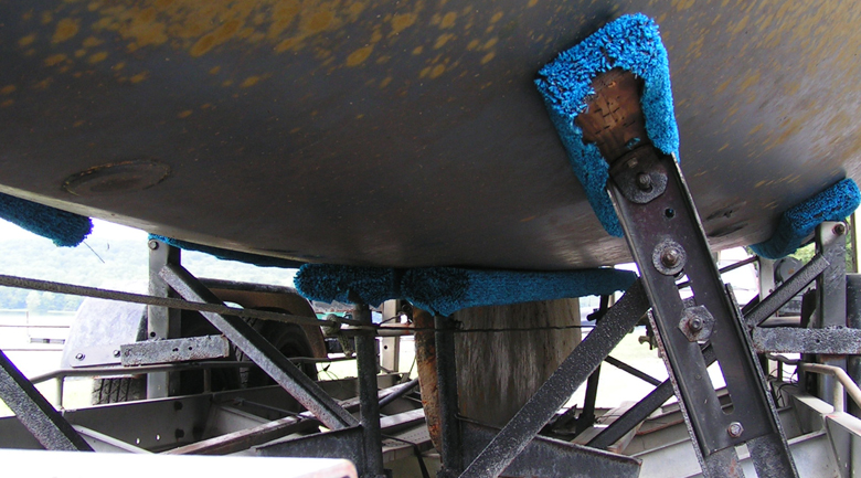

HIGH keel guides
Keel guides is the way to go. Positioning the keel makes is much easier to use than hull guides and also looks much better than those post sticking up like the stink boats.
The only problem you have with keel guides is how deep you place the trailer into the water at the launch ramp.
If you have rollers on your trailer instead of bunks then placing your trailer in shallow will work to winch the hull up into place. Low guides will work fine such as fasttaker372 photo is showing.
If you have bunks, then placing your trailer deep into the water is a must. Floating your boat on to the trailer is the recommended way because of the friction caused by the bunks and trying to winch all that weight up out of the water is very hard on the hulls bow eye and the winch. Now, when you have the trailer deep in to the water the hull and keel float above the low keel guides until almost in it’s final resting place, because of the ANGLE of the ramp. The precision owners site listed by Tom G, P-21 shows higher guides to slide the keel down into the lower keel guides as the hull moves forward on the trailer.
The overall best system is high keel guides, almost high enough to act as another set of bunks next to the hull, see attached photo.

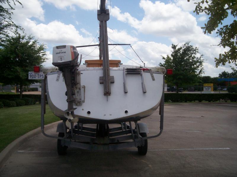

I built goal post out of 1 - 1/2 pipe purchased at Home Depot. Makes loading the boat a lot easier. The pipe is covered with 2" PVC and a line around the PVC where the water depth heeds to be to load. As mentioned earlier my keel guides are below the keel on some ramps and the goal post guide the boat over them. I do not have any photos at this time but will be glad to take some if you would like to see the set up I have. I have a wing keel so the guides I built are somewhat different.

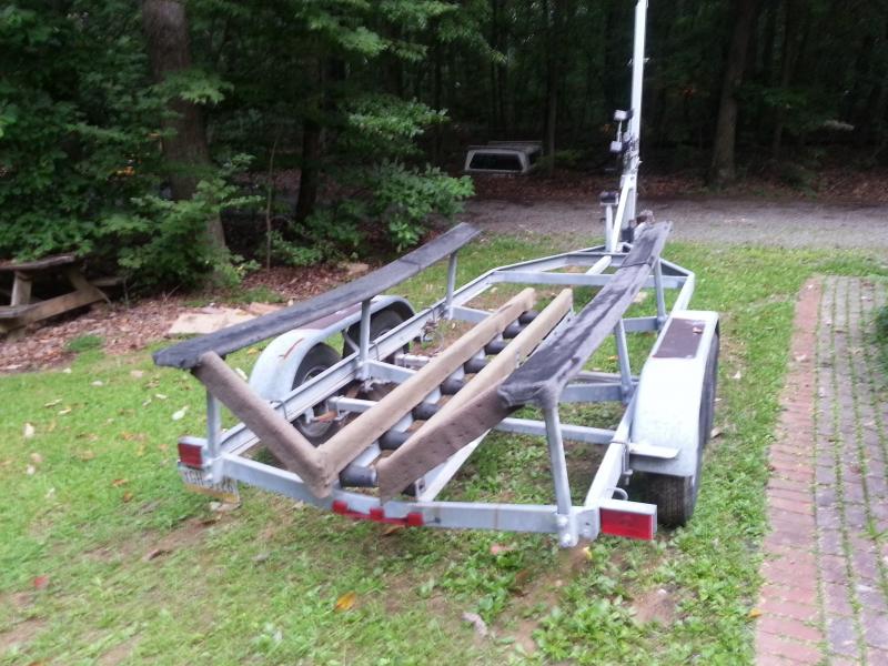

31seahorse, I like your method as pictured there, good design. For my O'day 22 I am thinking the angled board could be little longer and the resulting angle would be slightly less and the other board higher and little longer also.
