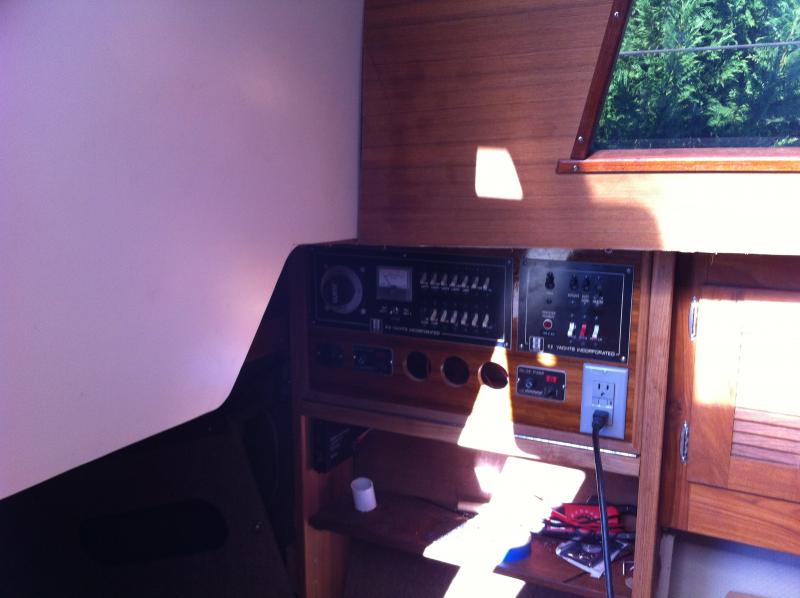

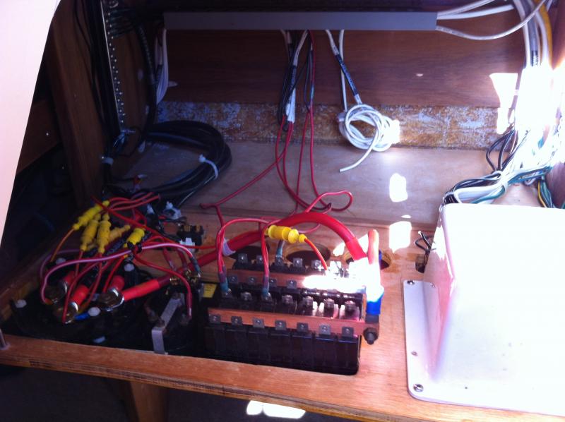

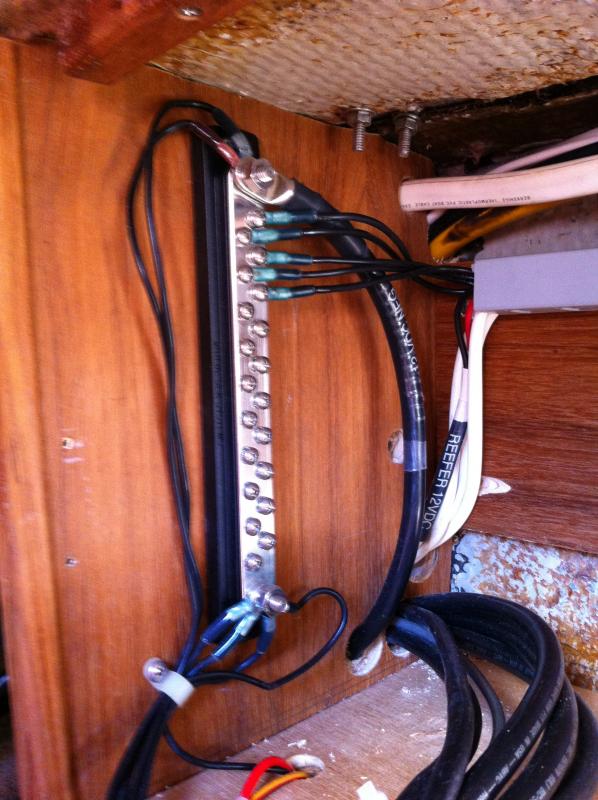

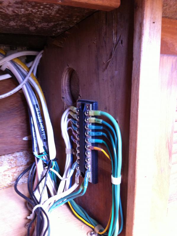

OK here ya go John... the pics of the electrical panel.... the first pic is of the 12 vdc buss bar...the second pic is of the 120vac buss bar.....the third pic is of the panel cabinet open...the fourth pic is of the cabinet closed....
regards
woody
