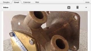

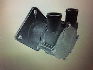

Im told its an Oberdorfer but I found a Sherwood that looks exactly like mine on Ebay at much less money.......any thoughts?
the pump on the right is my pump the pump on the left is the Sherwood I found on Ebay at a lot less money than from Onan........any thoughts..Im at a loss as to what to do........

Is this the one you found on e-bay? http://marineenginedirect.com/oberd...mqjMXTAuetKaswu6-oFnxCHTXnP928wwaAlksEALw_wcB It does list the model it applies to. Here is the one for an Oberdorfer: http://marineenginedirect.com/oberd...KmqjMXTAuetKaswu6-oFnxCHTXnP928wwaAlksEALw_wc Finally, here is the answer: http://www.pumpvendor.com/Sherwood_G905_G-905.html Of course, the best way is to take it off (or have it taken off) to verify before ordering, but I agree that it looks the same as what is in your photo. And, replacing the pump would appear to be the right thing to do.
BTW, I would get another impeller and gaskets if your decision is to buy that new-old stock. The impeller could be bad from sitting in that position a long time IMHO. Good luck!
