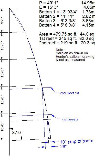

Don't understand your second posting.
If you are intending to cut 10' off the mast and still have a mainsail which is triangular then you must cut off an equivalent area of 10' off the foot.
Cutting 10' off the head and reworking the leech and batten pockets will yield the same result area wise - unless you are going to gaff rig!
My drawing of my main is attached.
10,206
Flat topped Main
Not uncommon on catamarans.. This type modification to the original main is used when masts are shortened.
