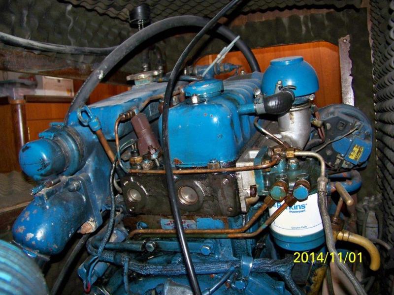

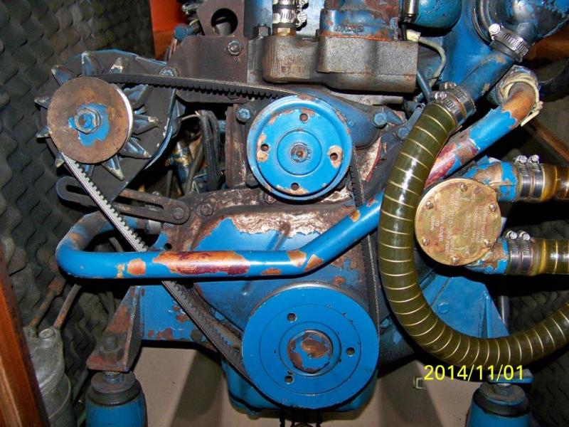

Our ‘84 Beneteau First 38 is on the hard. Another part of this year’s winter work is the Perkins 4-108 engine (only 2200 hours) which runs great but is oozing oil everywhere. It starts within a couple of seconds after engaging the starter motor and been very reliable. We only use the engine maybe 50 hours a year.
So far we have done the following:
- winterized sea water system with -100F antifreeze at haulout (just to be cautious as we did not have a firm date to pull the engine)
- confirmed that antifreeze in closed fresh water system was still good
- uncoupled shaft from HURTH gearbox, it was amazingly easy to remove all the bolts on the coupler after soaking with PB Blaster and then using a battery powered impact wrench to remove the bolts
- removed stuffing box type shaft seal
- removed shaft from boat with prop still attached; very little “wobble” was noted in the cutlass bearing, however we may go ahead and replace the cutlass bearing since the shaft is out
- removed alternator
This weekend we will:
- disconnect sea water inlet hoses
- disconnect engine exhaust gas/cooling water hoses and VETUS waterlock type muffler
- disconnect diesel fuel supply line tubing from 2nd filter that is attached to the side of the engine
- disconnect wiring harness
- use a wet/dry vac to “suck out” the -100F antifreeze from the sea water system
- unbolt the engine mounts
- remove the cockpit sole
- lift the engine out with a forklift and put the engine on a pallet
Once in the workshop we want to do the following:
- remove BOWMAN heat exchanger and clean – perhaps send out to a radiator shop for caustic cleaning
- remove cylinder head cover on top of engine – check condition and replace gasket
- remove timing case on front of engine – check condition and replace gasket
- remove crankcase oil sump on bottom of engine – check condition, replace internal filter, & replace gasket

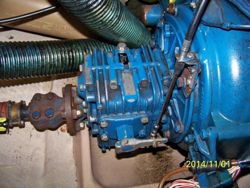

- remove HURTH gearbox – check condition & replace
- remove flywheel bell housing - check condition and replace gasket; possibly replace coupler internal between flywheel and engine drive shaft
- replace infamous Perkins 4.108 rear main seal – hopefully with something better than the original design
- replace all hoses
Being a frugal German engineer (who thinks he can fix anything) I would prefer to do all of the above myself. But, I must be getting wiser as I get older, and will probably be sending the engine out to a diesel repair shop. I am Chicago but have found the following two shops that are a couple hours drive from Chicago. Anyone used them in the past? Also, did I miss anything? My philosophy is that I only want to pull the engine once and better to do everything now.
