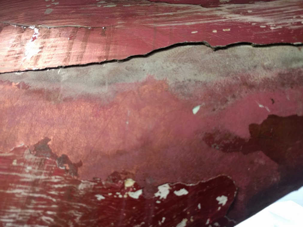

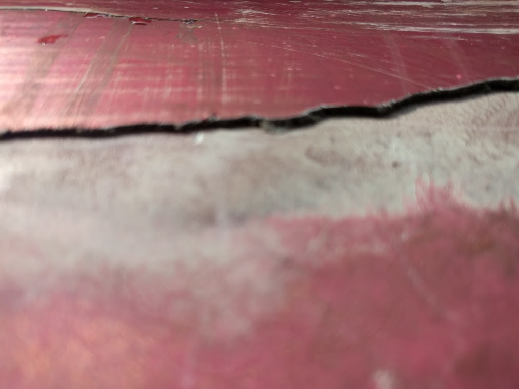

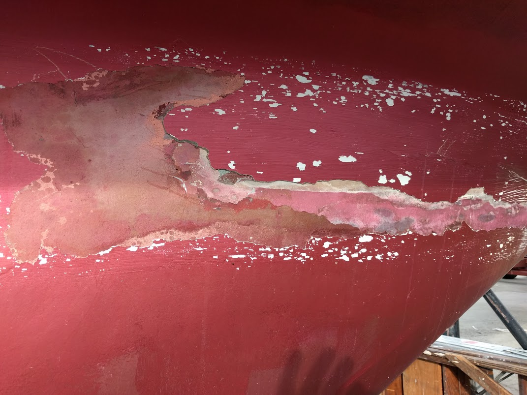

While attempting to chip away what I thought was some loose VC-17 from the front-side of the keel on my recently purchased sailboat Catalina 30 I got more than I bargained for. A long strip of material peeled off (approximately 6" wide by 36" long) . At the top side of this material the thickness is about a sixteenth of an inch thick - too thick to be paint. At the bottom the coating tapers down a fraction of that. The material is gray in color and has a rubbery feeling to it.
Any idea what the material might be? And more importantly and suggestions on repairing the gash in the images?

Could we see a picture? It could be Interprotect epoxy. However, PO's can do some kooky s$&t!!!
What do you mean by "front side?" Maybe the leading edge of the keel?
It could be that you need to grind it out to solidly-adhered material and re-epoxy the exposed area. Then repaint it.

There is a product called keep guard
What you described sounds like that.
You see it often on the bows of canoes as well as on keels of boats. Do a search on amazon or google it and see if the photo looks like what you just described

I think that looks a lot like a filler substance to blend and flow hull to keel. I call the putty fiberglass mix "Bondo" or body filler/putty that is used for this purpose. In this case I suspect, if I am right, the below surface is not roughed up and it did not bond properly to a smooth surface.

I'm not Gunni, however, I agree with Chief. It appears to be a poorly done fairing job.
The fairing compound looks too thick. With any movement in the hull-keel joint the fairing compound will crack. If it is a polyester fairing compound, it will also shrink slightly over time and that could contribute to cracking.
The first thing to do is get the crap off the keel so you can see the joint.
While the boat is on the hard you may want to torque the keel bolts.

the pinkish color certainly looks like Bondo, auto body filler...and it might look good for a month or two...not for boats.
Remove it all, and see what you have....a few pics of that "after" might help.

It looks like fairing compound: similar to Bondo but made for marine applications. There are a few products out there with different costs. I just used Quik-Fair and was happy with it. From what I hear, Bondo is red because of clay in the mix. The clay will absorb water and degrade your repair rather quickly.

Also, 3m marine filler is pink! Total Boat is dark green. Awlfair is dark red.
