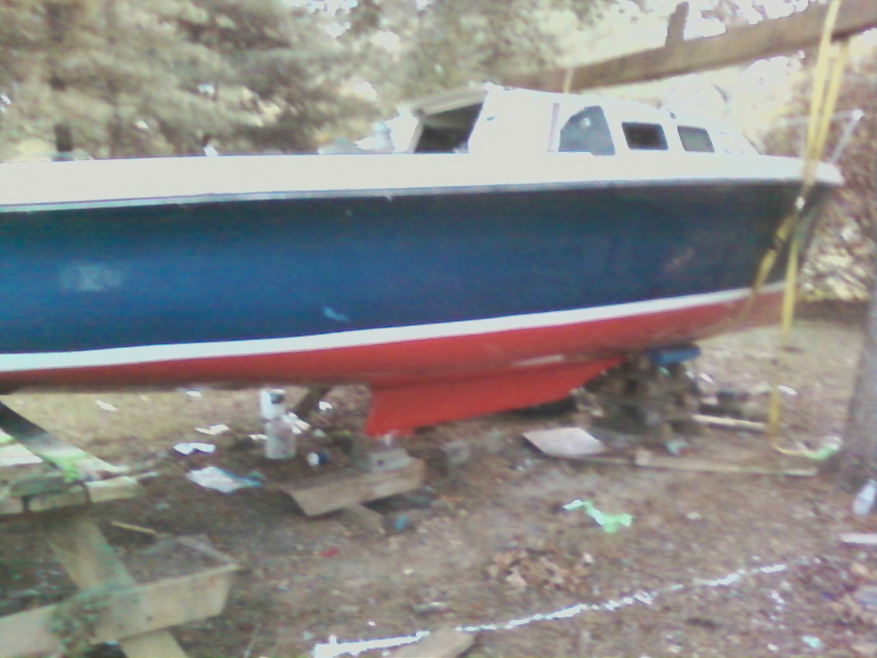

I have had very good results with oil based Rustoleum enamel. The best part about Rustoleum is that you can get an exact color match many years later so... touch ups are easy. The oil based is very amenable to the roll and tip meathod and self levels very well. Most of the work is in preparing the surface so spend your time and energy getting the surface ready and the paint job will be easy and come out nice.

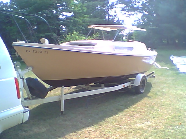

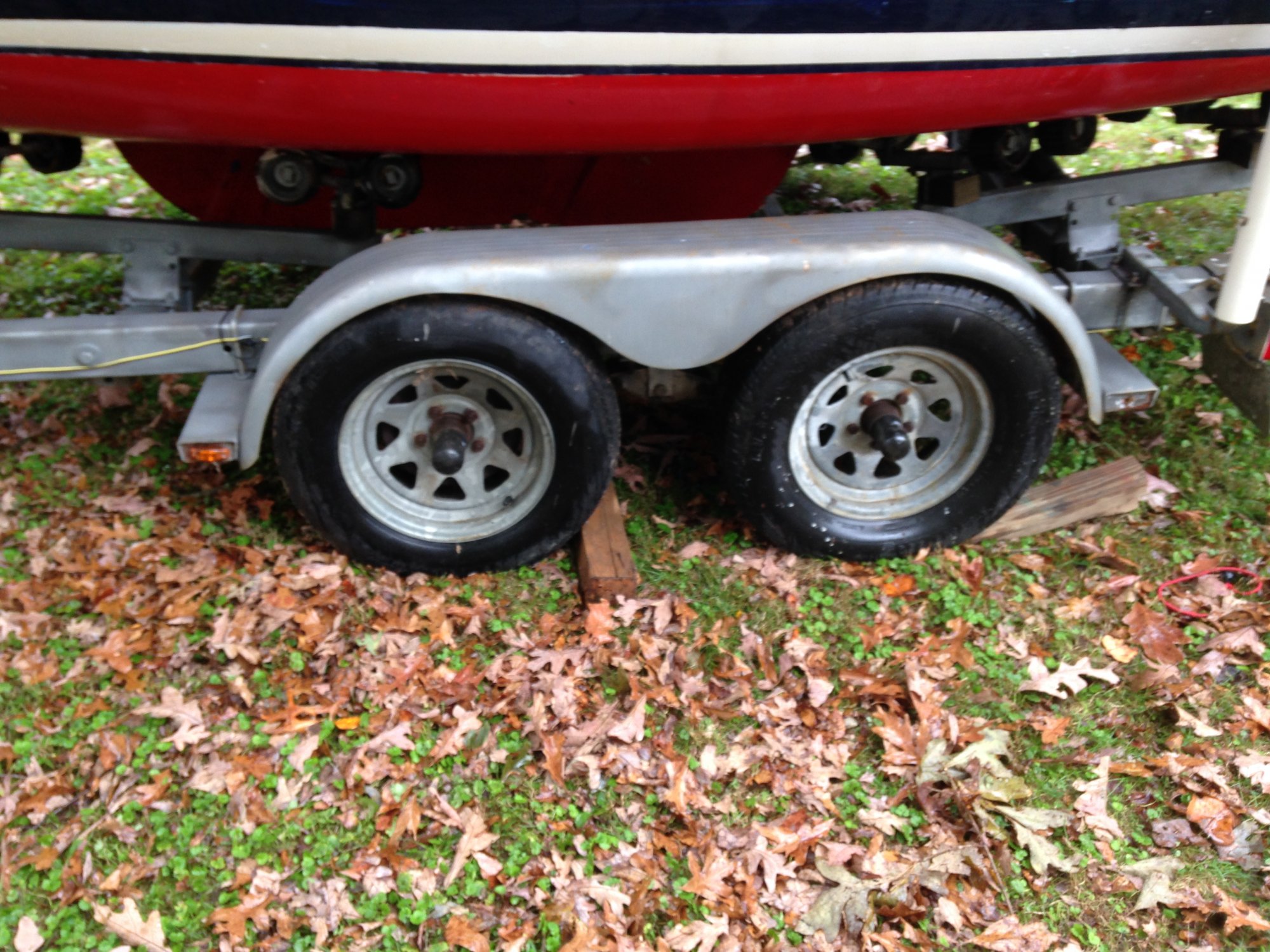

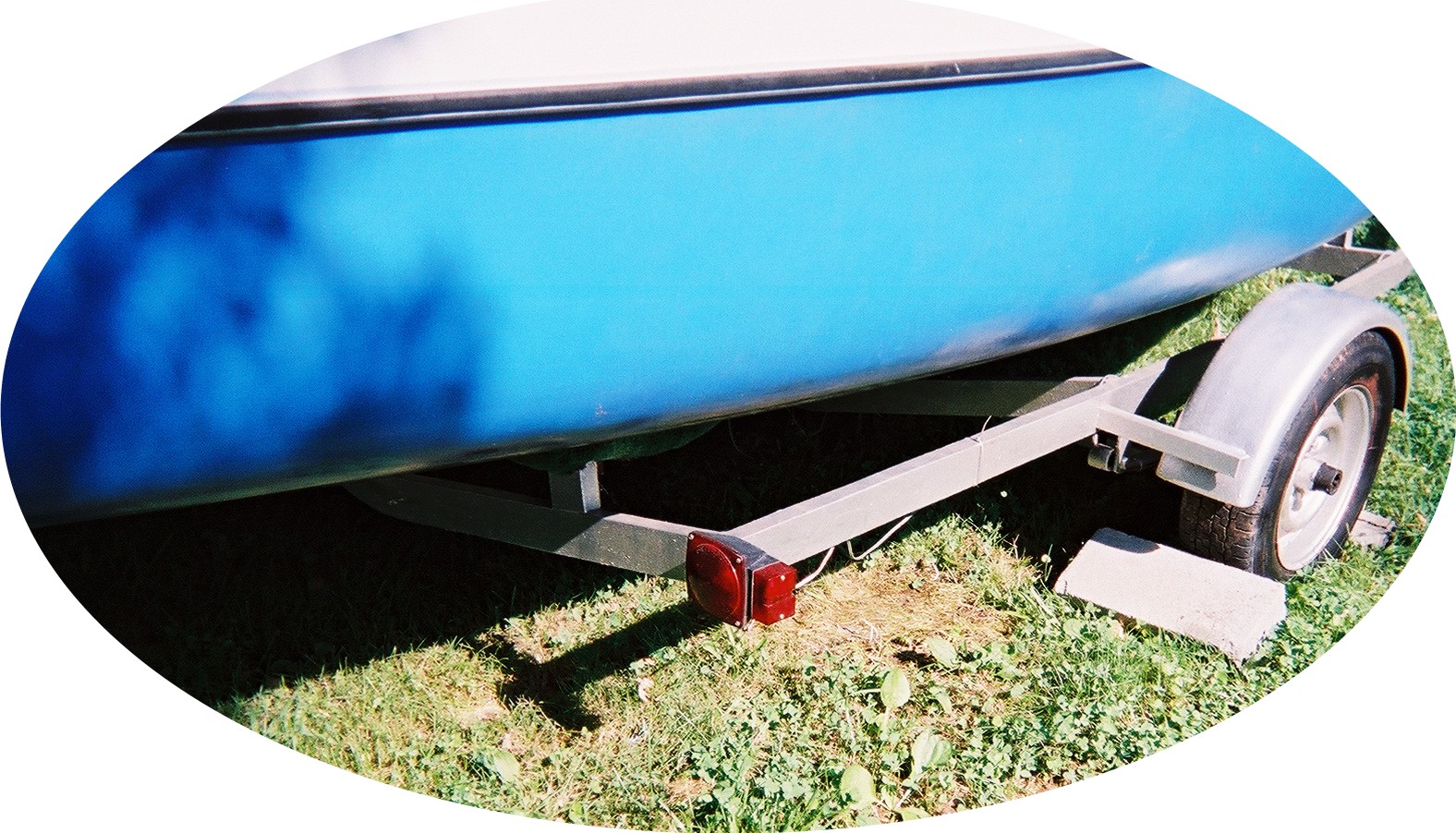

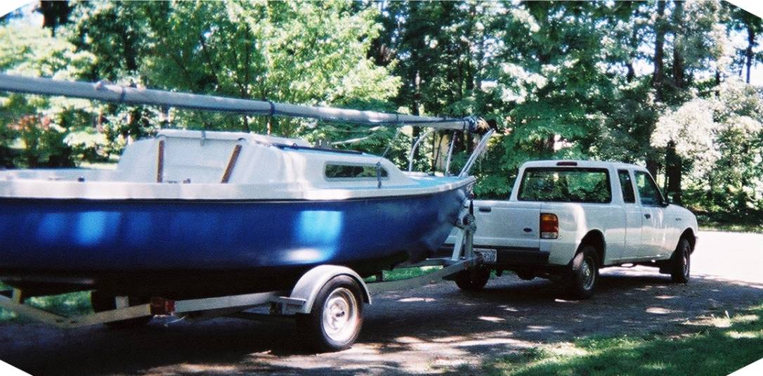

Here are a few boats I've painted with rustoleum..
The red bottom and white boot stripe of this Balboa 26
This Macgregor 21
The red bottom and boot stripe of this Rhodes 22
The tan and brown colors on this Macgregor 22

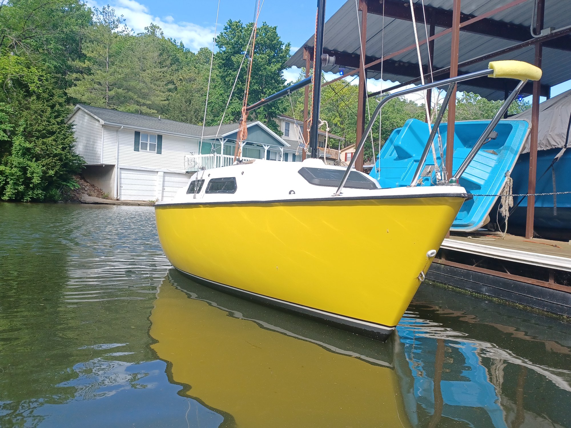

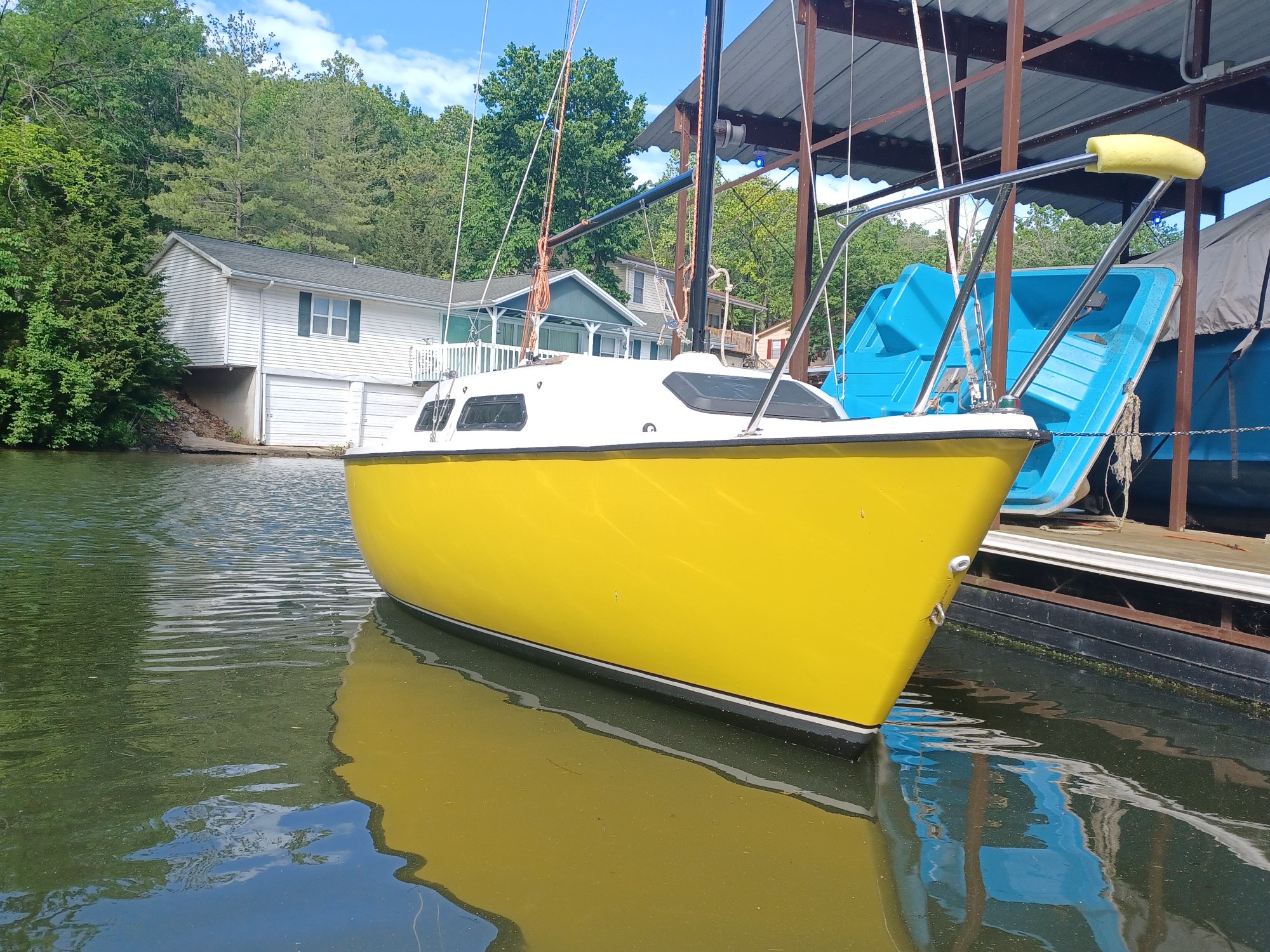

Some may say no, but this is VanSickle tractor paint from orscheln farm and home. Applied with a foam roller and tipped with a dry foam roller.
Cheap boat, cheap paint.
