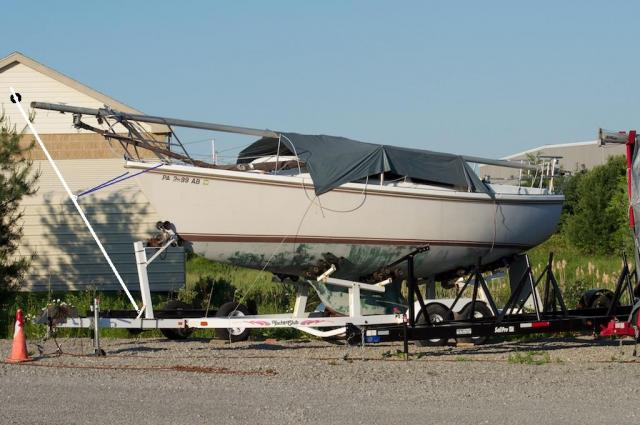

Take a look at this YouTube video, and then the written instructions... Hopefully this helps. I have not done this, but intend to when I step mine for the first time...
http://www.youtube.com/watch?v=vpFhnYQmRYs
http://catalina27.org/SN-FTP/mastraising.jpg

It is much simpler using the boom as a gin pole if your mast is hinged. We did it on Novelman's Lancer. If your base is not hinged you'll have to make a hoist like the one in the video.
