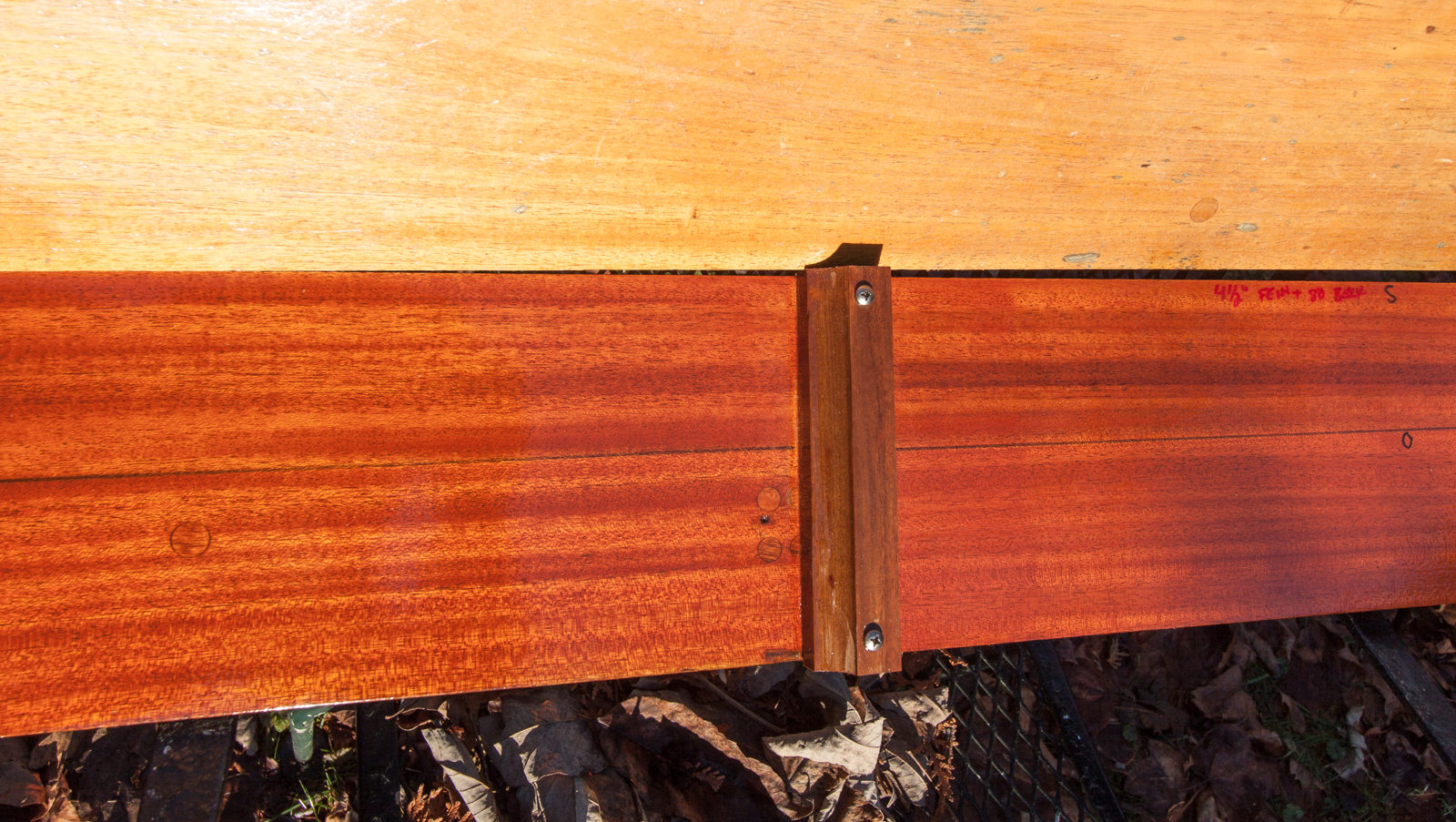

Below is a (then) 50+ year old mahogany plank off my 1961 Alden (cockpit well plank). It's been ripped in half. The lower half was 'wooded', then one coat of filler stain (Interlux Chris Craft red), allowed to dry well, followed by 2-3 coats of Petit wood sealer. Once that was well dry, it got the first sanding (120# to flatten the surface)
This was then followed by 2 or 3 coats or spar varnish (sanding between lightly with 220) rolled and tip applied.

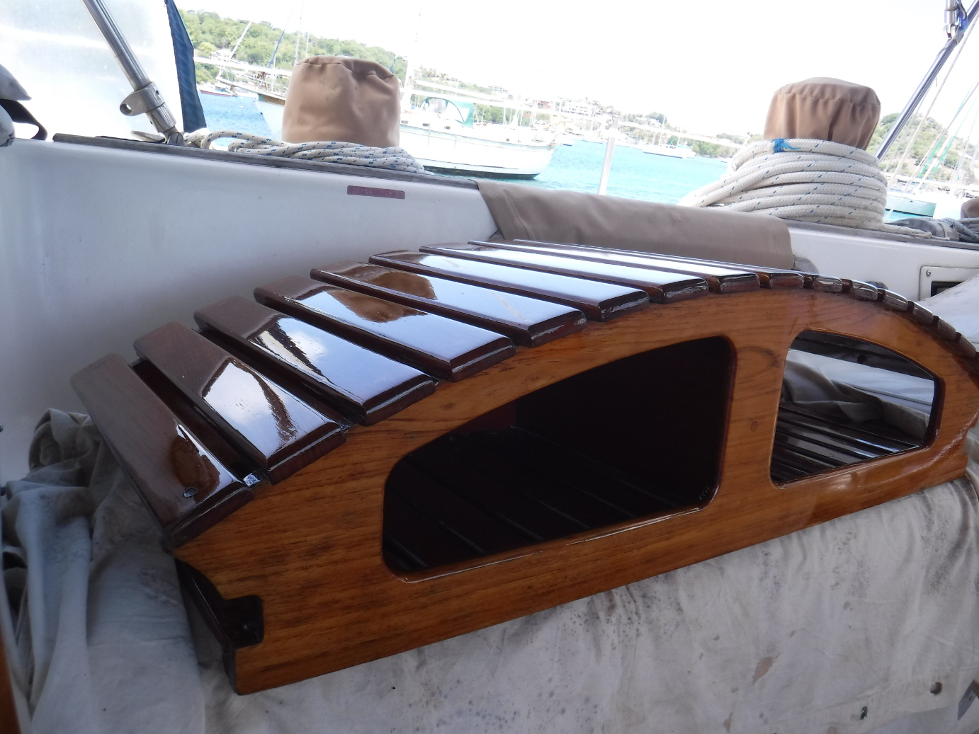

We use Snappy Teak two part to get out all the stains and brighten the teak before finishing. Then, like Tom, we use a clear wood sealer, several coats. Sand between coats if the sealer raises the grain.
Personally, we much prefer Captain's varnish over all others, thinning the first few coats.

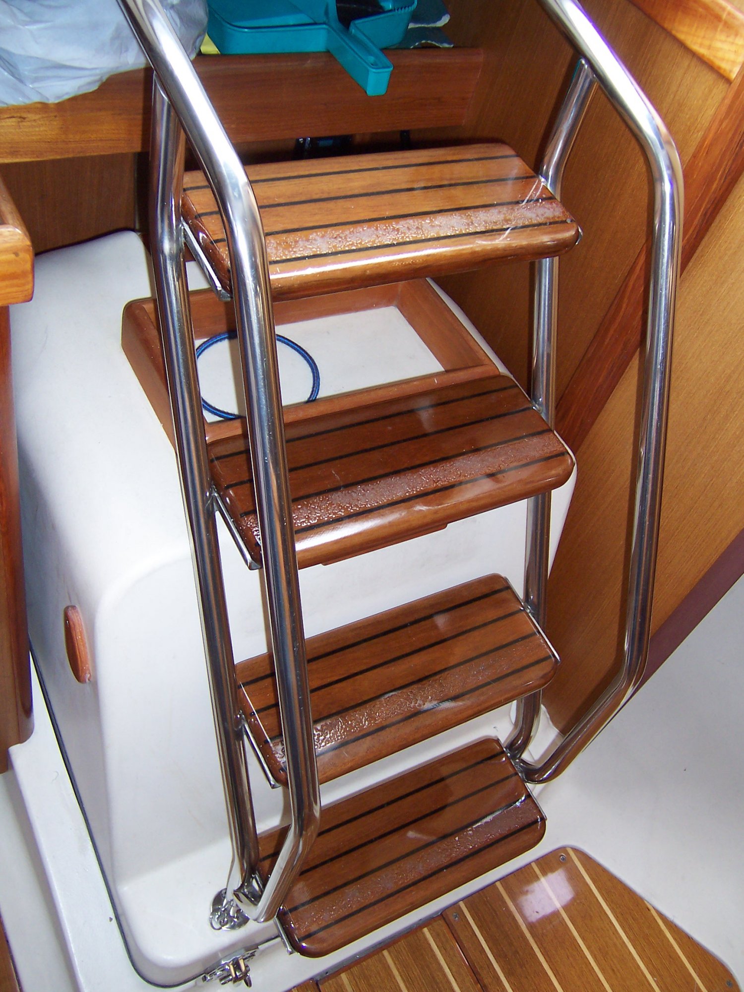

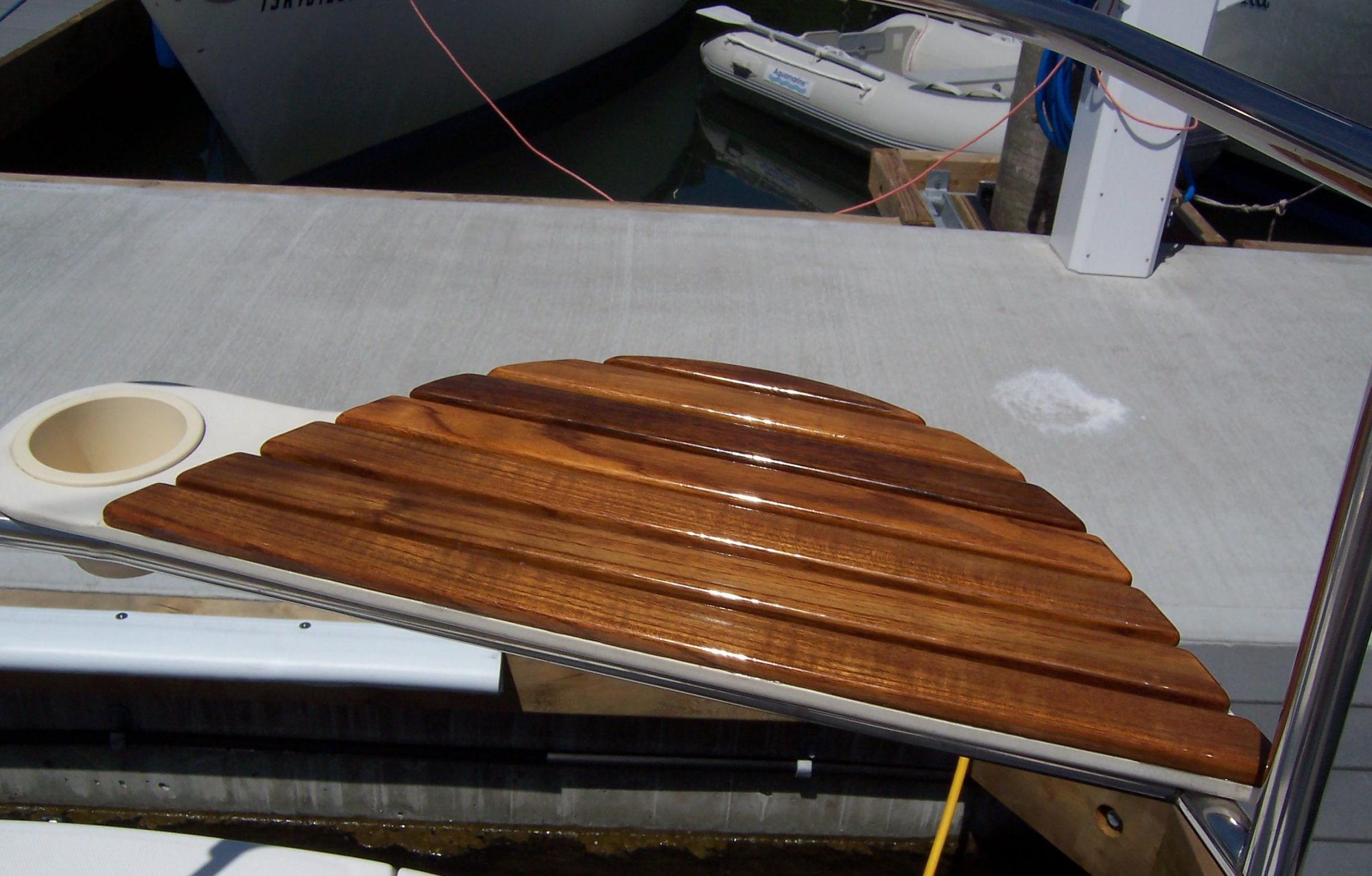

Here's a couple of items which were removed and done in the workshop:
The stairs were done with glass cloth in the epoxy for extra wear resistance. The glass completely disappears as both have the same refractive index.
Epoxy is the best, but only if you can guarantee a 100% seal.
