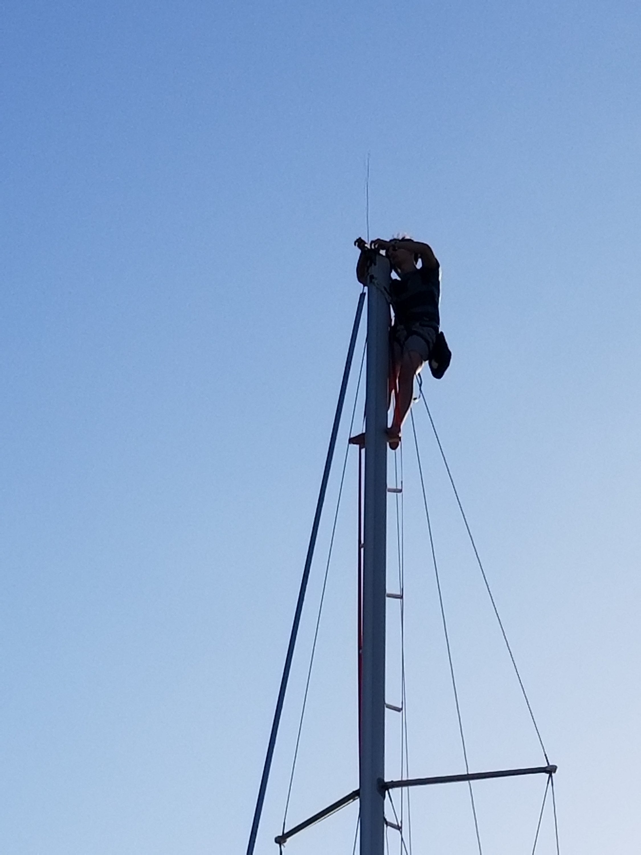

So I sent my son up the mast yesterday to do some work on the masthead light and halyard car for my furler. I had him take some picture while up there, and noticed that my VHF antenna has disintegrated. All of the labels have pealed off, but from his photo it looks like one of the Shakespeare's with the can on the bottom and the stainless whip. All that is left is the can. the whip is gone maybe after the last hurricane here. What would you recommend as an inexpensive replacement? I use my handheld for most things, but want the built in radio to function correctly.

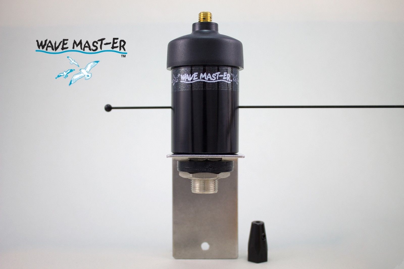

I have a used antenna, I replaced it when I redid the masthead. I moved the windex, which was previously interfering with the antenna. Full disclosure, the whip was bent, but is in good shape
Shakespeare 5215 squatty body. PM me if interested.

I ordered it, and it should arrive this Saturday. If it sucks, I am out only $17, and a trip up the mast.

So I put it up last weekend, and now I think my original Shakespeare was already bad the day we got the boat. This thing works great, and it was easy to install. Even when my old VHF antenna was in one piece, I could not here my closest bridge tender from my dock. Now I am hearing calls from bridge tenders many miles from me.
