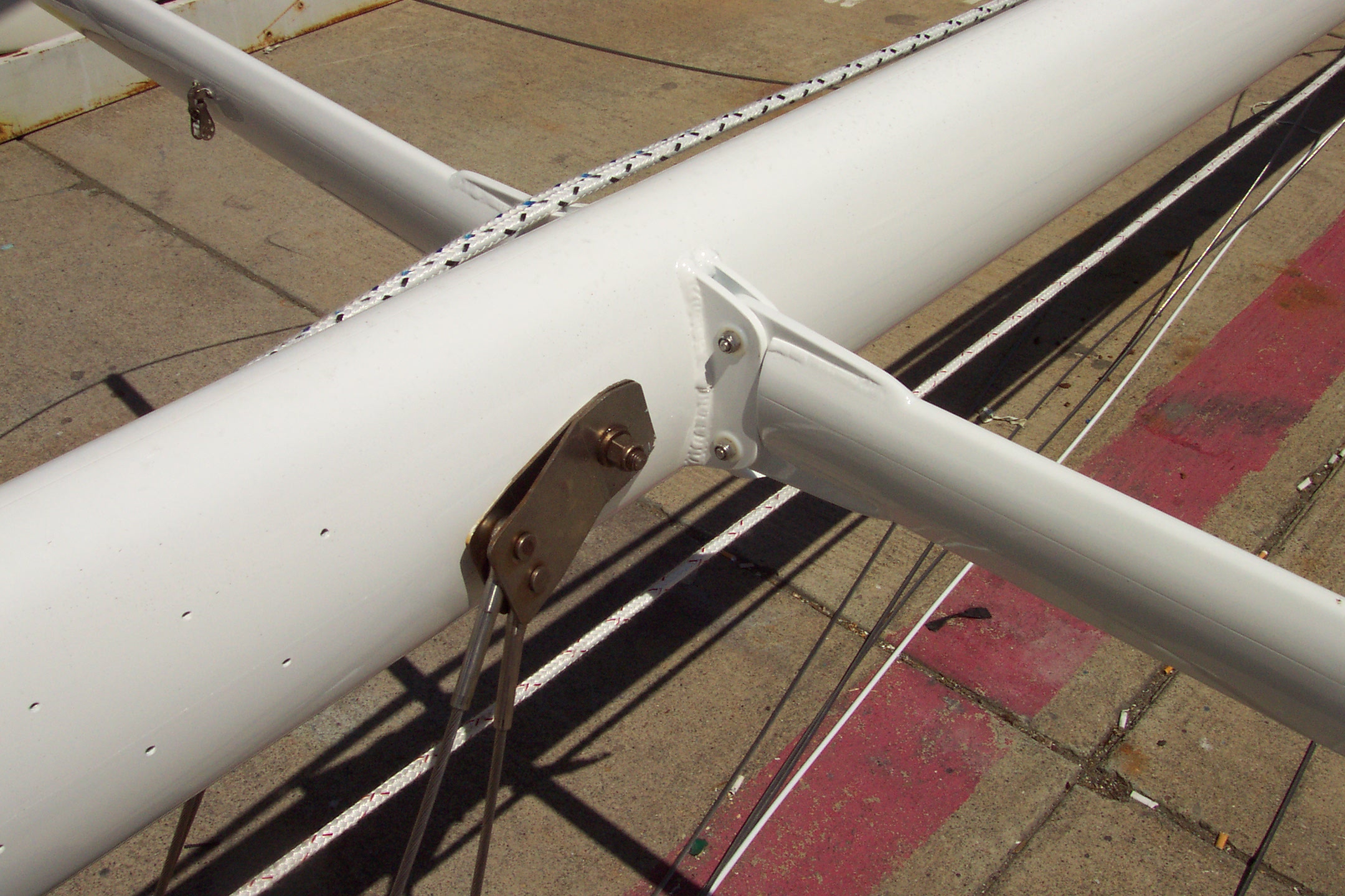

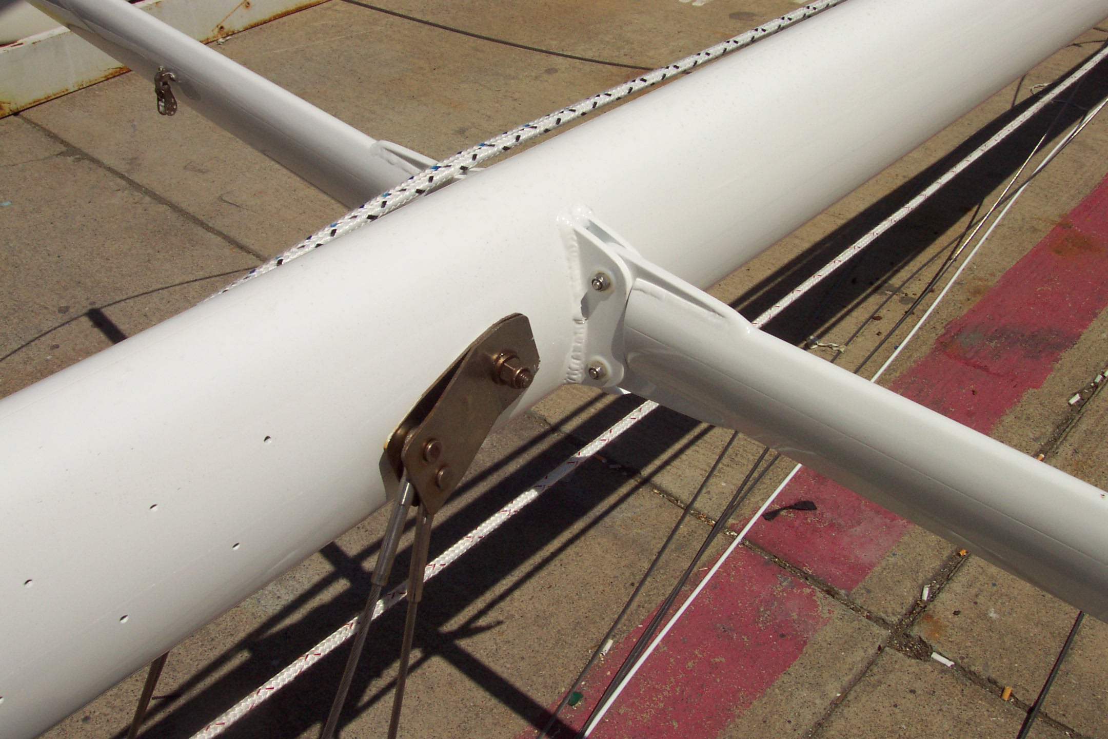

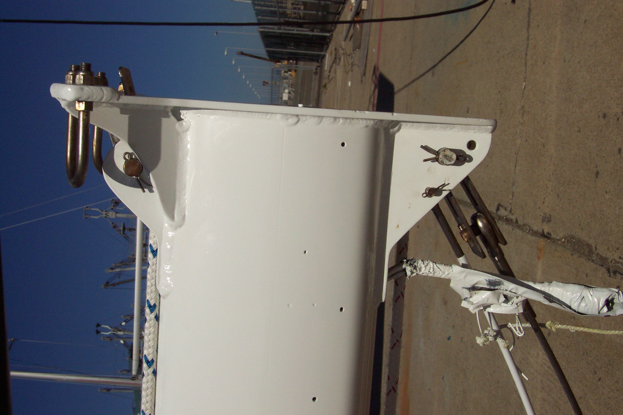

We will be having our mast down for re rigging some time during the next 2 months. I also have pictures from the last time it was down. One thing is that the welds and structure at the mast head, spreaders and halyard winches probably require considerable skill and knowledge to get right.
You are welcome to "private message" me.
