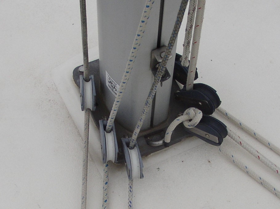

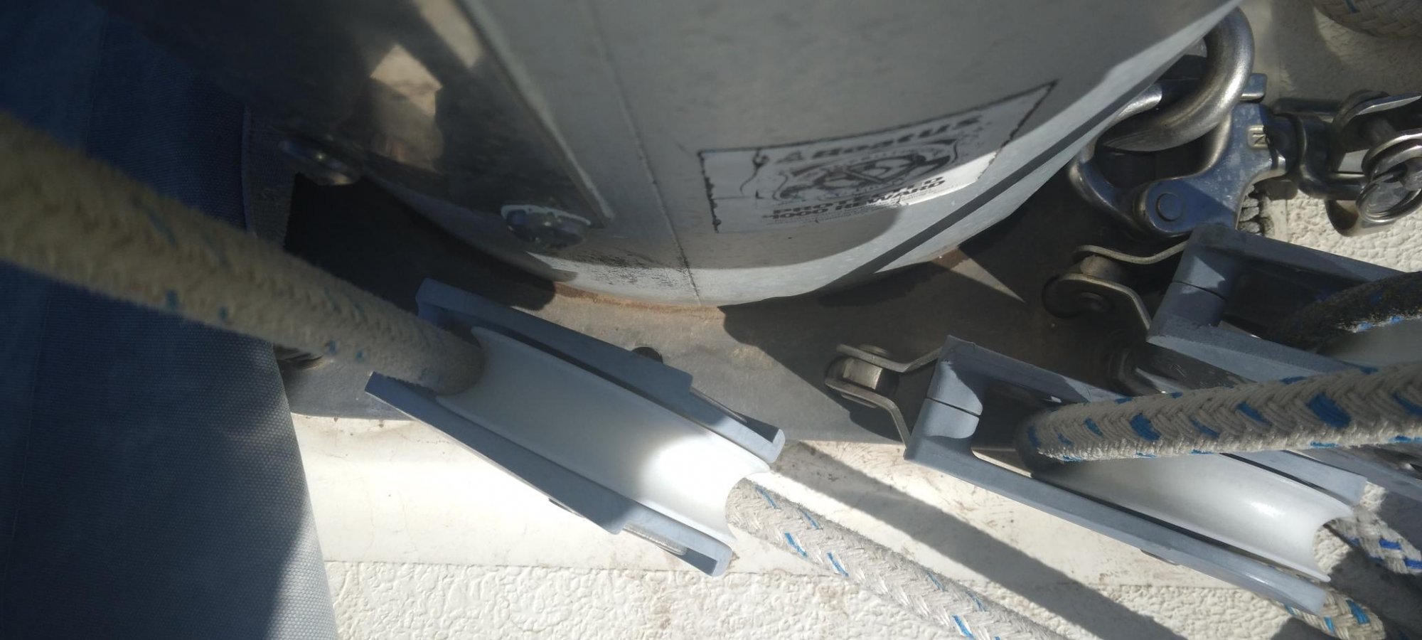

Pictures aren't so great, but I think they work. I'd like to replace one of these single blocks with a double to turn my Dutchman line into the cockpit. I will add a cleat to secure it. It would make the admiral more at ease if I can adjust it from there.
Not sure if you can see it, they screw into the baseplate. I think they are Schaefer. Anyone have a source for a double block? Thanks.

Those look like US Spars blocks, why a double to lead to the Dutchman line?
Jul 7, 2004
8,542
Hunter 30T Cheney, KS
Those look like US Spars blocks, why a double to lead to the Dutchman block?
Right now the line is cleated on the mast, but I have enough line to run it aft. The main reason for so much line is so I can lower it enough to get at the upper filament clamps when I remove the sail for the winter.
All of the tapped holes on the base are occupied. I figure, just double up on one.

I would suggest you use two single blocks as it would be most difficult to fairlead two different lines through one block.
Jul 7, 2004
8,542
good point. I just need to figure out how to piggyback onto a full baseplate. Worse case I attach it to the mast above the existing blocks. But then it could be a trip hazard

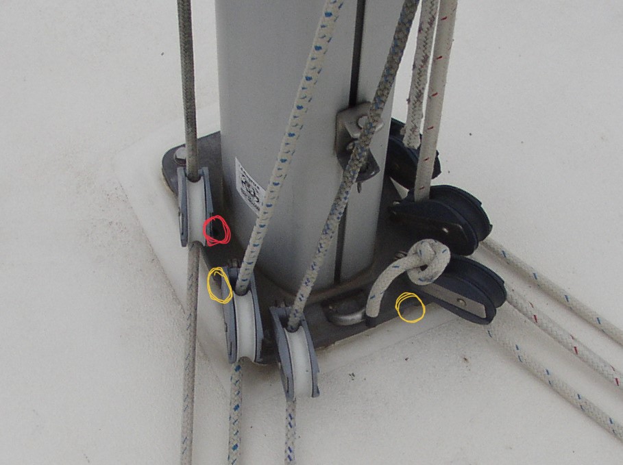

Grey ones look like zspar blocks - a nut mounts on the underside of the mast step. From your pics it looks like you should have at least one open slot on the port side I suspect one on the starboard side as well - but not clear from pic. (Small Hole in mast step between block closest to bow and the next one aft)
(Not sure which size you have.)

Z spar and US Spars are one in the same.
Look to see if there are additional holes in the mast base. If so, order the single block as a double would interfere with the singles
call Dave in sales at U S Spars. He has been around a long time and knows his stuff

Thanks for the input. There are no more holes available, that’s why I am looking to double up on one. Wouldn't be much of a load tensioning the filament lines. I'll look this weekend but I'm pretty sure these thread into the base.

When you’re there this weekend have a close look at the following areas. Red circle appears to be a position for a block. It may be filled with debris, but would be right positionally from your other blocks. The yellow circled areas indicate where the captured nut slides in under the mast step for the block stud to screw into.
It did take me some time to figure out how the system worked on our 260. It has positions for 8 blocks - the same as your grey blocks. Can’t imagine a 30 having less positions than a 260!

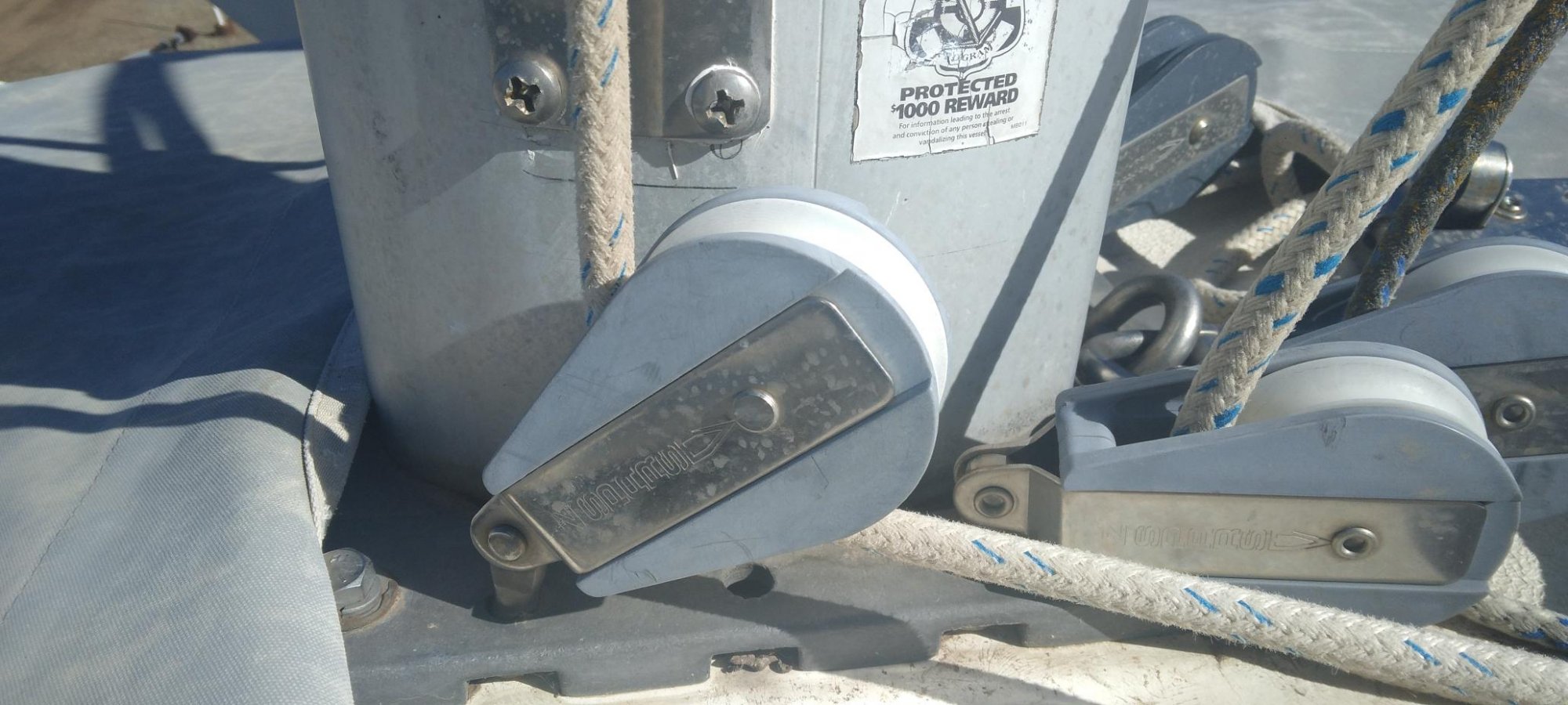

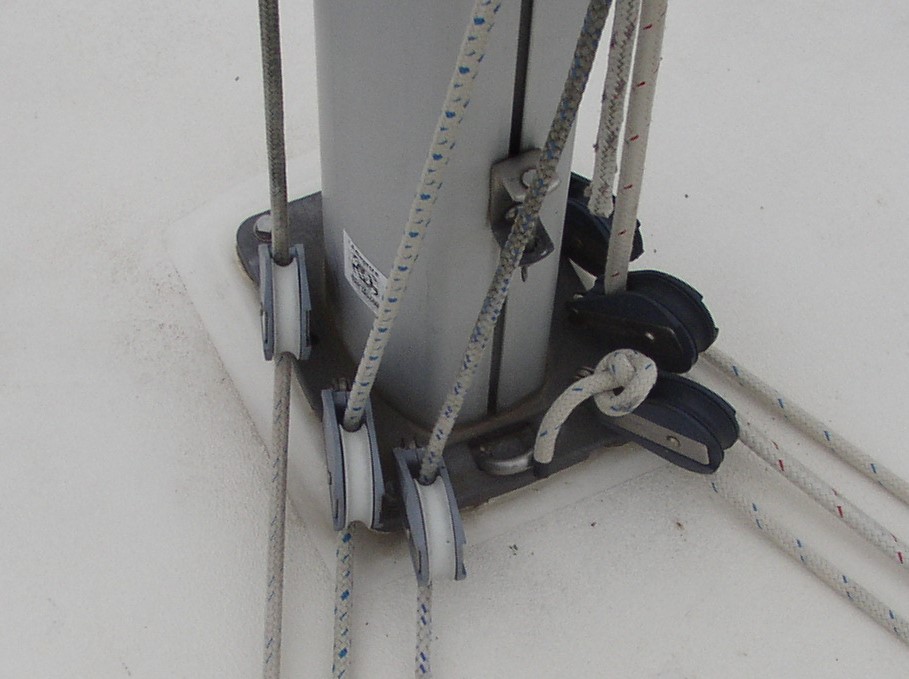

Justin: Here is a close up of my mast base - A Z-Spars (US Spars) mast. Note the slot cutout. The bolt on the block goes through the hole in the base (not threaded) and the slot is where the nut slips into and becomes a captured nut.

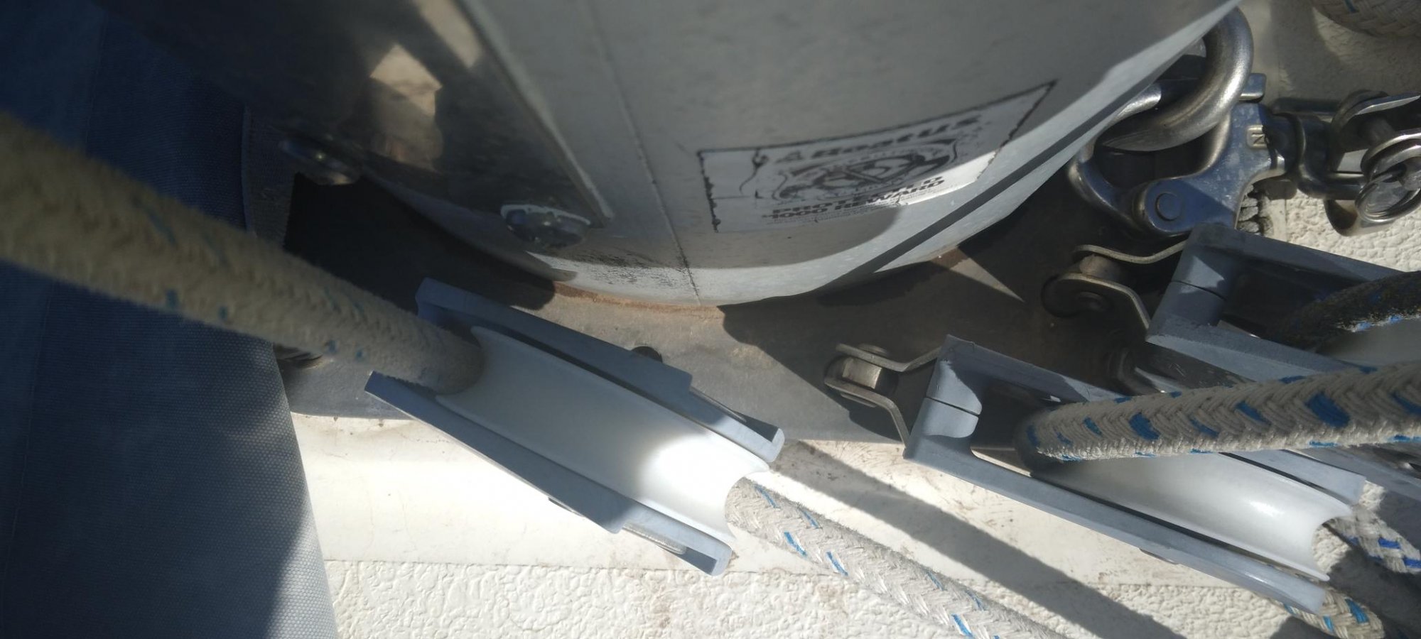

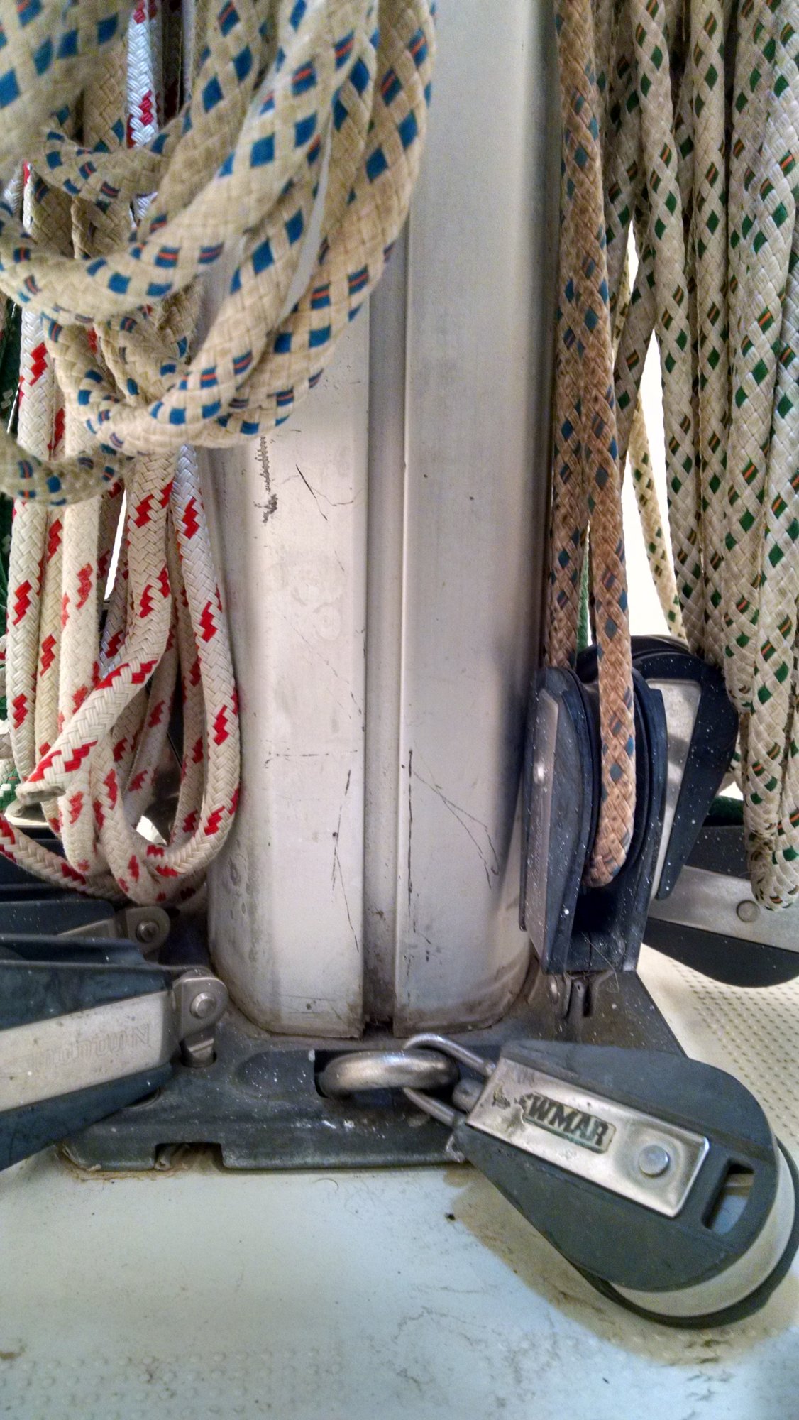

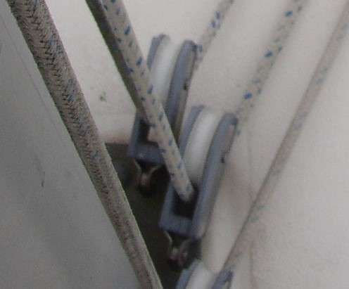

I went out today and checked. They look just like JRacer shows. Here are a couple pics I took. I even have two positions left. One on either side. All of them are ZSpars. About 2.25".

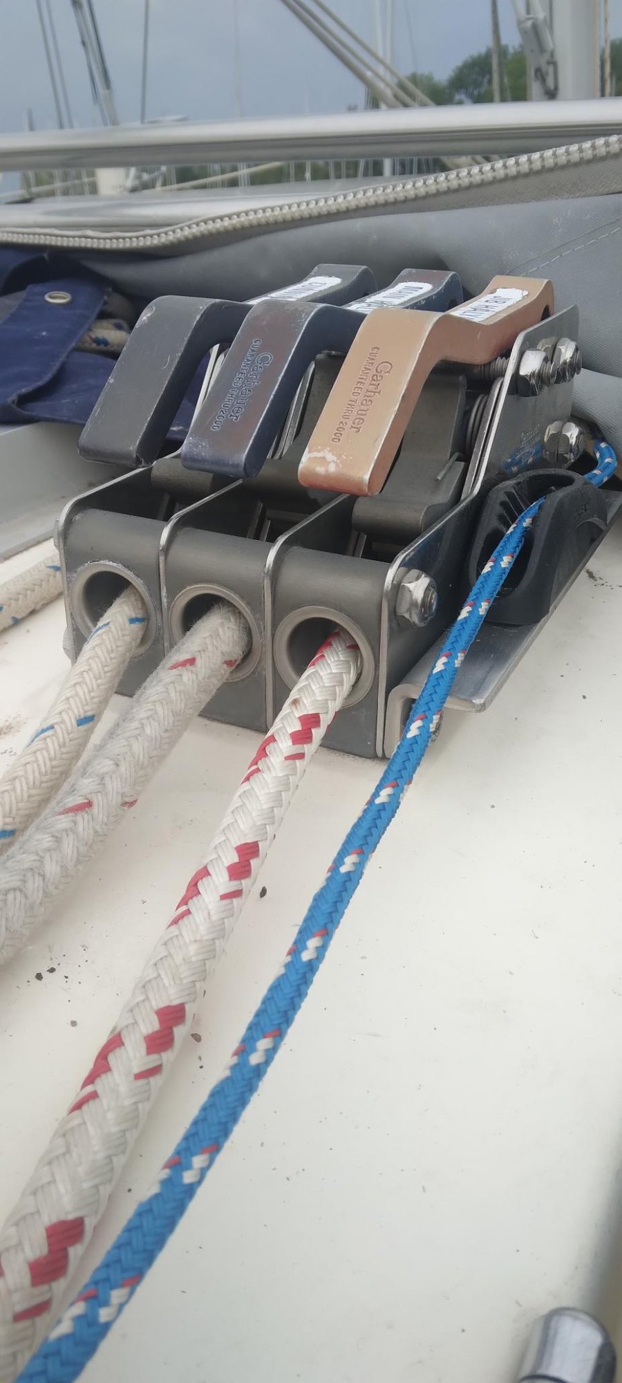

Dutchman line project complete: I used the new mast base turning block lead my line back to the cockpit. Next I mounted a V-Cleat onto my cabin top clutch assembly. Now I can operate the Dutchman without going to the mast. The angle piece is stainless steel. Had to get 2 longer bolts to mount it to the clutch assembly.
